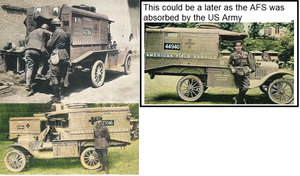

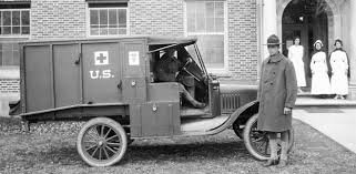

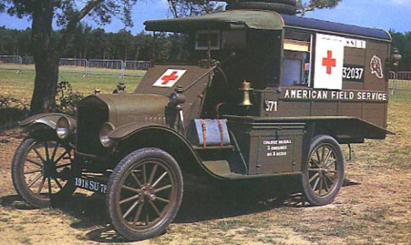

Did a bit of research. First: for the US there appears to be ambulances belonging to the" "American Field Service", "Red Cross" and "Ambulance Service" (aka "United States Army Ambulance Service)". In attempting to colorize several WW1 photos I don't feel that any were the olive drab that we visualize as a WWII color. Also the colors of these vehicles may have been different based on the organization that belonged to.
https://www.worldwar1centennial.org/ind ... rvice.html
The American Field Service (AFS) was a volunteer ambulance and camion corps serving with the French Army during World War I. AFS ceased to exist as an independent entity and was absorbed by the United States military when the United States entered the war in 1917.
The vehicle color appears to similar to others of the period that is more brown than green

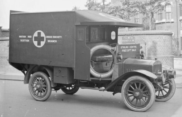

"RED Cross" images of Red Cross vehicles in WW1 may be mostly of the "British Red Cross" since the "American Red Cross" did not get involved until 1917: when the US declared war on Germany in 16 April 1917 and WWI ended 11 November 1918
British Red Cross vehicle
British red cross 2.jpg (36.77 KiB) Viewed 2316 times

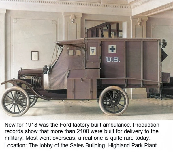

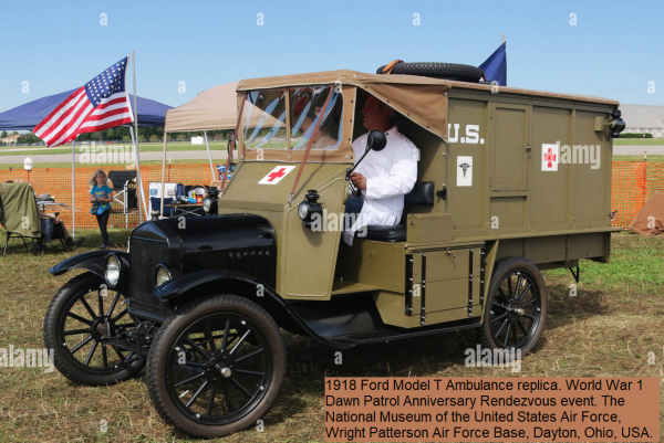

two more photos
The correct painting depends on which organization & year is to be replicated. This a US Army version after which the color standard was adopted in 1918 (see above). It is not the same color for an "American Field Service" ambulance nor the WWII & beyond Olive Drab

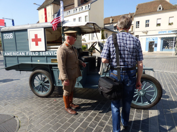

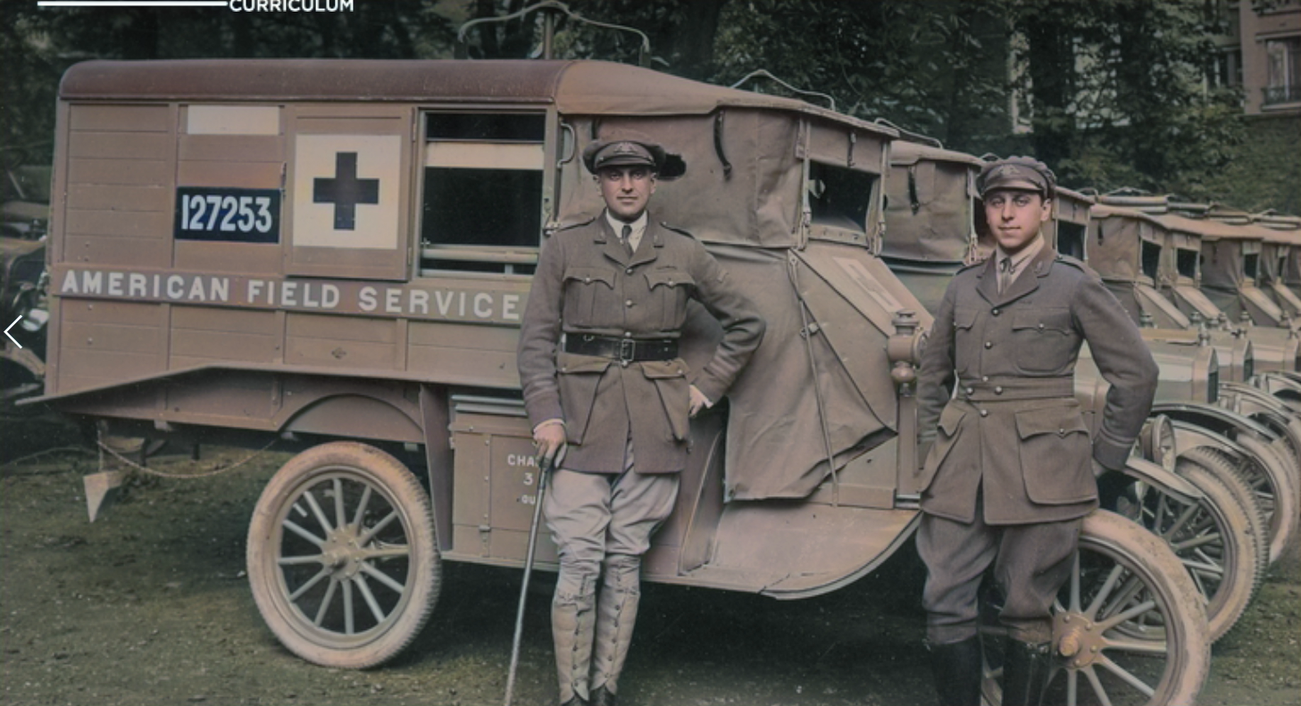

A couple years ago i did some extensive research into WW1 Ford ambulances, pertinent to your plan on colors;
The ambulances of the AFS were painted a light(ish) blue, as that was the standard colour of the French Armee, under which command it operated, there is only one original car left, it resides in France in the AFS museum near Paris.
Most of the AFS ambulances were later fitted with Goodyear demountable rims, as Ford did not yet produce demountables then, the Goodyears can be identified by having 5 lugs

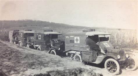

The Standardised US Army Ford ambulances of the 1917 model were painted a rather light olive drab
images (4).jpeg (14.26 KiB) Viewed 2150 times
In answer to your question : no bright finish or surface was allowed, so yes all rims were painted body color.
