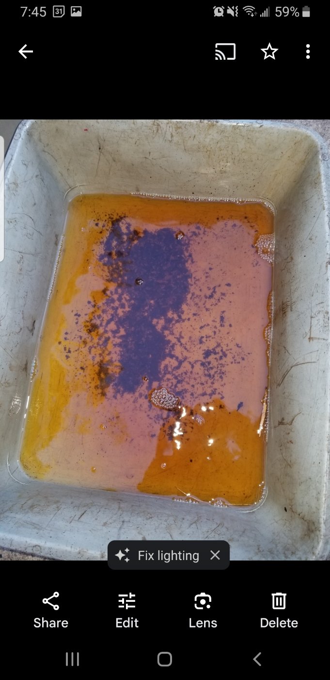

I figured it out and then the fun began. Initially, I added a quart of acetone while the tank was still in the car. It was a pain in the butt trying not to spill on the paint which I asked about pulling it out. When I drained the acetone it was the color of stout beer. I added some gas to rinse. Yuck.
Pulled out the carpets, floor boards, seat and the tank.
3/4 gallon of acetone in, shook, rotated drained. Then gas, then acetone, then gas. Probably 6 times. Then I washed it out with soap and water, flushed for about 20 minutes.

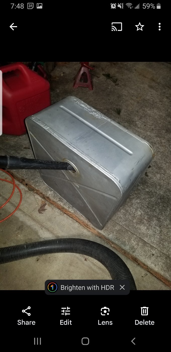

Pit Vacuum hose on the blow port and into the tank to air dry for a half hour.
It's now sitting on a space heater to thoroughly dry it. I'll heat it up overnight.

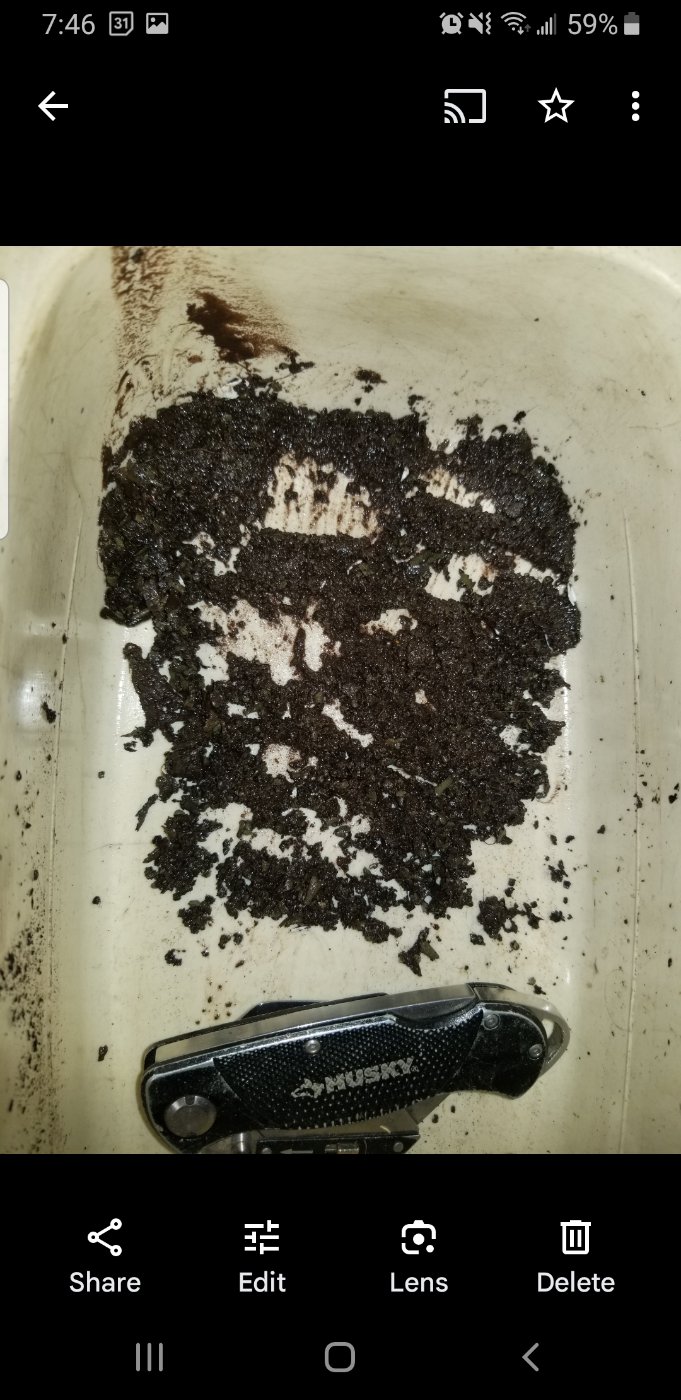

Seems so much cleaner and no more gunk or particles coming out.
