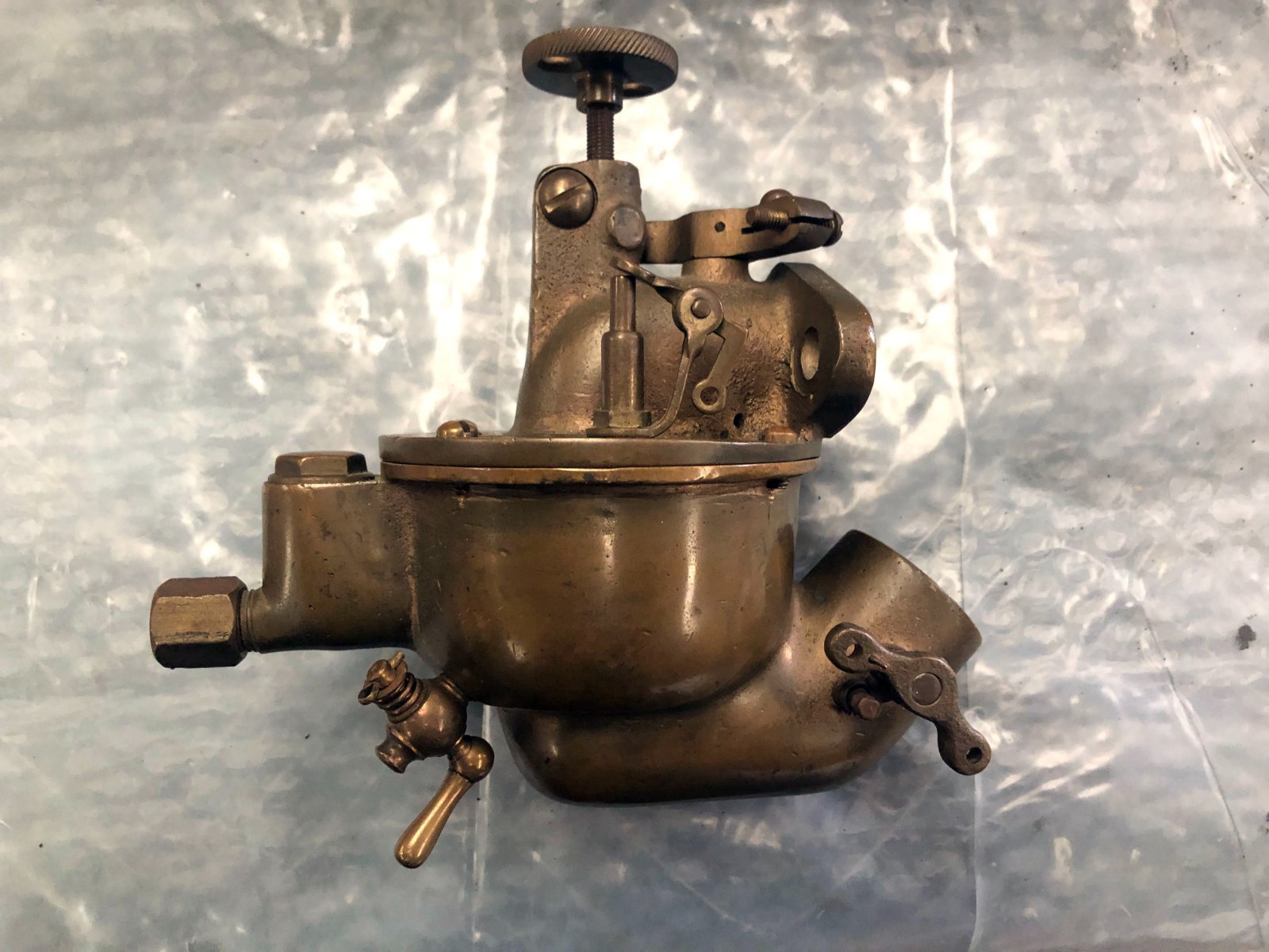

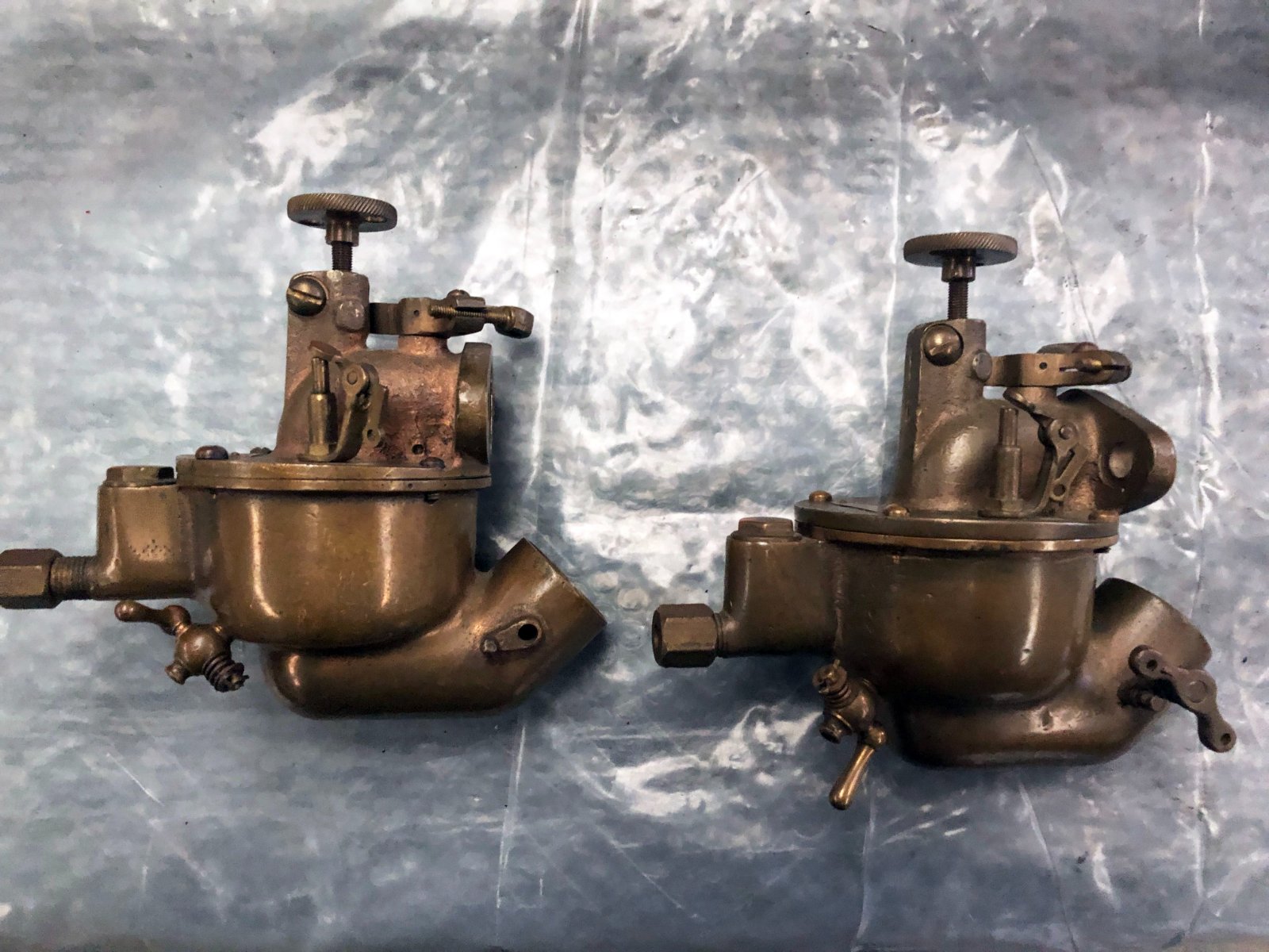

I am restoring a 1912 Runabout and happen to have two of the rare Kingston 6 Ball carbs. One is complete with a new float, the other is needing a new choke valve shaft and a new float to replace the old cork one. (I will be in search for someone who works on these old carbs-Russ Potter doesn't mess with them anymore, or so he tells me.) My question is, has anyone got any experience running this carb? I will try it at some point myself but thought I would toss this question out there. Also, does this carb use a stove (hot air pipe) like the older Kingstons and most Model T carbs?
I read in McCalley's book that this carb was eliminated early on the 1912 Model T and replaced with the Holley H-1. I am sure the H-1 was cheaper for Ford, as the Kingston appears far more complicated than the Holley H-1.
Anyway, your thoughts are welcome!

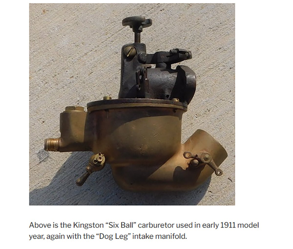

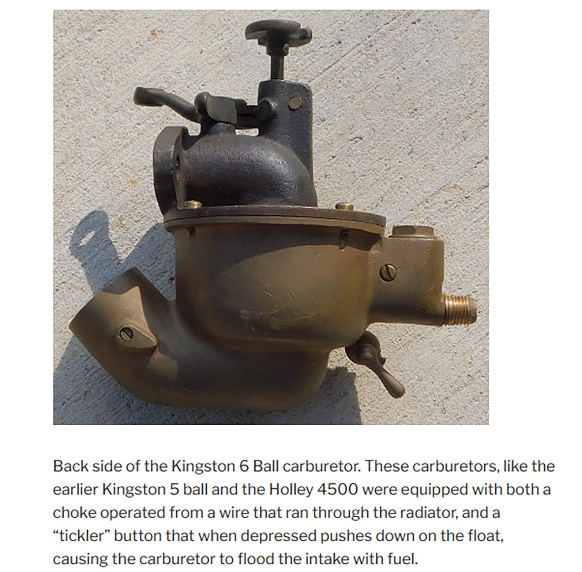

This may answer some questions about the 6-ball:
https://www.bing.com/ck/a?!&&p=110fb28c ... AzNQ&ntb=1
and this from Ford Fix;
