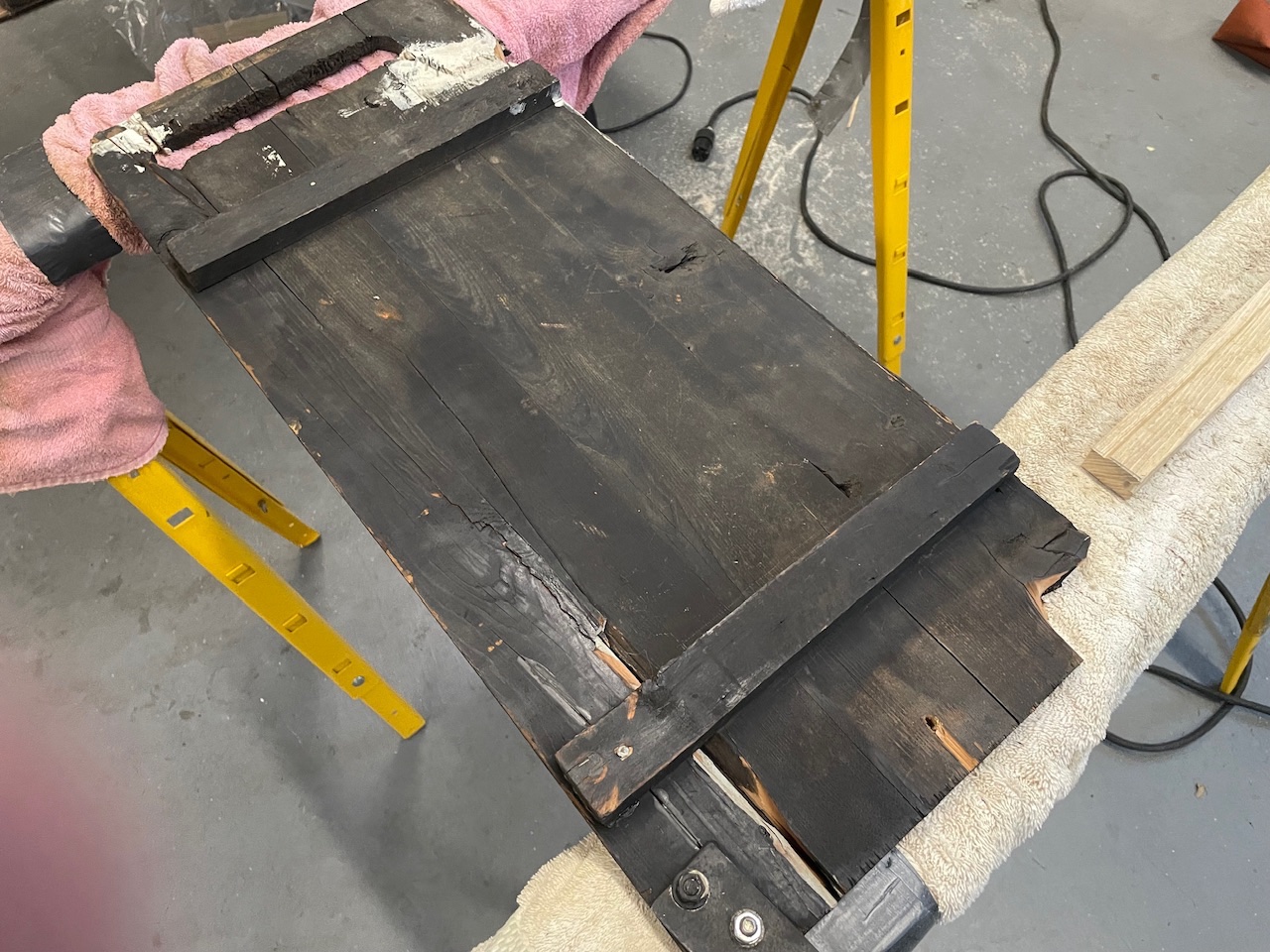

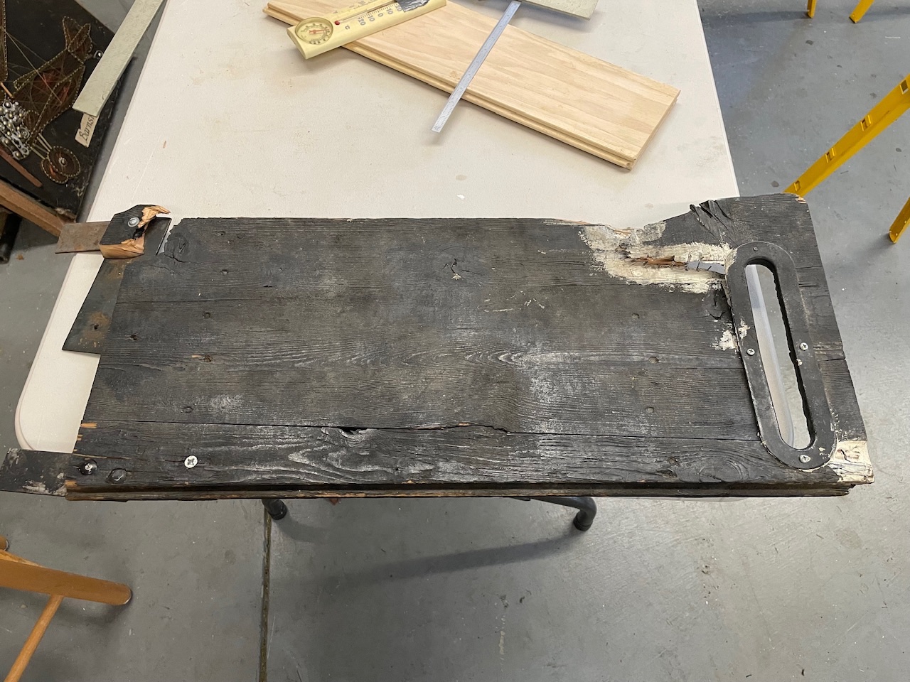

I have no idea if the floorboards in my ‘24 touring are original or replacements, but a shade tree modification to access a makeshift fuel valve, and the failure of a previous repair, both by previous owner(s), has necessitated replacement of the flat section just forward of the front seat. I have some leftover 3/4” solid hickory tongue and groove flooring so I decided to try my hand at using it to replace that floorboard. I figure that if hickory is strong enough for spokes it should be strong enough for a floorboard.

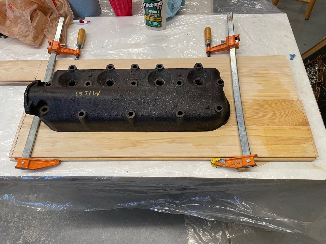

So far I’ve glued four 3-1/4” wide strips together to make a 30” x 13” blank. My only woodworking tool is a skillsaw, but I have a neighbor with a fully equipped shop who I’ll get to plane it down to the 9/16” thickness of the other floorboards, cut it to size, and rabbet the front edge to mesh with next board forward.
More updates to follow as I progress.
The only thing keeping this floorboard in the car was the transmission.
The boards wanted to buckle under pressure from the clamps, but this cast iron head was the right amount of weight to make it lay flat while the glue sets. I’ll add hardwood cleats to the underside once it’s been planed to thickness and trimmed to size.

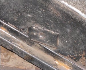

I can’t find my camera but I found several pictures online of the 1926/‘27 floorboard hold downs. There is one on each side at the edge of the floorboard that, when turned, one edge goes over the edge of the floorboard and holds it down and keeps it from coming up from the wind blowing underneath. Jim Patrick

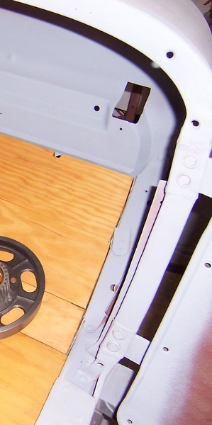

My 26 coupe has the clamps holding down
the angled horizontal portion of the floor under pedals that rests on the side body gussetts. ..one on either side. Had to make my own since mine were missing..
used holes already on the gussett where original ones were. Simple project. There are none the the flat portion of the floor

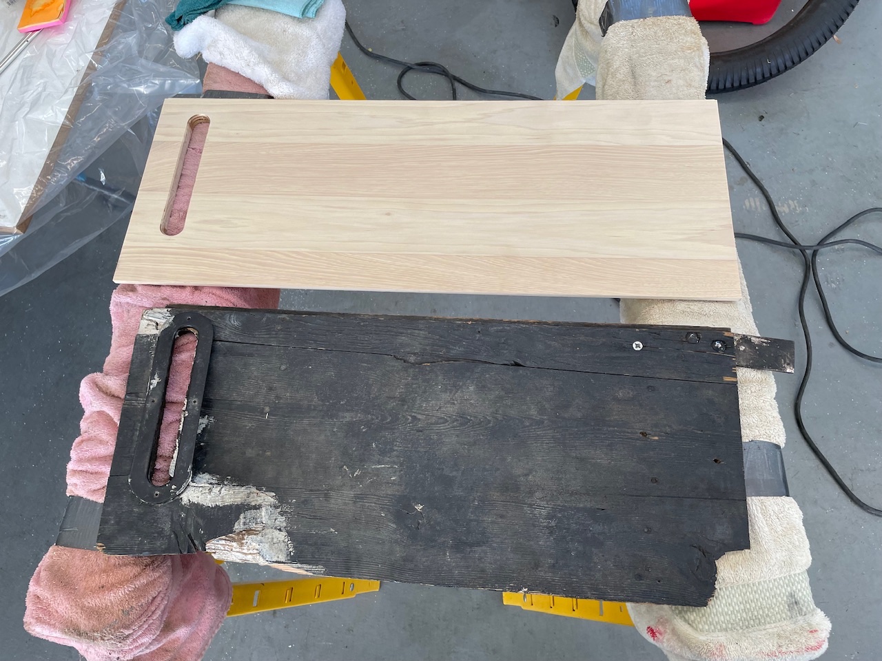

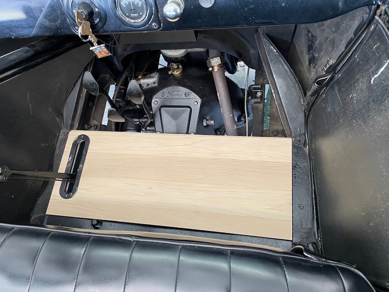

Post by mbowen » Thu Feb 08, 2024 9:47 pm
My and my neighbor’s schedules finally meshed today and got Bonnie’s floorboard squared up, cut to size, planed to thickness, rabbetted, and the slot cut for the brake handle. I’m very pleased with the quality of his work; he went at it as though it was his own. He even put a slight chamfer on the brake slot so the trim ring would lay flat. It looks so good that I’m having a little trouble resisting the urge to replace the rest of them…
Quite an improvement over the old one.
Fits well with a little room for swelling. Looks too good to paint; I think I’ll try a few coats of clear polyurethane.

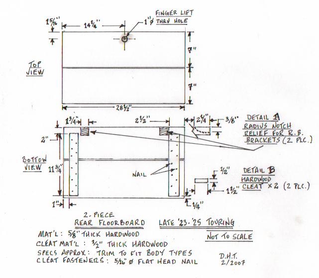

Did the floorboards (‘24 touring) originally have cleats on the bottom, or are these part of a repair?
Miles
1924 Touring “Bonnie”
1925 Express Wagon “Clyde”
Posts: 4472
Re: Hickory Floorboard
Post by Jerry VanOoteghem » Sat Feb 17, 2024 5:50 pm
Miles,
My '25 Touring has them. I don't know if they're original, but they sure have been there a very long time.
Posts: 4084
Post by DanTreace » Sat Feb 17, 2024 7:30 pm

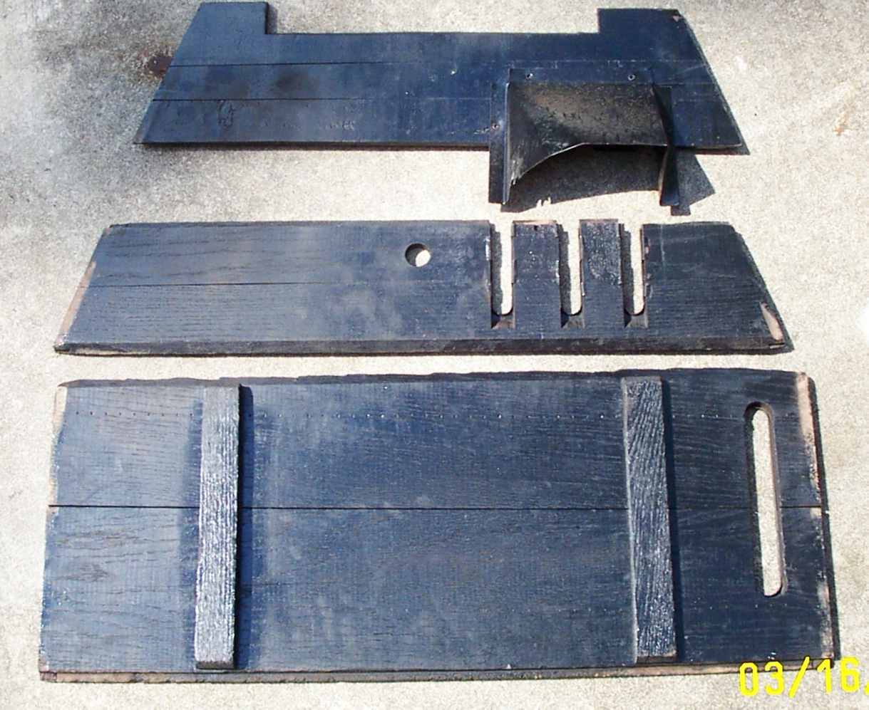

mbowen wrote:
Sat Feb 17, 2024 5:37 pm
Yes. Cleats on the large boards is factory, keeps the boards secure and adds support strength.
These are original boards from my '24 touring.
And this is sketch I made of the rear floorboard for the '24 touring, from the original.
