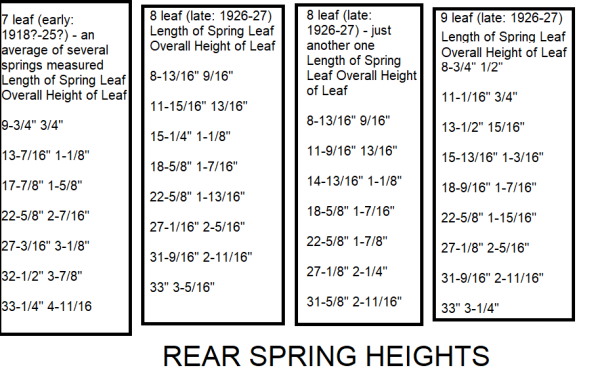

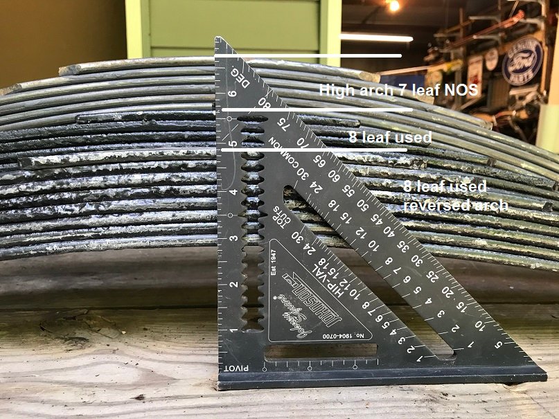

- Posts: 6577
Re: Difference in overall wheel/tire height between 30x3 and 1`"
You defined your chassis etc: I am starting with a 27 Depot Hack chassis and that is what I am converting to a 1917 T ambulance. But, it will always be a T salad. Just trying to represent the species with this project. So, yes, 27 fenders and running boards, radiator and hood and yes, 21" wheels to go over the 11" rear brakes. And, yes, it wil have a starter.signsup wrote: ↑Wed Feb 07, 2024 10:40 amSo, thread on trailering and enclosed trailer doors and garage doors got me pondering about vehicle height. My WWI ambulance project calls for an overall height of 81". But, that is based on a 1917 chassis with 30x3 wheels and tires, but I am using a later chassis with 21" demountables. Is there a height difference,and, if so, does anyone have some measurements as to the overall height difference between an inflated 30" tire and wheel and a 21" inflated fire and wheel. Surely it is not 9".
Thanks in advance.
There is always a question if your starting with an unmodified 27 Depot Hack chassis
-Spring height will affect height as well (do they each have 9 leaves)
I don't have an 9 leaves for comparison but old vs new makes a difference. Picture is to give you an idea of differences. Also you overall body weight will affect height.
Unofficial Measurements
FRONT Springs --
REAR Springs --
1926-27 Front spindles - lower height about 1/2 inch
