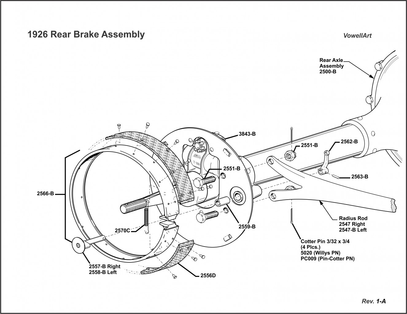

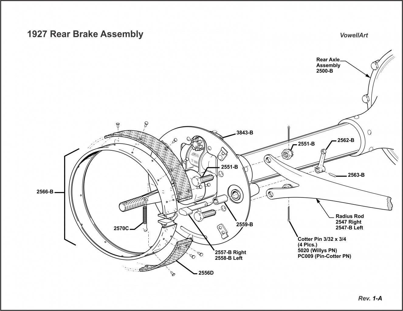

Is the spring, 2570C, installed? It holds the two halves tight against the cam, away from the drum. Jim Patrick
PS. Although my coupe was built in March, 1926, The brakes are like the 1927 drawing. With the 4 retainer clips that hold the brake lining against the plate. My clips were worn off and I had to get 4 new ones and rivet them on the plate.

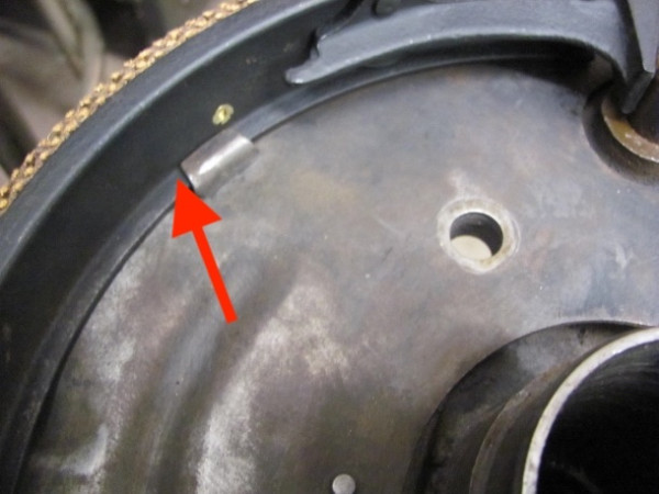

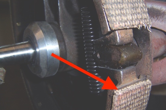

Sometimes the leading edge of the lining needs to be tapered, by grinding off some, if it stands up too much.
And be sure the shoe edge is tucked under the 4 retaining tabs to keep it close to the backing plate.
