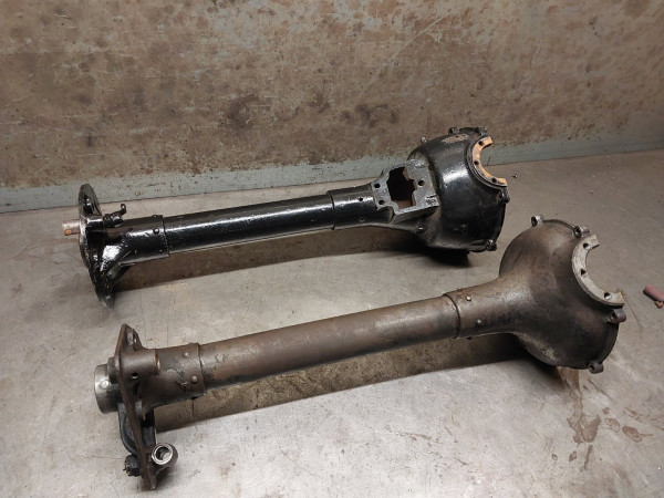

I have a small drum axle half with a Ruckstell housing where the axle tube is very badly bent.
Now I plan to remove the Ruckstell housing and use it to convert a large rear drum.

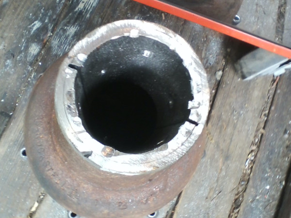

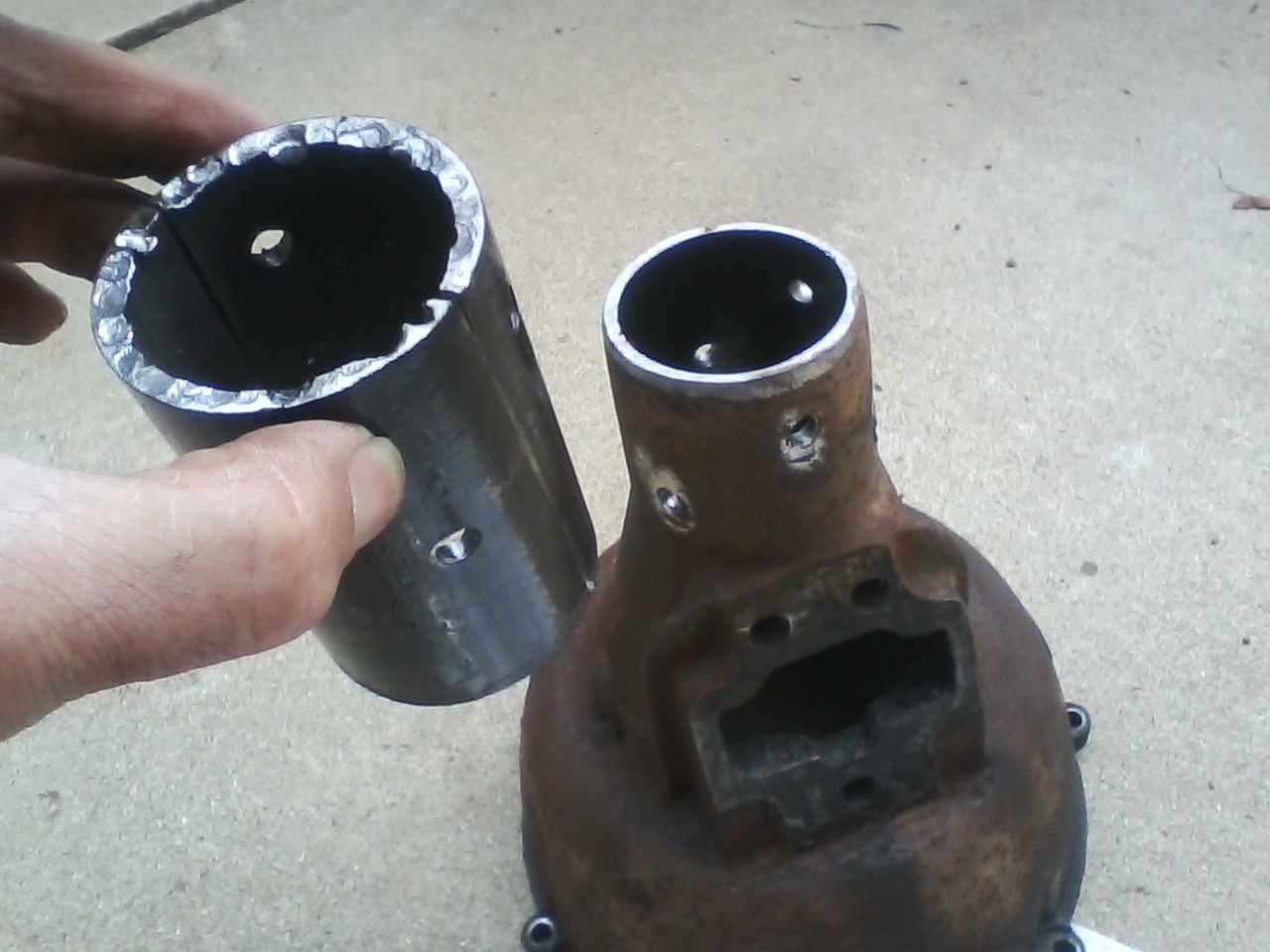

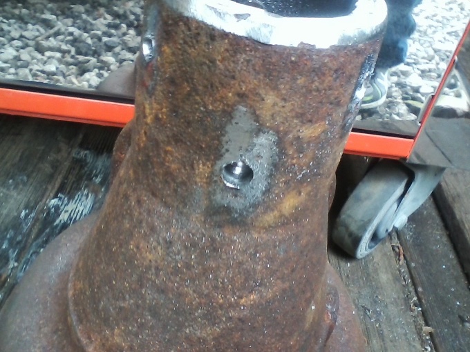

A friend a few years ago sent me these photos that may help you.
He did the same, removed the axle tube from the Ruckstell housing, by cutting off the tube, then drilled out rivets, then put saw cuts down into the axle tube with a SawsAll, to help collapse it, then beat the remains of the stub axle tube out of the Ruckstell housing.

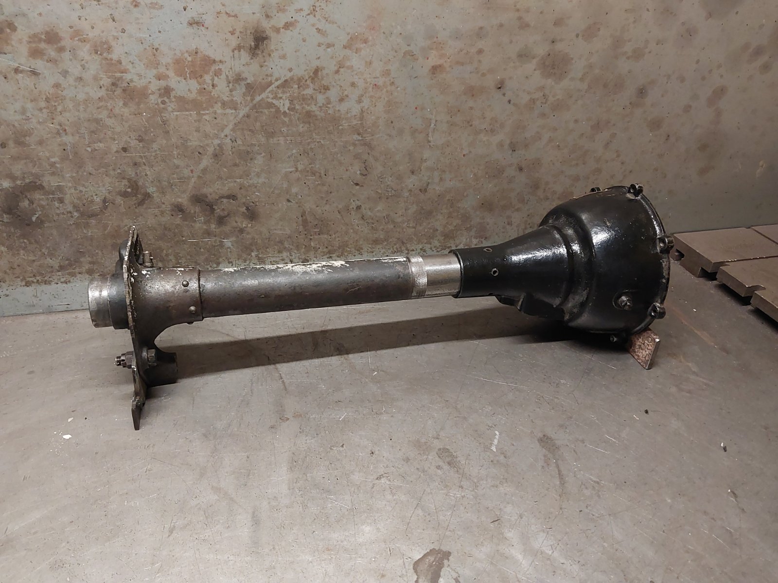

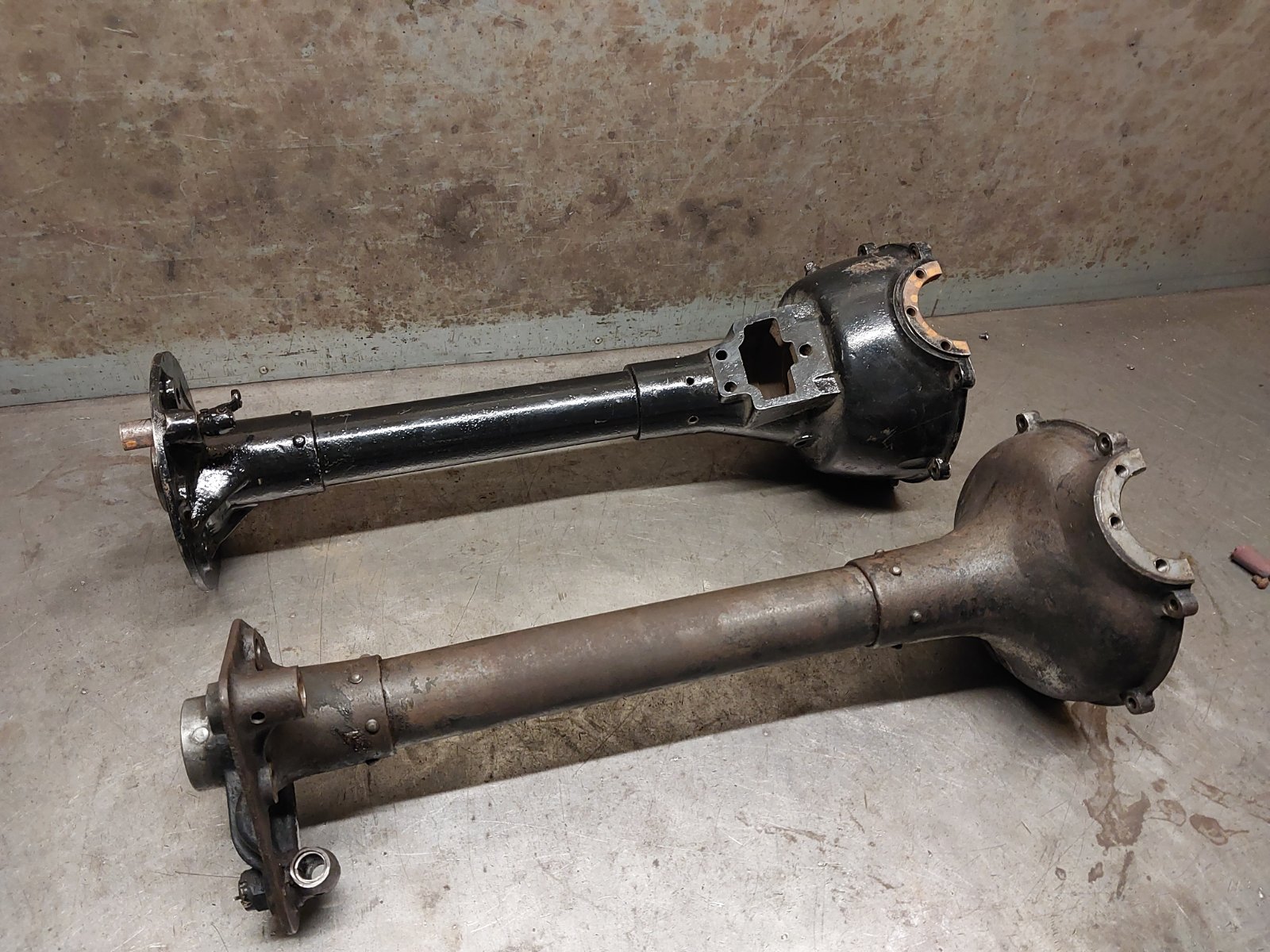

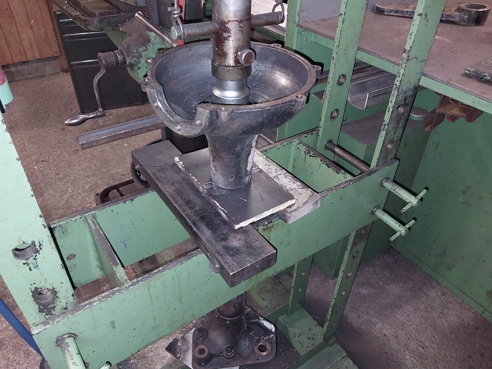

I worked on my Ruckstell axle again today. First press out both pipes on the housings. That went without a problem.
I made a split plate with a hole and welded it together to press it out.

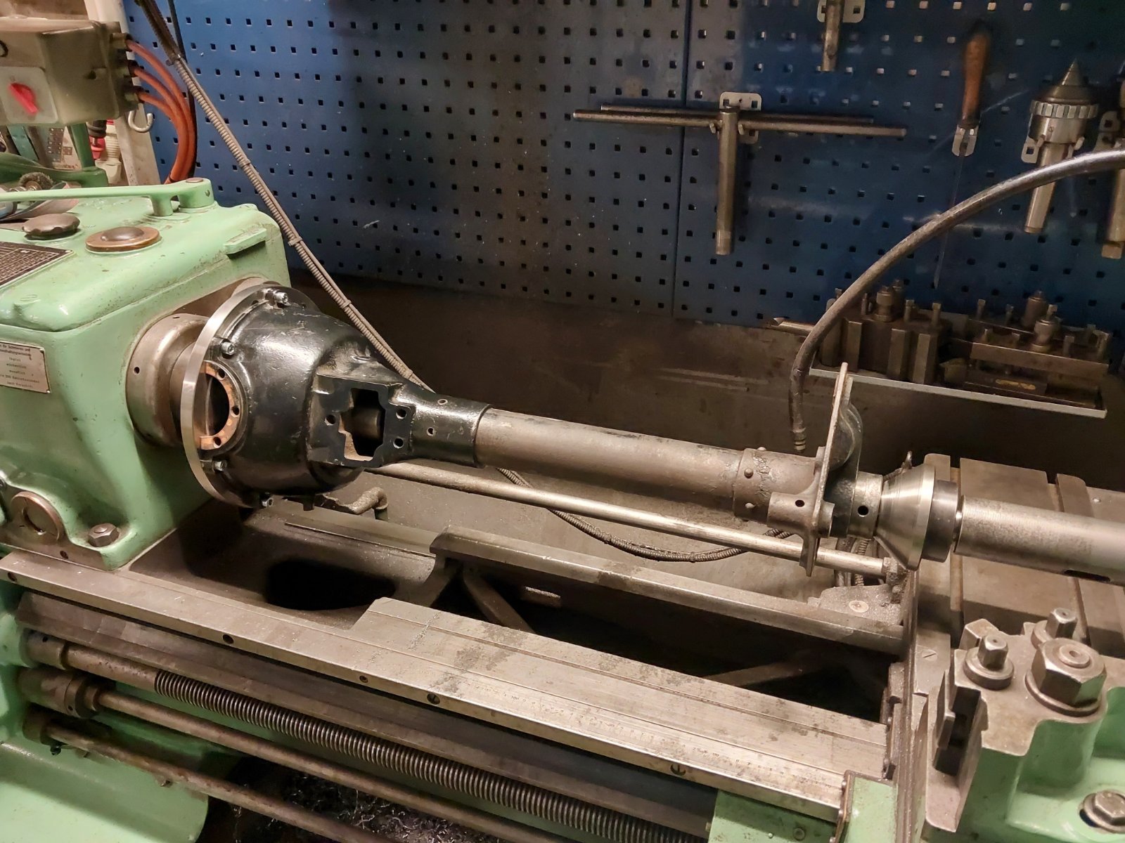

To align it, I attached a plate to the housing and the outside, which gave me the alignment specifications when I put it together on the workbench.

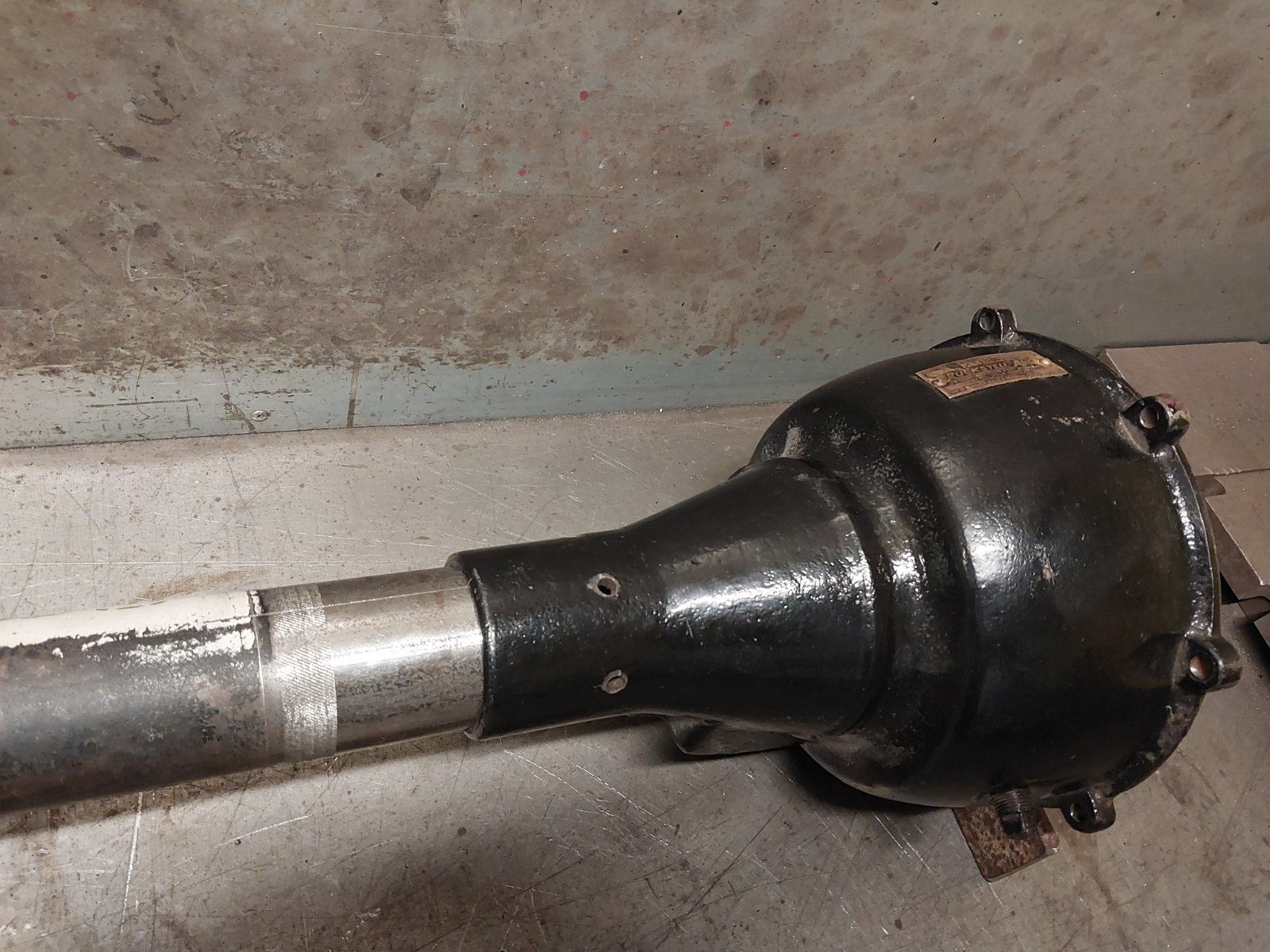

Then pressed in under the press with some Loctite. The fit was very tight.
Finally checked for straightness in the lathe. The outside is approximately 0.15 inches from the center. I just have to adjust it with a little heat and then everything will be perfect.
