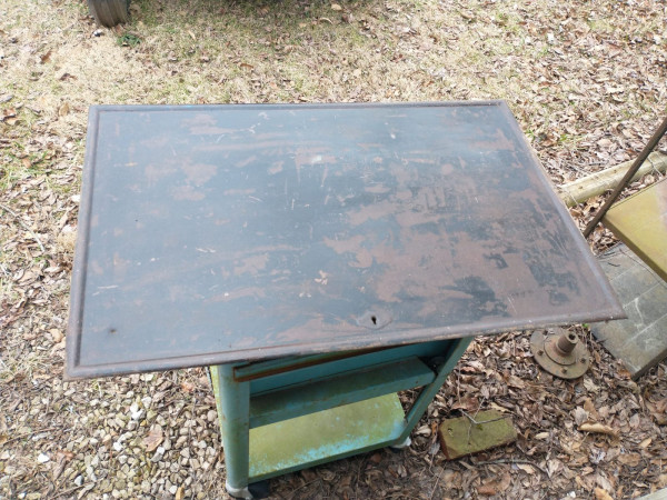

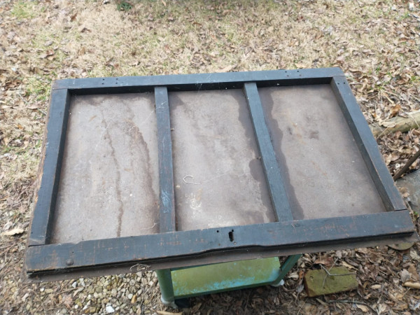

Trying to figure out if this a model T deck lid.
Measuring the top from outside edges it is 32-1/2 L x 21-1/4 W.
I'm not sure how many different sizes were used with model T's.
Thanks,
Clay

I think that’s a deck lid for the 17-22 Coupes. The later 23-25 Coupes lid was a little smaller. In other words the Coupes with the doors opening from the front have the larger deck lids.

A member was so kind to measure his 19 coupe and it matched this deck lid.
