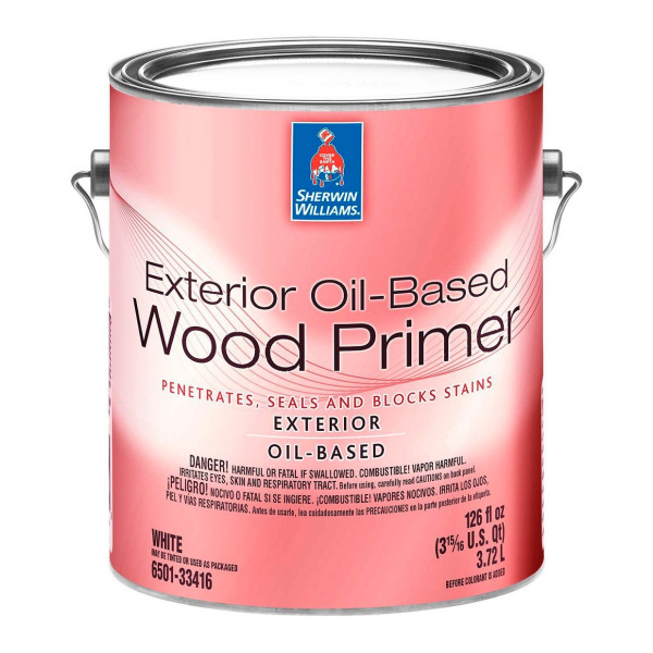

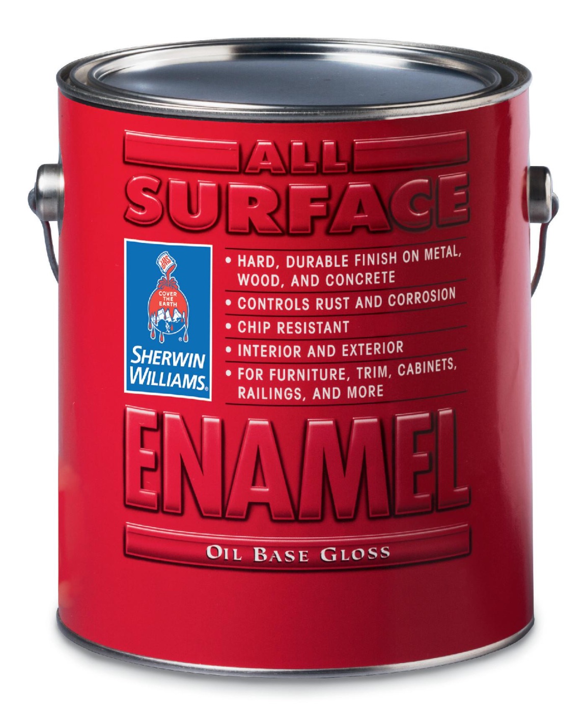

I would use a good oil based primer. With a good oil based black enamel over it. The primer penetrates deep into the wood, providing a good base for the finish coat to adhere to. I painted my house 30 years ago, primed with Sherwin Williams exterior primer and it is still protecting the house. Jim Patrick

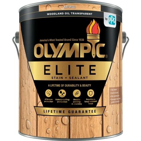

Anyway, back to the topic. Ford did not give much thought to preserving the wood. Even if he had, they did not have the products necessary back then to preserve wood. Since we want these cars to last as long as possible after we are gone, it is essential that we don’t do this the way Ford did, or the wood will rot just like it did due the Ford treatment. You need to find the best wood preservative that you know of and use it to seal and protect your body wood from the inevitable. In addition to my earlier posting, I have also used Olympic oil based wood seal which penetrates deep into the wood, has a lifetime guarantee and can be painted. Make sure not to get the silicone type, for silicone will not hold paint. Do not use Thompson’s wood seal either, for it too, is silicone based. Good luck. Jim Patrick
