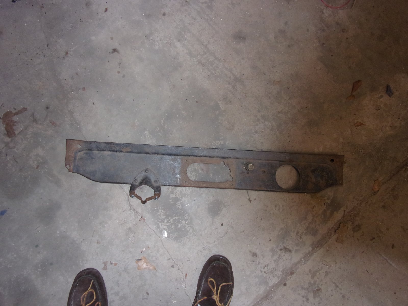

I'm still designing my firewall, cowl and dash set up for the WWI ambulance and came across this dash panel in the parts stash. Don't even know if it's Model T. Approx. 38" long with 3 1/2" hole for . . . ? Clock? Spedo? Steering column bracket and choke rod hole line up with current T set up. Dash light, but it's toast, might have to find a hole filler for that one.
Any insight appreciated. I Googled images and could not find one that had the large hole.

Don't know exactly what year it is, but suspect it is somewhere between 1923 and 1926. The large hole is for a speedometer and the hole between it and the ammeter is for a dash light.

Thank you. I will post wanted listing for hole filler speedo and light fixture as neither would have been used in the real world for my project. Or, I may just use the little wooden bracket with the switch/amp meter on it and forgo the metal dash.

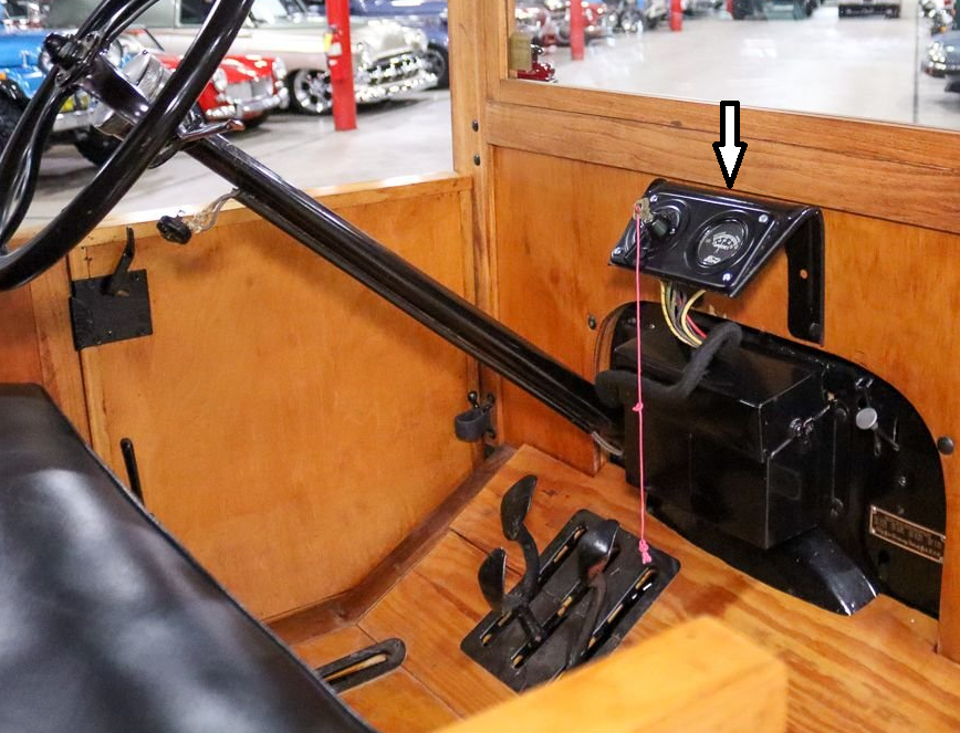

Since you intend to retain the 1926 coil box on the engine you might want an instrument panel that was on TT's somewhat coil box looking.
This mounts on the wood firewall & uses the rectangular switch (yes I have both). It gives the look of having the coil box on the firewall & period correct & simple
non-starter switch & bracket.jpg (26.38 KiB) Viewed 757 times
