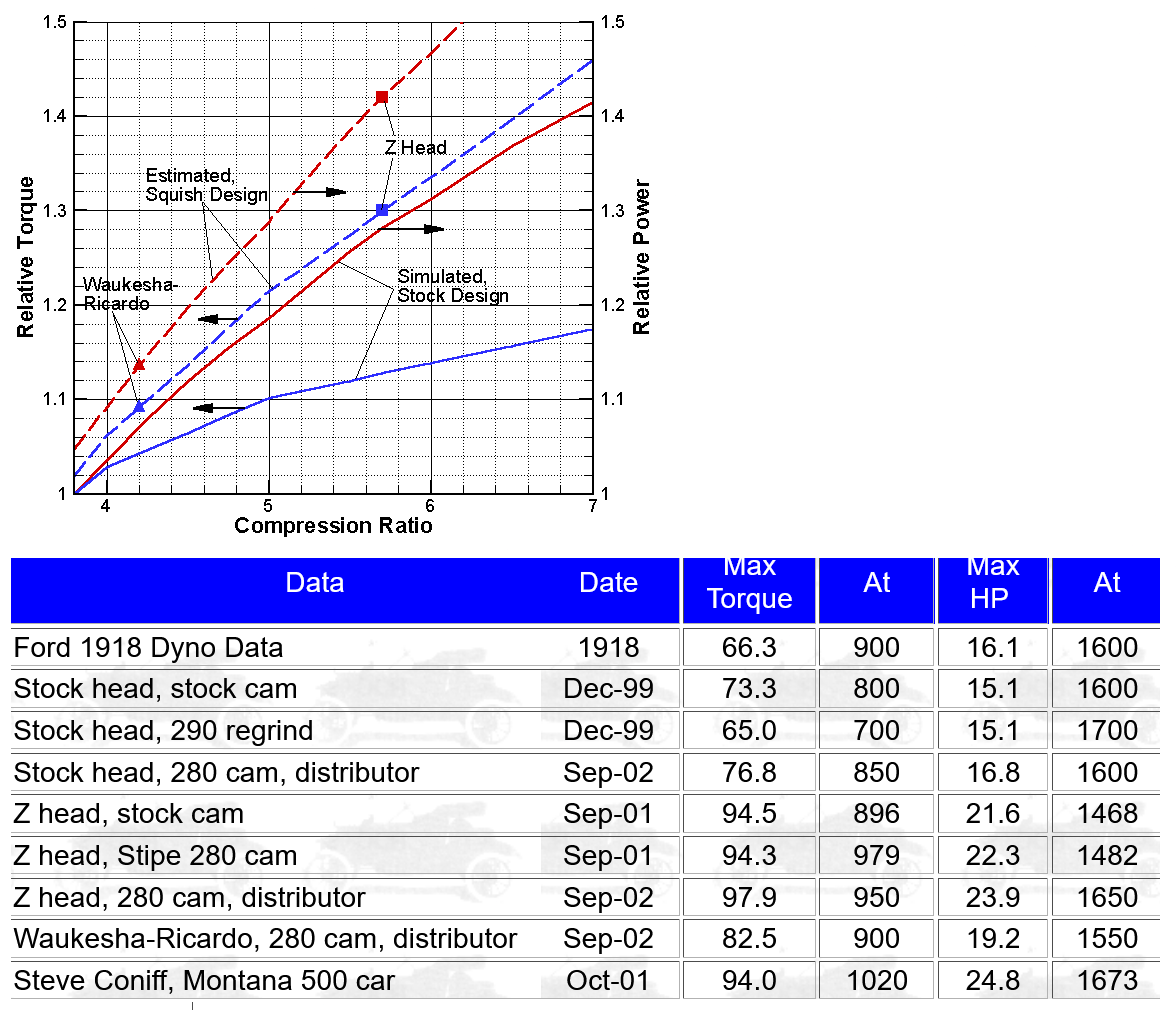

A Model T has some inherent limiting factors in an effort to acquire a higher rate of speed. One is the stock Model T engine's internals that were not intended to achieve RPMs much above 1800. Other's include aerodynamics (windshield), rear axle gear ration, suspension, and its ability to stop. So the relationship of engine RPM to rear axle gear ratio is what determines top end speedBeen Here Before wrote: ↑Thu Mar 07, 2024 11:22 amAquiring extra power
Rather than rebuilding a strong motor to acquire extra hill pulling power, can the installation to a 4:1 compression motor of NO2 be a benefit?
This link explains what can be done and what the resulting gain is
https://mtfctulsa.com/Tech/power_and_torque.htm
Stock engine Spec's
177 cubic inches - 2.9 litre (2900cc);
Engine Horsepower 20-22 BHP @ 1600 Maximum RPM
Engine Torque 83 Ft-Lbs @ 900 RPM
Top Speed Approx. 45 MPH, normal cruise 35 - 40 MPH
Engine RPM@Speed 1400@35 MPH, 1600@40 MPH, 1800@45 MPH Simple way of thinking (somewhat)
Torque is what gets the car moving from a stop; accelerates the vehicle onto the freeway; allows the vehicle to do more work, like pulling a trailer.
Horsepower is what allows the car to climb a hill without slowing; push a car into a head wind and maintain speed.

The z head looks like a VERY good choice for a T.
