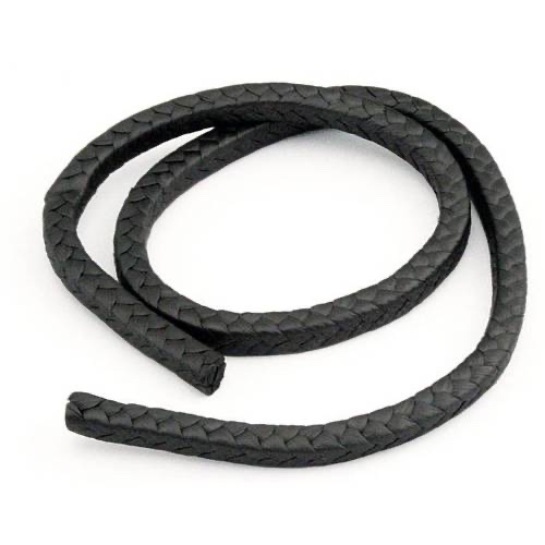

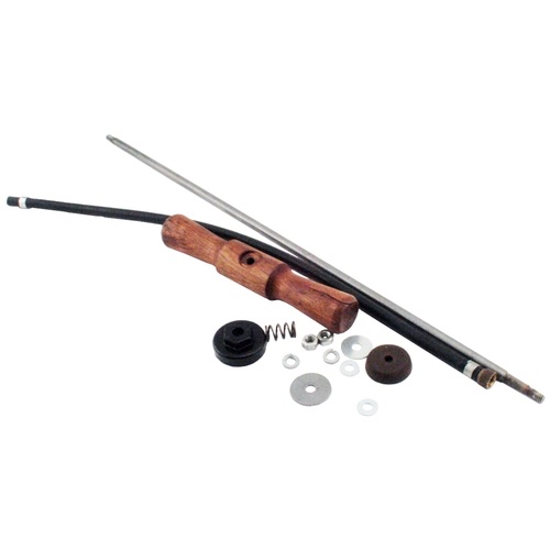

If you go to Snyder’s and do a search for pumps, they have graphite packing. They also have rebuild kits for tire pumps.

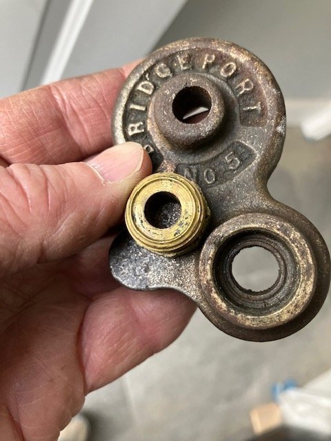

Here's some pics of a of the top of a Bridgeport No 5 I happened to have off a pump. You can see how the top of the pump and the nut squishes the packing. The "antique" packing seems to look like it is oil soaked leather.

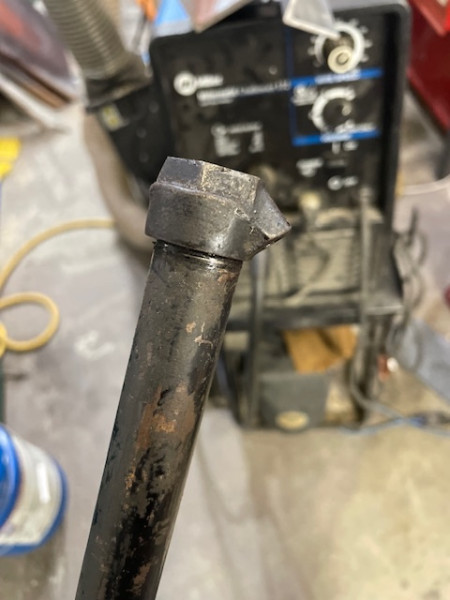

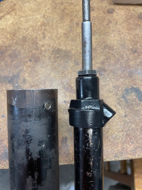

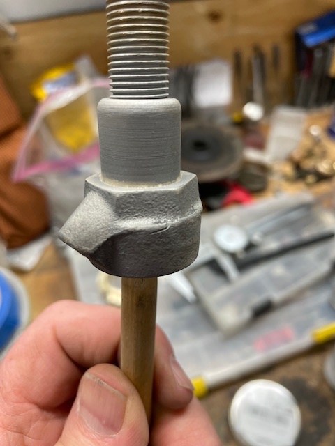

I got this pump and in addition to the standard worn out leather cup seals, the threaded portion of the cast iron top on the small tube was broken. I made another one of steel and silver soldered it in. So now I now have good threads. The packing goes inside the threaded part and is compressed by a hollow bolt of sorts (that allows the rods to pass through) that compresses the packing. I still need some cup seals and a new hose so it’s still in bits. I have been thinking about making the cup seals (not a tough job) but I might order them.
Here is a photo of the top of the small tube I fixed. The round top is the new part I made.
I added a couple of shots of the repair in progress.

Morgan: Nice work there. My experience with 2-stage hand pumps has been that the pump rod on the small cylinder has to be perfect, any pits or surface roughness will quickly destroy the upper seal. jb
