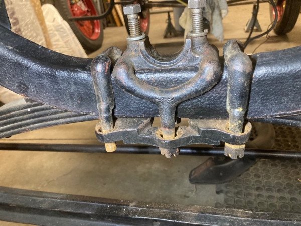

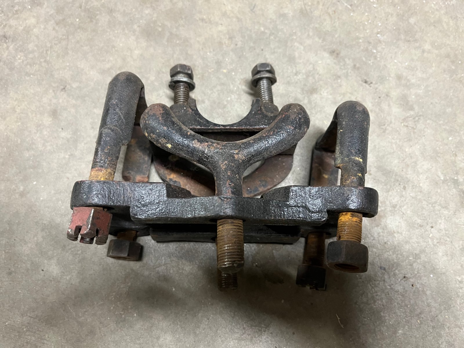

Front motor mount, spring clamp that came on my 1927 Touring, I would never figure out how to make this thing work.

You have two separate mounts, they don't belong together.

They belong together as an accessory
Spring plate fix.jpg (152.3 KiB) Viewed 732 times
However the plate looks a bit different - there should be some of it the fits into the cross member - depends on the number of leaves in the spring. Thinking it may have part of a hitch
