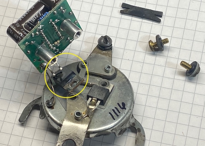

Yesterday I was setting the null point on my '24 Speedster, out of the car and using a 12-vt battery (per Ron Patterson).
Sadly, it never crossed my mind to remove the Fun Projects VR prior to this procedure. BZZZT!! and then all the factory smoke billowed out of the case. Oops.

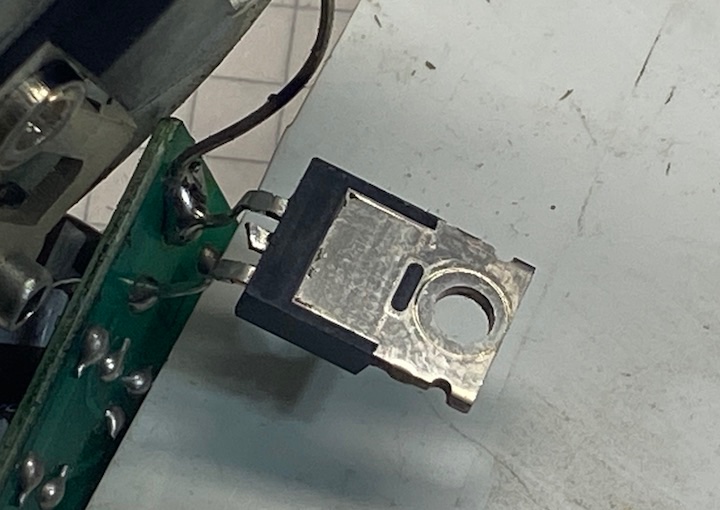

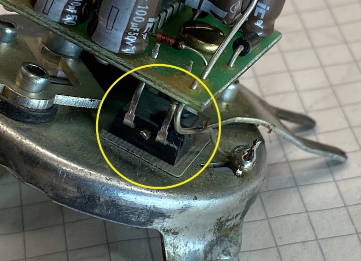

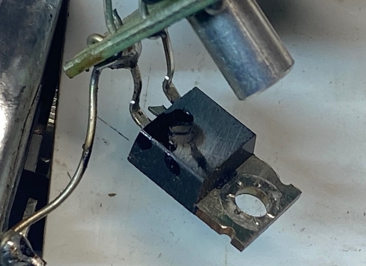

Plan B was to convert the fried VR into a diode cutout until I got a replacement, then keep the diode unit as a spare. Upon opening the FP BR case I found that only one component seemed to have overheated. It is the rectangular gizmo circled in the photos below and is connected to the generator terminal.
So, maybe there is a path back to health for this unit. Can anyone identify this component and suggest an appropriate specification? There are no ID markings that I could see. There is a well-stocked electronic component vendor in our city and if this is all that's wrong I might be able to replace it successfully.

you fried the MOSFET! The rest of it should be fine. This is a common problem with these units, mine inclucded.
If you're interested, here's a link to the circuit diagram of the FP Voltage Regulator. Pretty basic design using PWM. Ours design is quite different but just as effective. Unfortunately the FP regulator became unavailable when Fun Projects was sold to Birdhaven. One of the critical parts became unobtainum.
https://www.cool386.com/regulator/regulator.html
I also sent you an email. I can send you a new N-Channel MOSFET (no charge) or you can send me your regulator and I'll fix it for you.

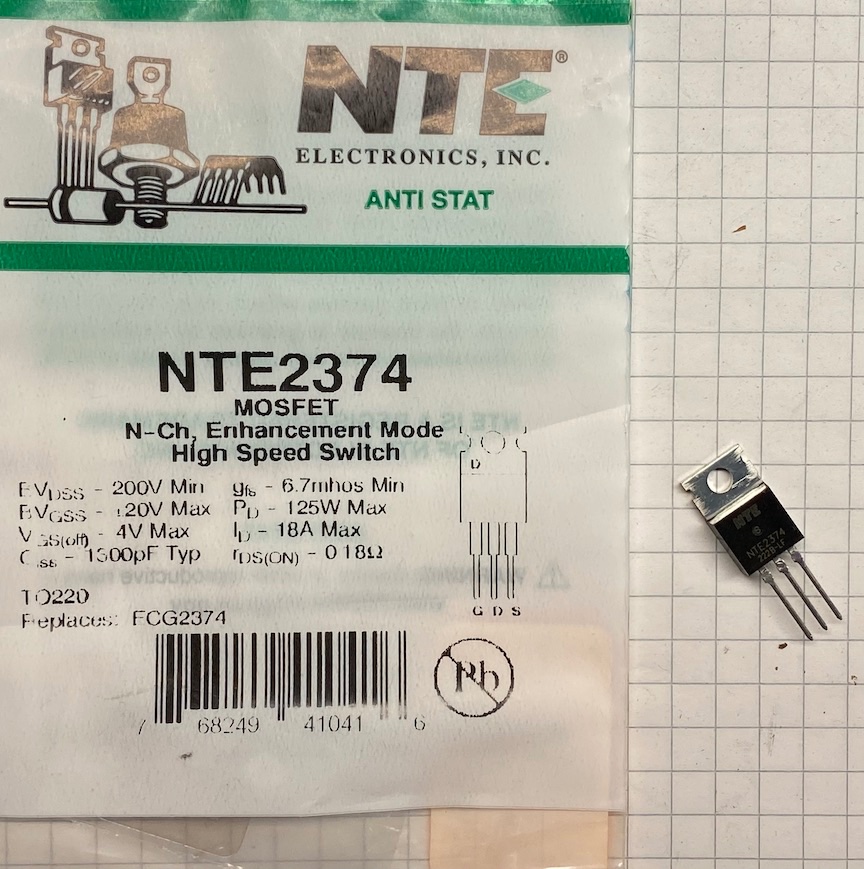

The fried component was a MOSFET (metal-oxide-semiconductor field-effect transistor), basically a switching device, connected to the generator terminal. Jeff says this is the most likely failure with these VRs and that reminded me that John Reagan had described a common failure condition that preserved all but one replaceable component. And here we are.
These MOSFETS are apparently dirt cheap in quantity—Jeff offered to mail me one no-charge—but I sourced mine locally for CDN$10.50 full retail OTC. Swapping it into the VR was straightforward and I took the extra step of affixing the cover onto the base with a couple of itty-bitty screws. Another Jeff suggestion. Originally there were two small spot welds holding things together.
I used a good working mechanical cutout while setting the charge rate and installed the repaired VR once everything was adjusted properly. Max charge rate is now 5-6 amps, which should be plenty. My speedster is an easy-starter so the battery tops back up quickly and the LED headlamps don't pull the ammeter into the negative.

Absolutely PERFECT job!!! You can get them on Amazon in a 10 pack for about $8. I order them in 500 quantities, so my cost is much better:)
And yes, the MOSFET is the component that fails most frequently. Most of the time it gets blown when folks connect the generator tab to the battery tab to test if the generator is working. You can do this all day long with a Cutout. You CANNOT do this with a Voltage Regulator. If you do that, the MOSFET self destructs and shorts the generator output to ground. Permanently. Thus requiring the fix that Chris just finished.
