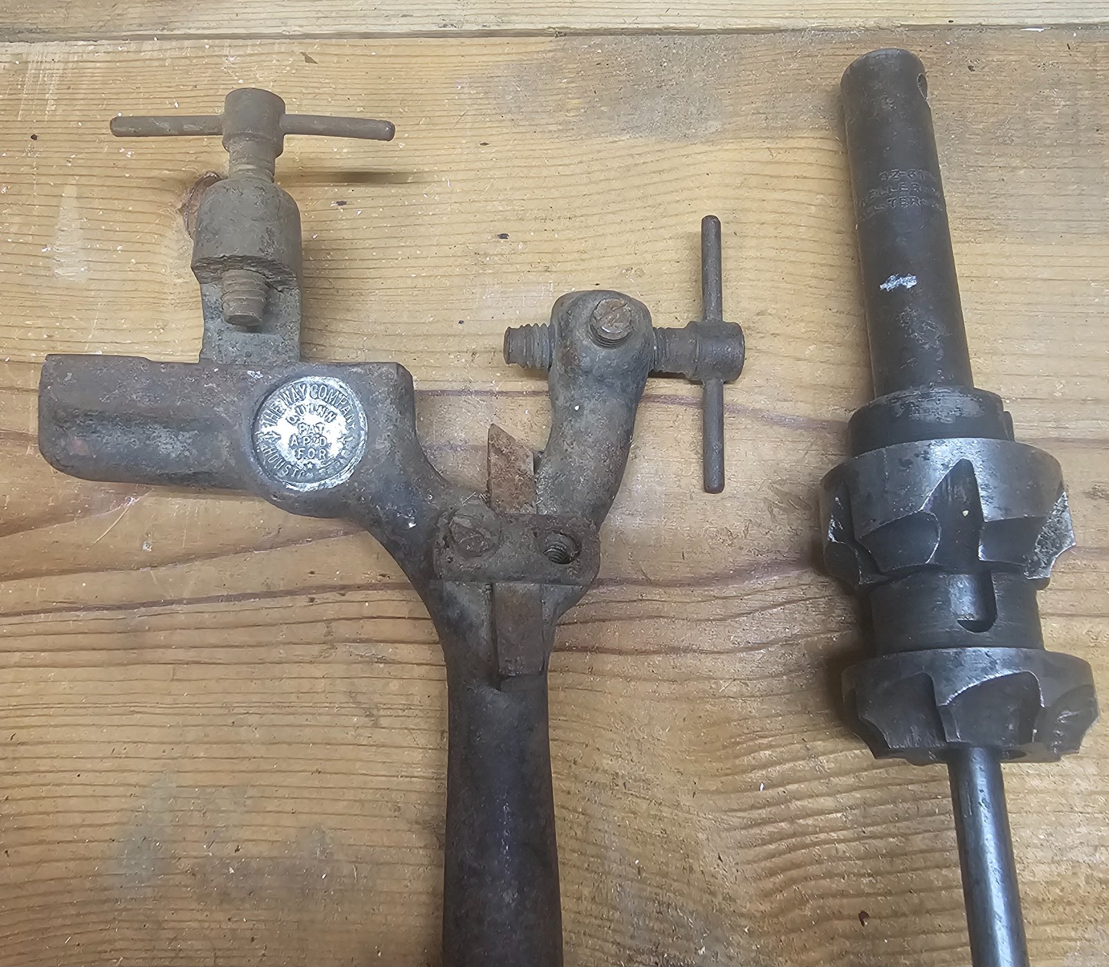

Just picked these beauties up for a song. The larger seat tool has the Ford script. How viable of a tool was this? It would create an arched seat instead of a three angle. I know the intake would work fine with a narrow seat, but I was taught to create a wider seat for the exhaust for heat transfer.

I use them for carbon removal - Neway for seat cutting.

That Neway tool is the cats meow...or as others would say the "cats butt"...
It really works great as demonstrated to me and a friend by Joe Bell. Too expensive for me to own as I don't really need one anyway. But it would be nice to have one "just because"...
