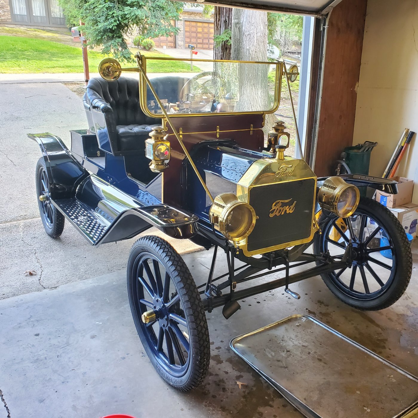

I am completing a 1912 commercial roadster that has a build date of Dec 1911. Im getting ready to have a top installed and need to know about the straps that hold the front top bow to either the windshield or front
fender irons.
My fender irons have integral holes for connecting the top straps suggesting the long fender straps were used, but Im not sure that fully answers the question. It well could be Ford switched over to the windshield straps before the supply of earlier style fender irons was used up.
I cant find any informstion on when the changeover to windshield straps was made and would appreciate any information.
fender irons.

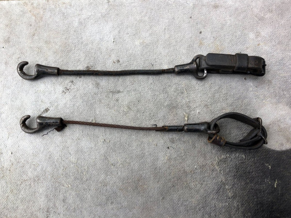

Richard, as we have discussed my 12 Roadster is a late 11 build serial number 86XXX so similar to yours. I have the same question as you about which straps to use, as my fender irons have the loop for straps. I have the two piece fire wall. It seems the consensus is that a two piece firewall would LIKELY have continued the front straps and then sometime in 12 the system was changed to the windshield hook straps.
Totally unrelated to your question, the previous owner of my car, Ken Jones, was ecstatic when he found the straps shown in the attached photo that are attached to the front bow using a footman loop and then hook to the windshield frame. They were apparently used during a brief transitional period in 1912. Ken was pretty anal about accuracy and he planned to use them, but I have nothing to back up whether his decision was correct or not. There is a picture out there somewhere, it gets posted fairly regularly, of Henry Ford and his family sitting in a 12 Touring and it shows these straps being used on that car.
As I said, this is unrelated to your question and doesn't help you in gettng a definitive answer, but thought that you and others messing with 1912's might find this of interest.

Thank you Wayne. Its been a journey.
