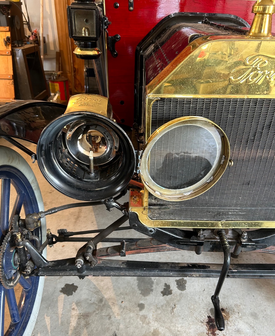

When I got Lizzie as an older restoration almost eight years ago, the headlamps were mounted with the catches inboard, which allowed the lamp doors to swing outward and touch the fenders. I never gave it much thought, other than the rims and lenses could hit the fenders, so I’ve been careful not to ding rims or break lenses.
Today, mounting the lamps again following an engine overhaul through the winter, it occurred to me it would be better to switch their positions and have the doors swing inward. I wonder which way would be “factory original” ?? :lol: Thoughts ?

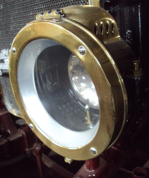

Look at some original photos of cars with Brown headlamps .
My original E&J 666 are both hinged on the left and open to the right.

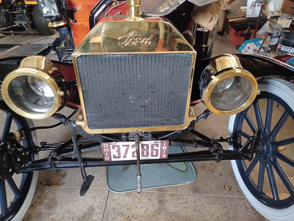

Perhaps E&J didn’t make lamps in “pairs” ?
Mine are Jno. Brown. Friend sent me a pic of his ‘13 with E&J lamps, both hinged on the same side.

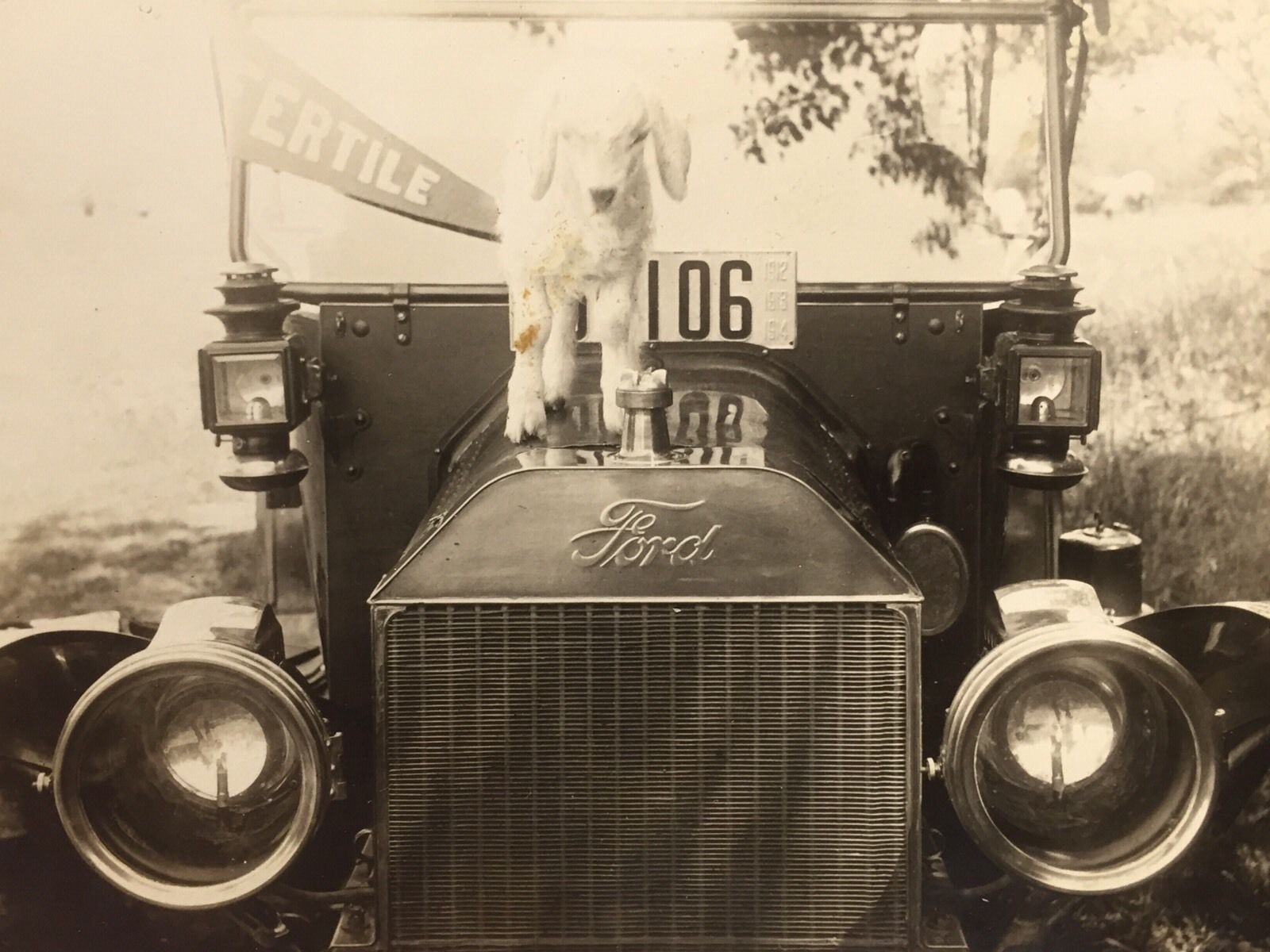

Here is a period photo showing a brass era T with the headlamp hinges inboard so the rims don’t make contact with the fenders. I would say this is how they were meant to be installed. Jim Patrick

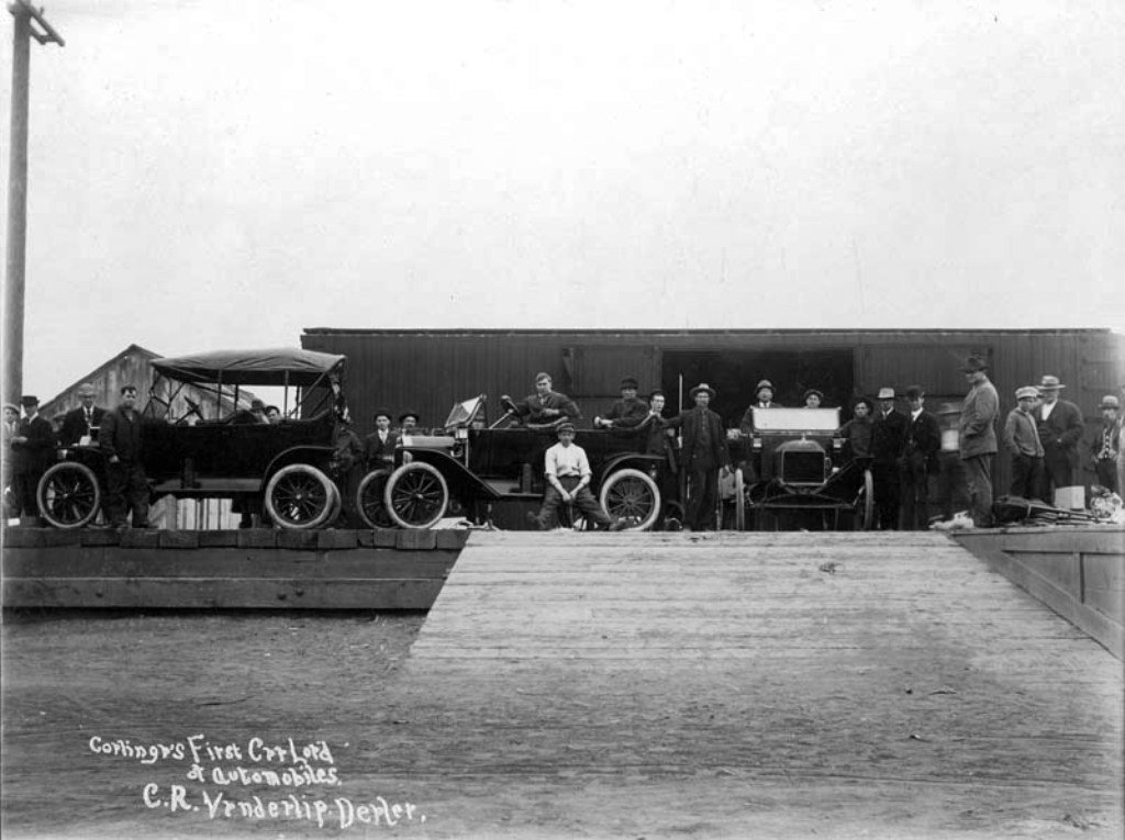

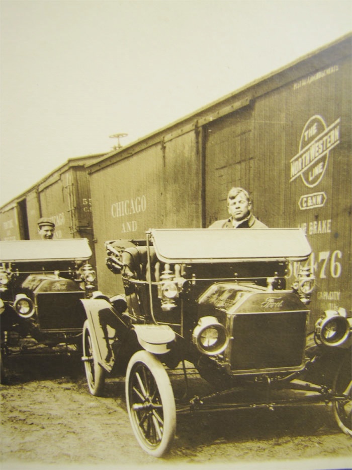

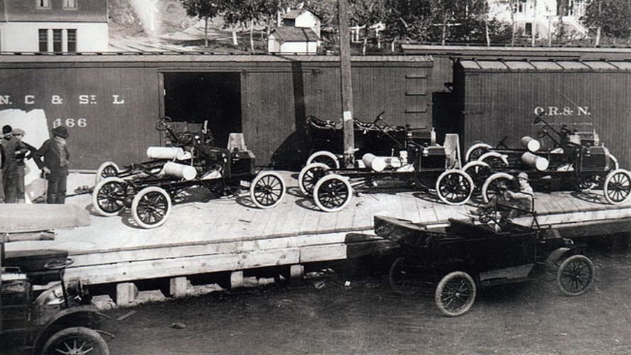

It appears that Ford shipped 1913 cars and chassis with the headlamps packed separately to be installed
at the off-load/dealer location. Probably in a box of two lamps Ford received from the manufacturer.
Notice in these two different locations that the side lamps are mounted but not the acetylene
headlamps. That may explain why you will occasionally see headlamps from one manufacturer
and side lamps from another on the same car. That seemed to happen with the acetylene generators
which were also shipped with the car, but to be mounted on the car/chassis by the dealer.
A couple of photos of the off-loading railway cars with newly assembled 1913 cars and chassis.
