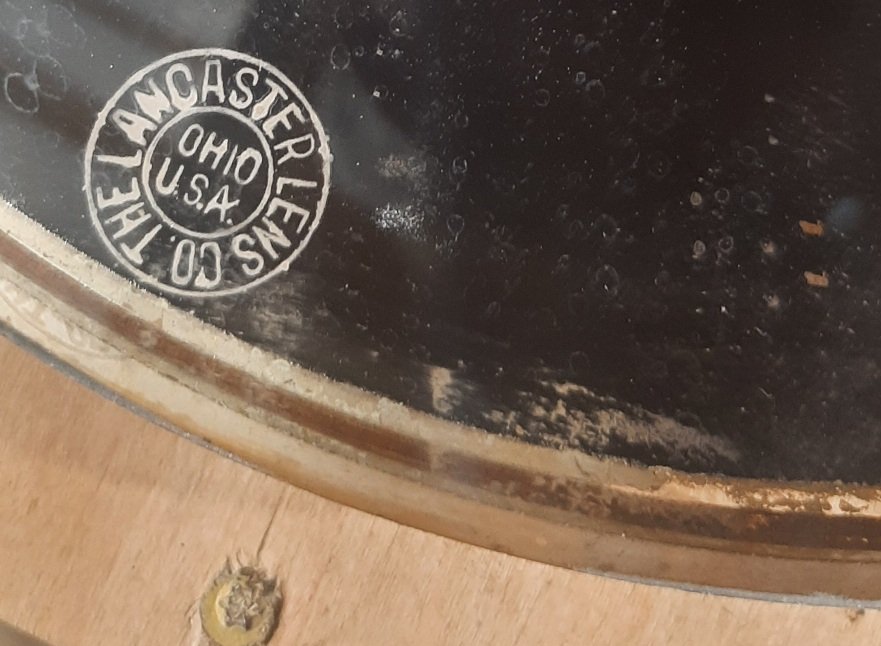

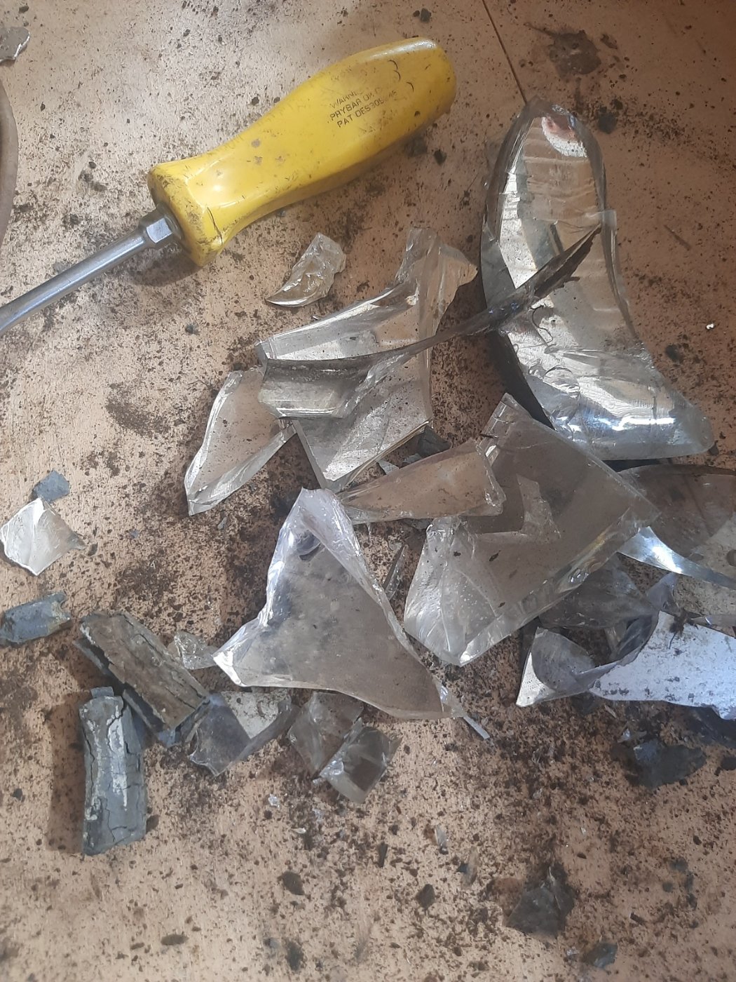

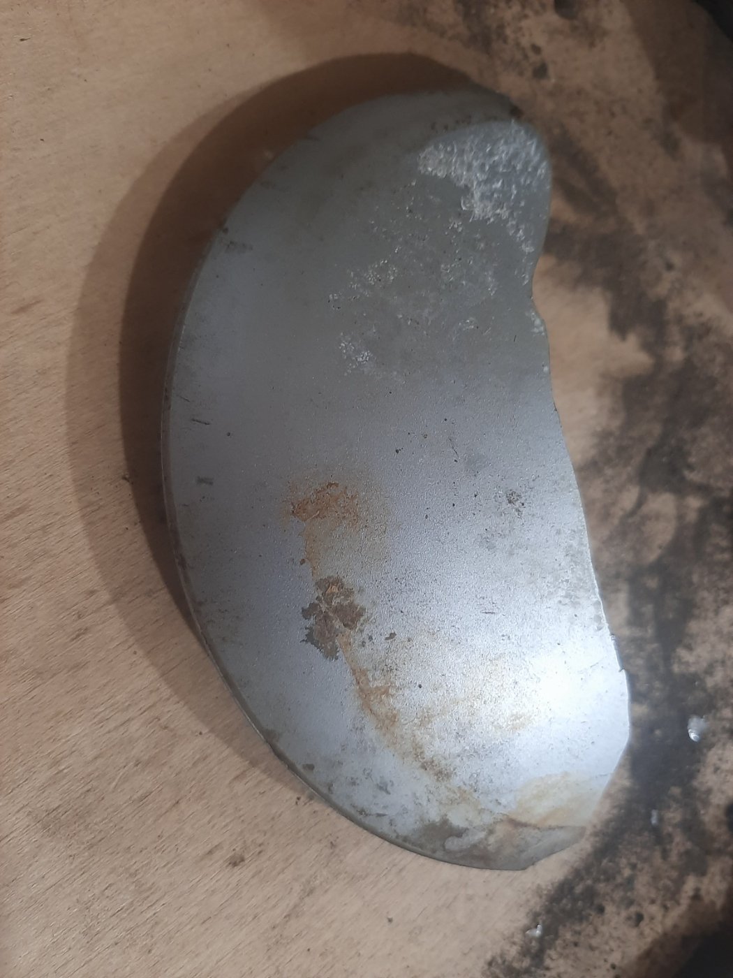

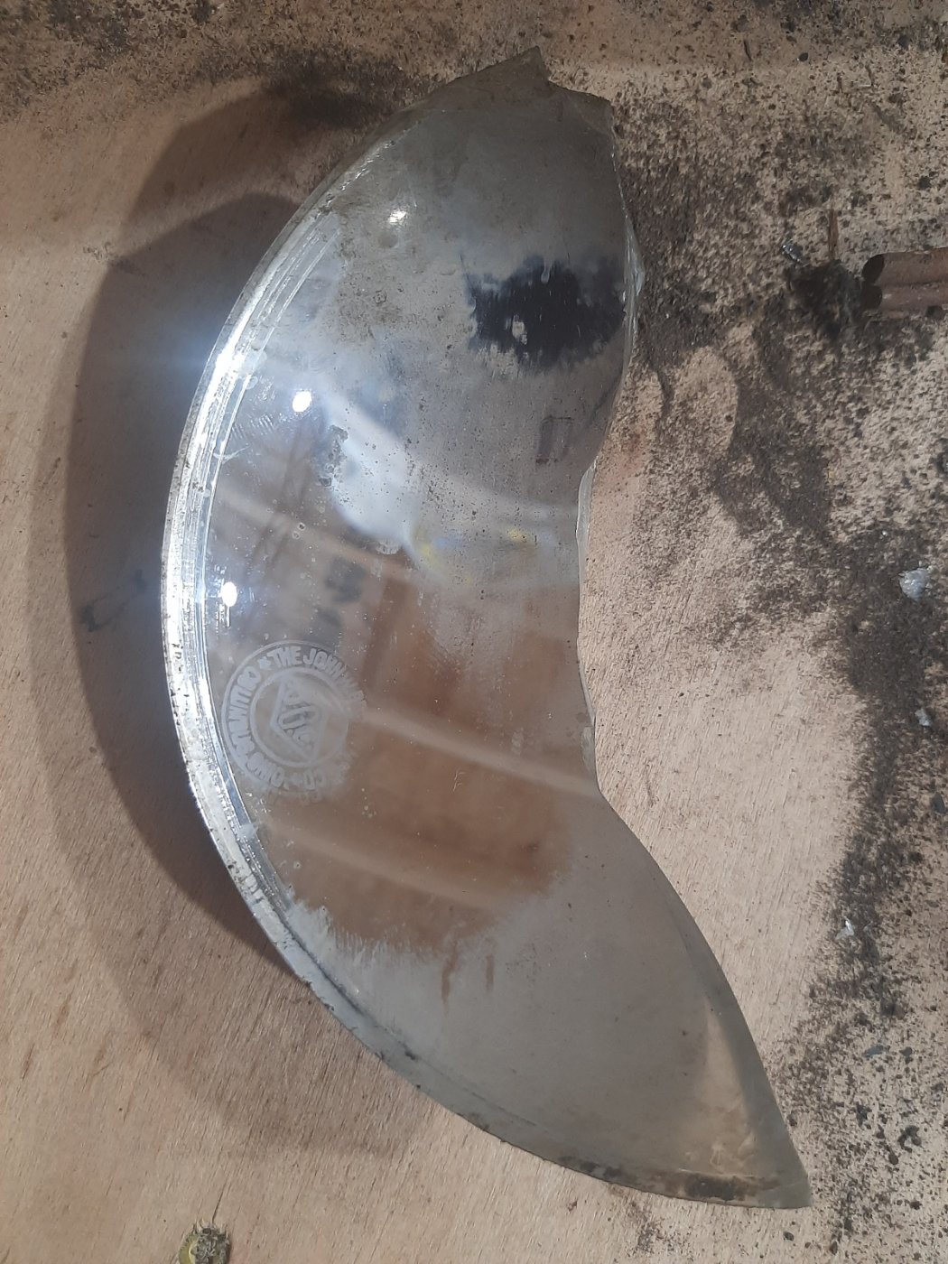

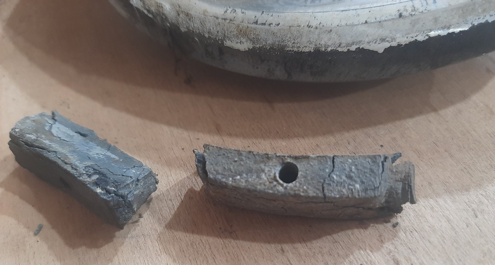

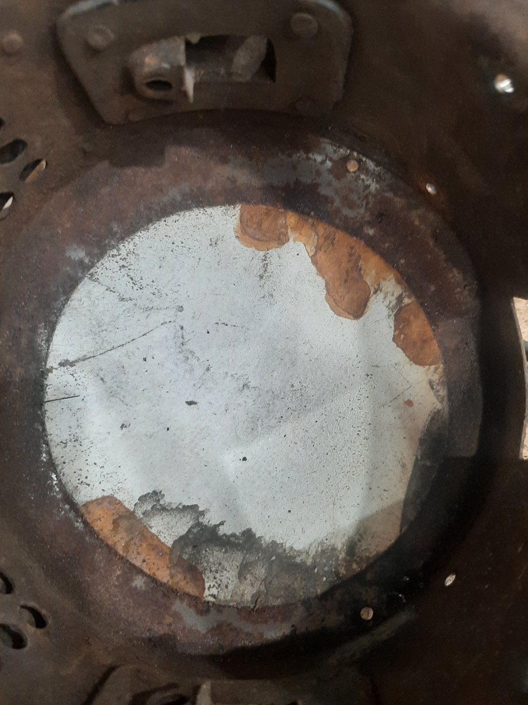

We removed and replaced a headlight reflector for a Model 16 yesterday. I'll post the pictures here for general interest as I wasn't able to find clear photos of what the logo of an original glass reflector looked like. It's unfortunate that the existing reflector was so badly cracked all the way through in multiple areas, there was no saving it, but I had another ready to go in it's place. My feeling is that it's original, but perhaps others may be able to determine if that is indeed so.

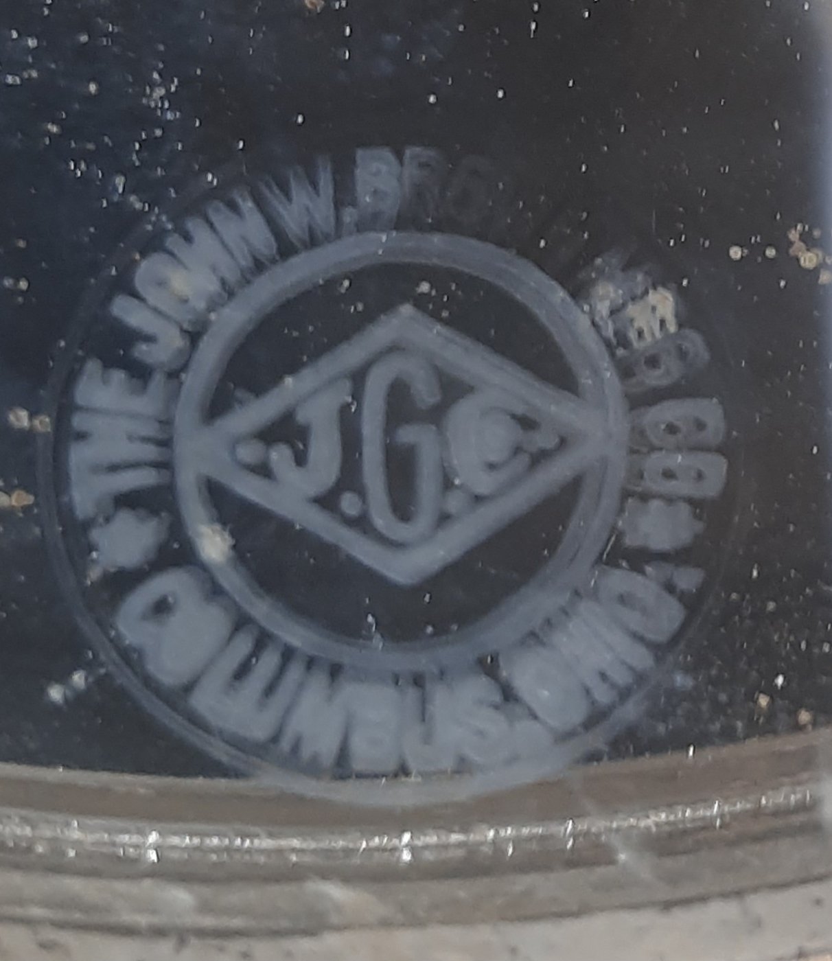

More pictures here, along with replacement reflector logo.

The original reflectors are not all made to the same specifications, so finding a matching replacement is difficult. When I had my E and J lamps restored I managed to find a second reflector of the same diameter, but the mirrored surface was more curved on one. This affects the focus of the lamps. When my two are correctly focused, one burner is forward of the other. In daylight, this difference is is seen as a larger dark circle on the reflector at the back of the lamp. It is no big deal.

The wedges were pot metal, and the photos above show what happens. We made them for years, and they are probably available still from Langs.
