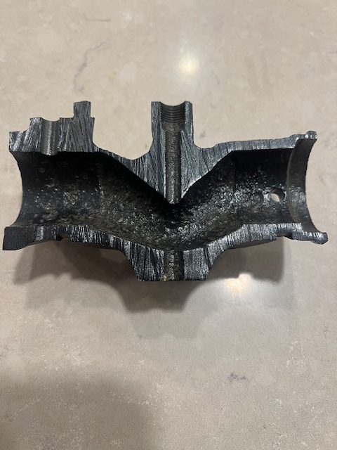

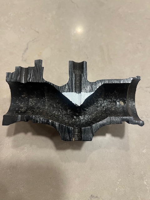

A while a back I cut a junk NH body in half. Has anyone removed any of the hump to improve air flow? The white portion of the hump could be removed to more closely resemble the straight through design. Has anyone tested this out?

Would it not mess with the venturi effect there forth reducing the fuel supply & atomization by slowing down the air velocity through the Carb?

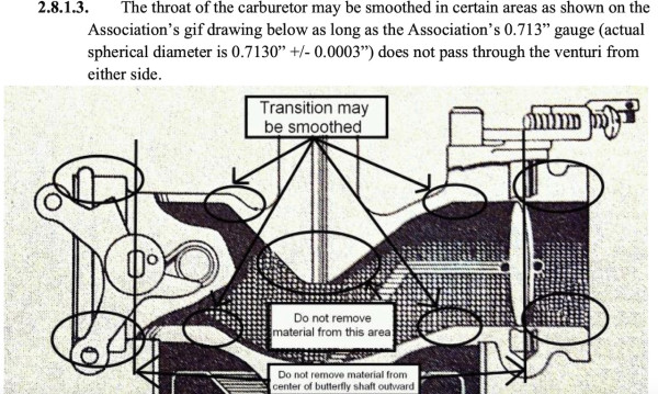

Only a bit of 'smoothing' at the sharp corners of the venturi, and a guage is passed thru to check that the bore isn't changed, Montana 500 Rules are stock like sway back NH.
Do like the idea of boring the venturi Bob did years ago to a straight bore in the swayback NH , if one can't find the early straight-thru NH.

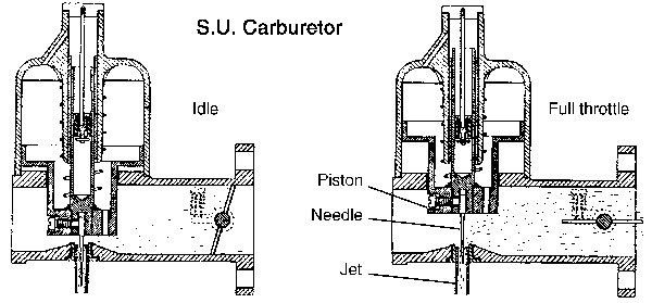

It would make more sense , rather than take the dremel to the NH Carb, to adapt a carb such as an SU or Amal to the Model T intake to improve fuel flow.
