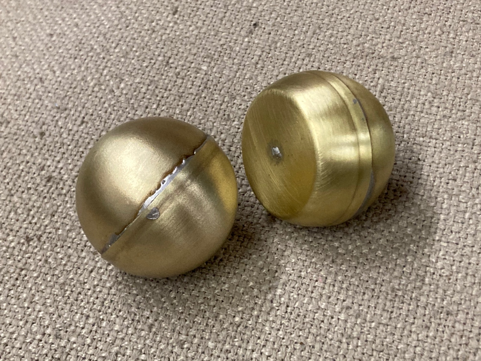

Repairing your float is absolutely possible. Care must be taken to maintain very similar weight so watch your material wall thickness. Soldering with a torch works well if putting a new float together… but you will find a large soldering iron or copper will work best for touch up work.
May also look into Nitrophyl float material. It’s a closed cell foam that can be used to replace brass floats with near 1:1 displacement. Typically found in relatively thin sheets, but I did notice recently that Restoration Supply has it in a larger diameter cylinder shape. Could turn out to be a quick lathe project…

The trickiest part about the soldering is the final close up. I use a fine point scribe to stab a tiny vent hole (.005”-.010”) in my new Winfield floats, your original should have a similar hole somewhere. Once all the heavy work is done, this vent hole is closed off with a dab of solder using an iron. I have found that filling this vent hole takes some practice. If the float is not just the right temp, globs of solder can fall into the float, vacuum can such the solder in, pressure can blow the solder out, etc…
Setting the float on a steel bench will draw the heat out too fast. I suggest using a piece of tubing as a support stand to minimize the amount of heat loss thru surface contact
