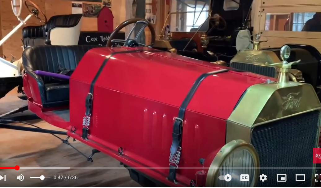

Anyone used this type of hood?
Post by skyhunter » Sat Jun 08, 2024 12:48 pm
How long are these things?!

Re: Anyone used this type of hood?
Post by skyhunter » Sun Jun 09, 2024 12:50 am
I am just wondering how long they are. I have a speedster and like this look, but not sure how long this is and if it will hit the steering column. Need to reconfigure the seat height and distance. Etc. Etc.
Post by skyhunter » Wed Jun 19, 2024 10:44 pm
Nobody will say Les.
Posts: 7306
Post by Allan » Wed Jun 19, 2024 11:54 pm
The width of the top tank on the radiator is known,. It is simply a matter of scaling up that measurement against the photograph.

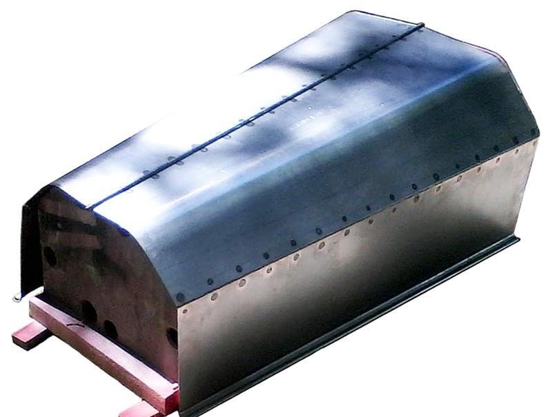

Post by Craig Leach » Thu Jun 20, 2024 11:23 am
Considering that cold rolled steel generally come in 48" x 96" sheets & sheet metal brakes over 48" are rather costly. With the wired edge @ the
rear. the folded edge @ the front & compound angles to get a slight slope to the hood it would be impractical to make it more than 46". On my speedster with the steering column not quite as low as the one in the picture 43 1/2" would be the longest it could be. That is a neat idea, think
of how easy it would be to work on dash wiring with no cowl in the way :D
