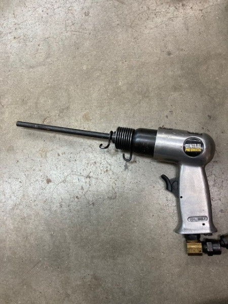

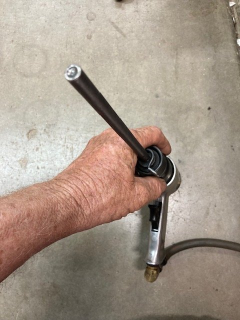

that like making their own tools. Using a valve guide impact driver ( that was miss ordered ) cut the end off & drilled recess in the end with a
ball end mill ( a drill Will work ) This worked great for peening the rivets when backed up with a dolly.

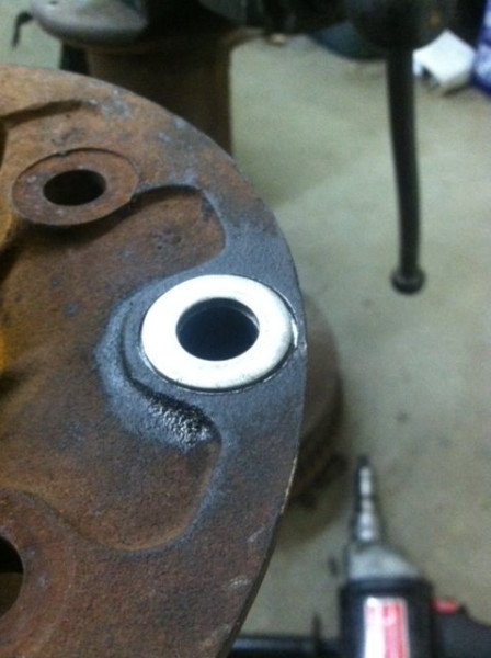

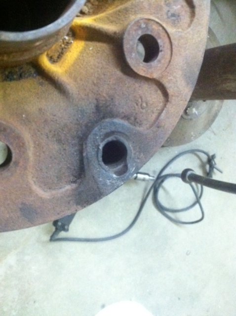

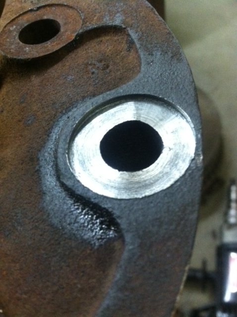

I noticed in one photo a worn backing plate where the brake cam had cut into it. I found a solution
to this by counter boring the backing plate & installing a washer for the cam to run on which should prevent that issue.
