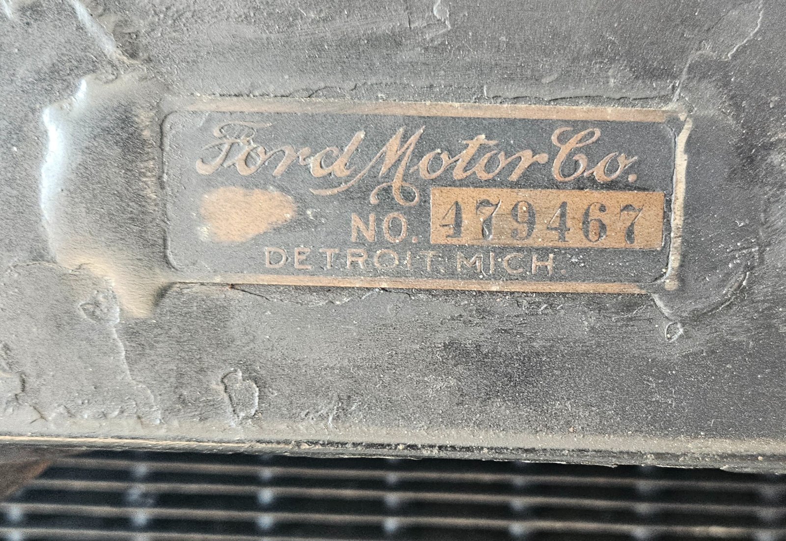

I have this tag soldered to the back of the upper tank of my 1914 brass radiator:
Do Brassworks put a tag like this on their reproduction radiators or do I have an original Ford radiator?
The number stamped - was that supposed to be same number as the VIN/Engine number?
Ford Model T 1914 Touring

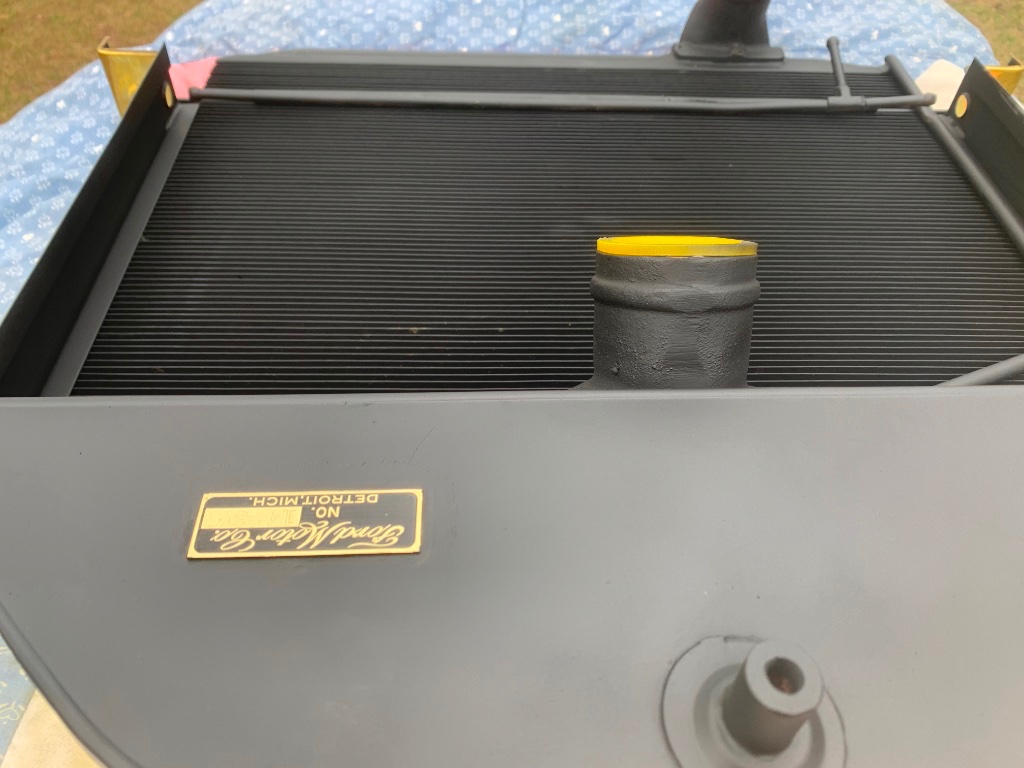

My brassworks has one soldered on and the number has nothing to do with a vin/engine #

Copy of the original but no number.

A few years ago RV Anderson (RIP) was reproducing the tags for the radiators and would stamp them for you. RV was a stickler for details. I had a repo brassworks radiator that had the generic tag soldered on it and I removed it and put one of RVs tags on it. If I’m not mistaken there was a difference between earlier radiator tags and later ones. The tags RV made would have been for the earlier style up to 14?

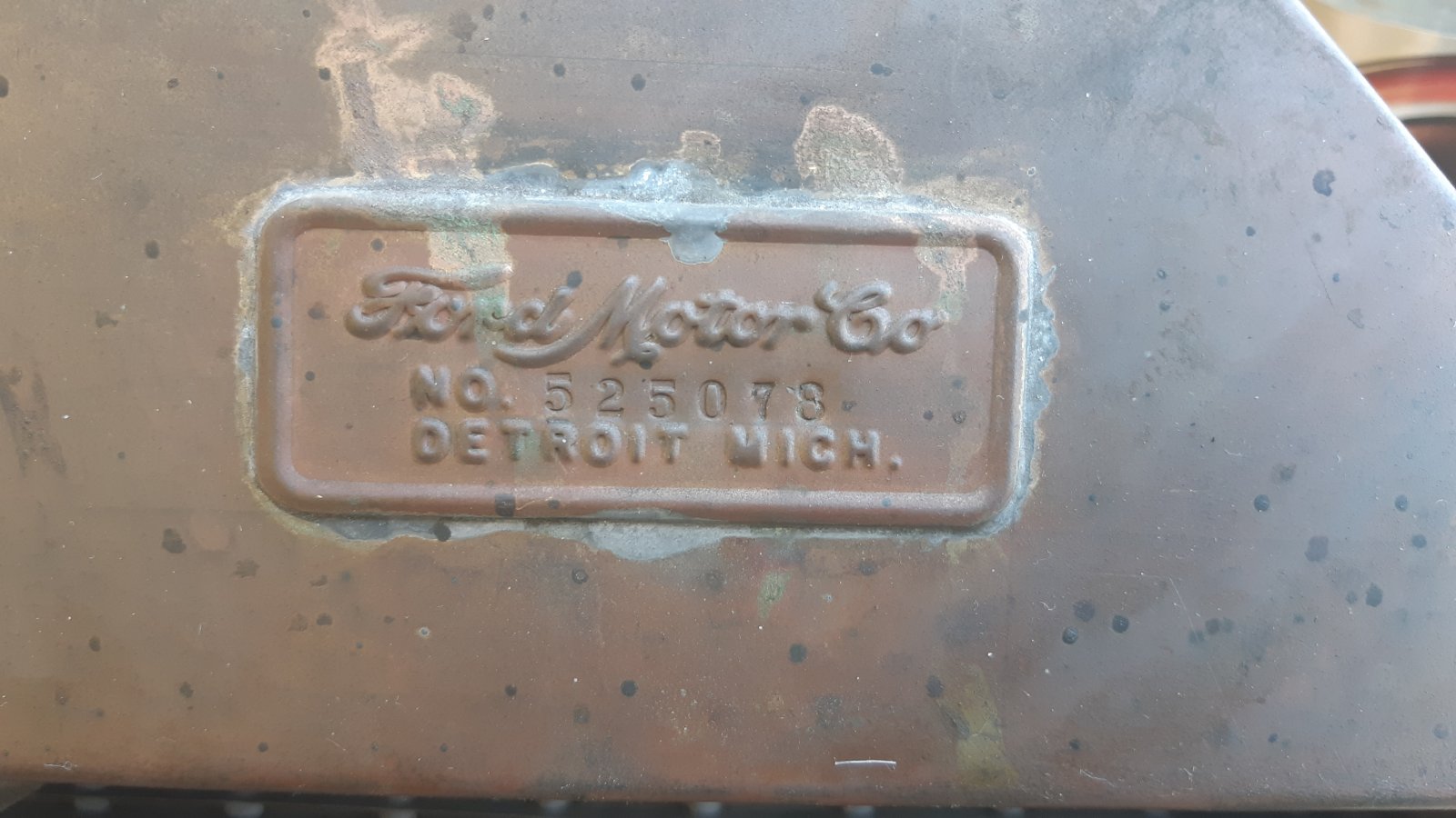

Re: Tag on brass radiator
Post by Daisy Mae » Wed Jun 19, 2024 2:29 pm
The tags initially posted were all I've ever seen in the past, but, neither have I seen many 1914 or earlier cars in my life.
My March '14 build T has the other variant:
