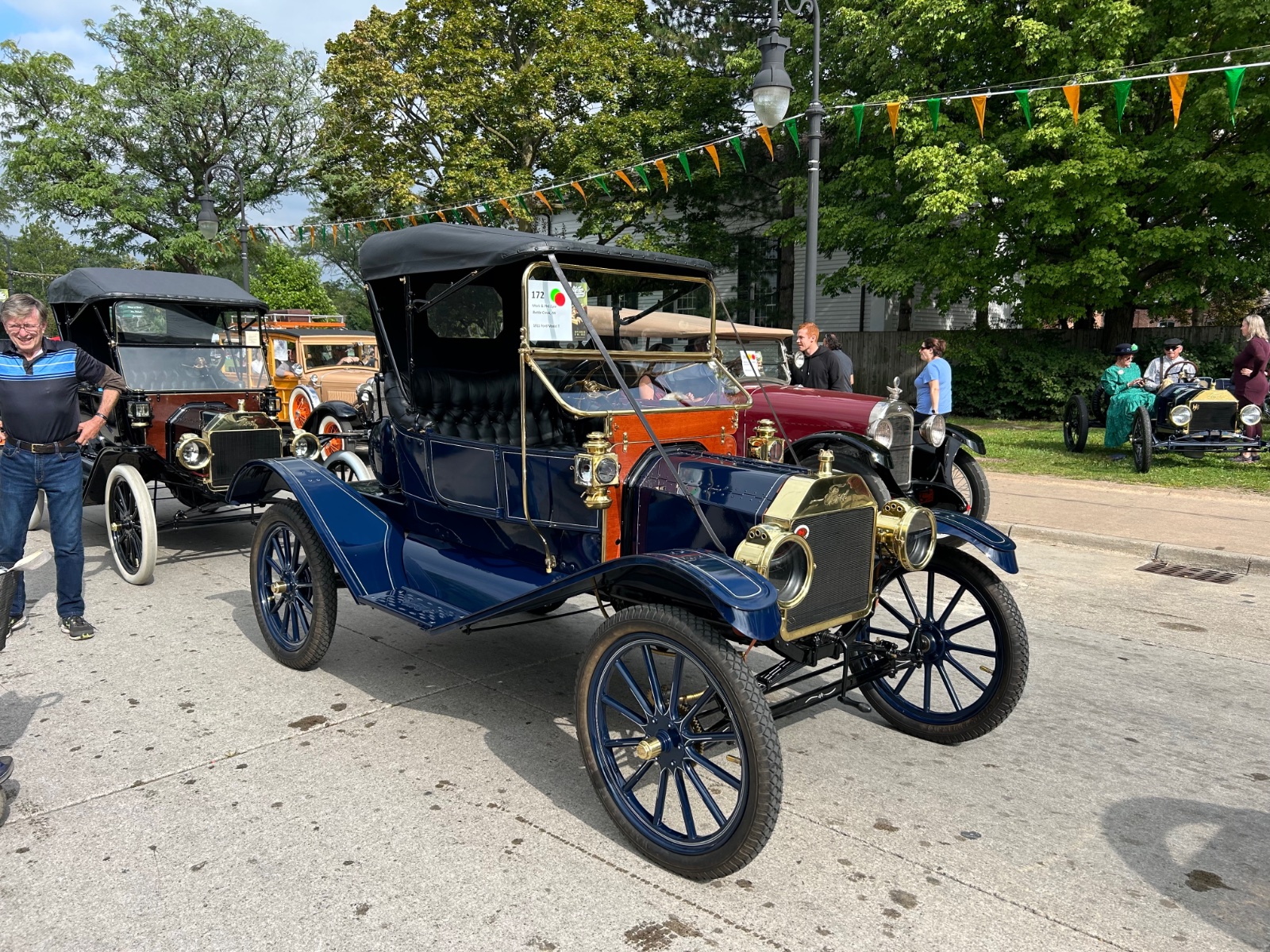

I had good results with the nason full thane paint too. Simple and reasonable to use. It’s single stage and polish’s out really nice. But if I had to do it again I would paint my 21 Touring with black fenders and grey body. I later saw one that was painted those colors on the forum and it was an Australian scheme I think. Can’t remember for sure but it looked really sharp.

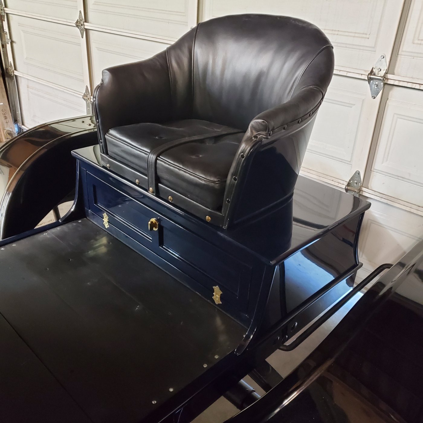

Re: Paint Scheme Dilemna
Fully agree with using Nason Ful Thane. A very good reasonably priced single stage paint. From what Ive been told Grass Valley Ca where I purhased mine sits in the only county in California that permits the formula I used. Sacramento, Placer counties, etc also have Nason paint but its a different formula. I didnt dare mix the two so I continued to purchase what I needed in Grass Valley. It lays down very well, color sands and buffs out nicely. Was able to touch up flaws such as burn thrus and runs adequately.
The colors I used were the Mercedes midnight blue and an onyx black . I have the codes somewhere.

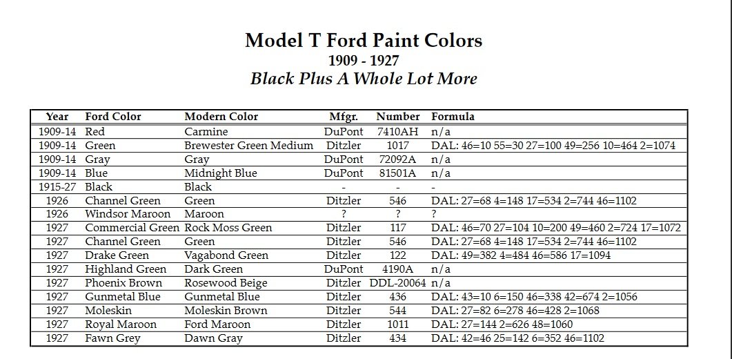

jiminbartow
- Posts: 2468
- Last Name: Patrick
- Location: Bartow, FL
Go to the picture gallery on this site or Bing and Google images for Model T’s. There are lots of pictures of Model T’s in various colors schemes that will show you what the finished products will look like.
Back in the day, Ford offered a limited color scheme and upholstery schemes that all T’s of certain styles and years were to be painted. If you want the paint job to be correct, only the very early T’s (1909-1914) and the 1926 and 1927’s were offered in colors. Everything in between was offered in black only.

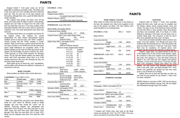

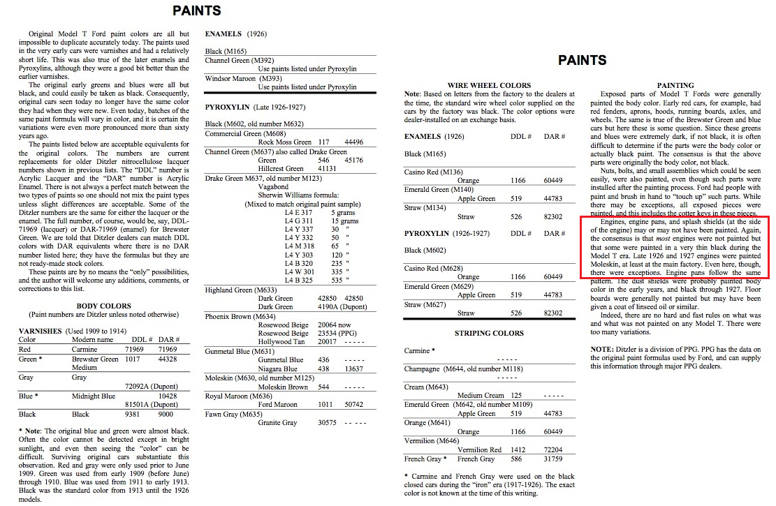

- Posts: 6544
Lots of information here need to scroll down to capture it all https://www.mtfca.com/encyclo/P-R.htm#paint2
