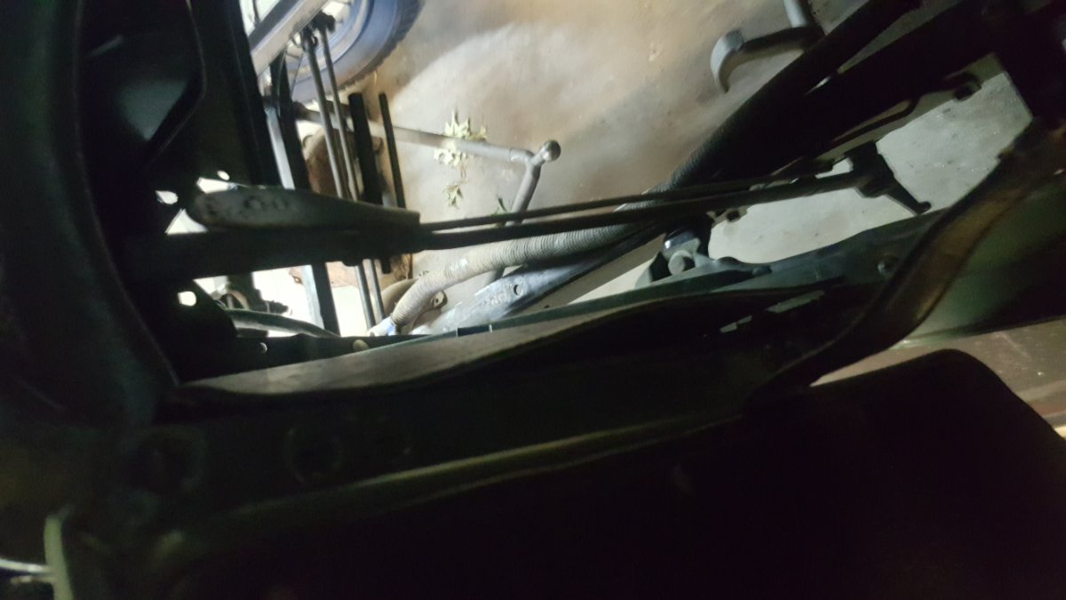

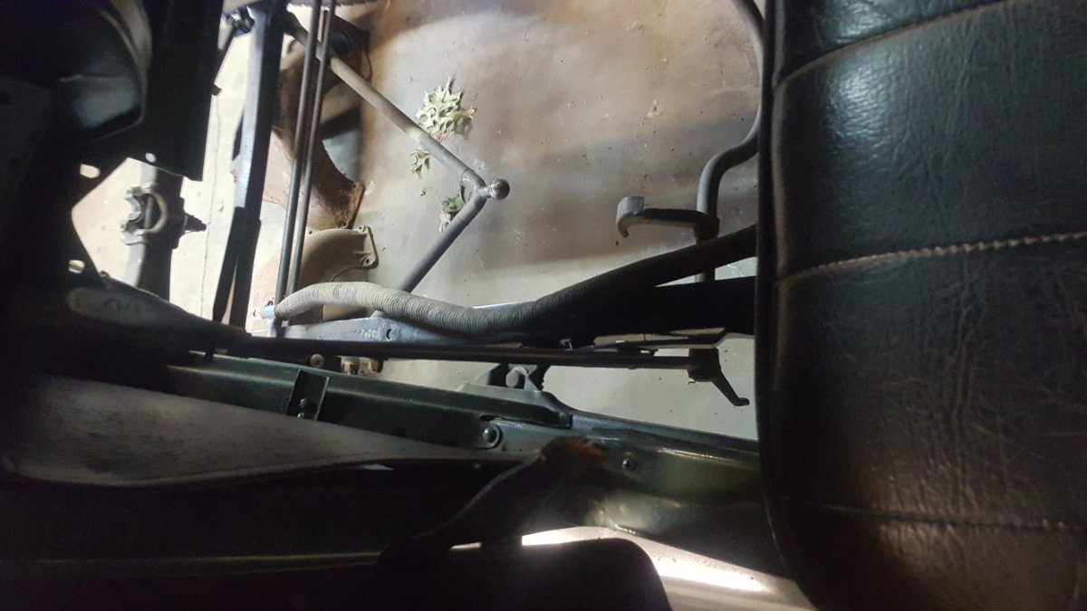

For me, this is useful bend on the '26-'27 open car for good left foot space on the low pedal.
Low # 1 bend starts approx. 4 1/2" from the pawl rivet. Then the # 2 bend , going back to straight is appox. 11 1/2" from the pawl rivet.
That provides a fairly nice offset of about 2" or so.
Views showing engaged high speed and 'free neutral' locations. Scales show the approx. offset. The pawl control rod kinda follows the same bends, but doesn't have to be spot on.

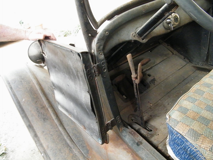

Thank you Dan. I thought the 26-27 hand break was different than the earlier style because of the bends I've seen. From your post I get the impression owners made the bends themselves to have more access. Is this correct?
- Posts: 2997
- Last Name: House
Re: Question re handbrake lever
Your initial impression is correct Richard. The New and Improved handbrake lever has a factory ‘bend’. The OP just wants to adapt an earlier straight lever/handle to approximate the ‘factory bend’.
- Posts: 4052
Owners could 're-shape' the hand brake if needed, good Ford steel easy to bend cold.
Original '26-'27 show different patterns, what works for you is what counts
The open cars have lots of cut-away at the dash panel for the hand lever to keep your fingers from getting mashed.

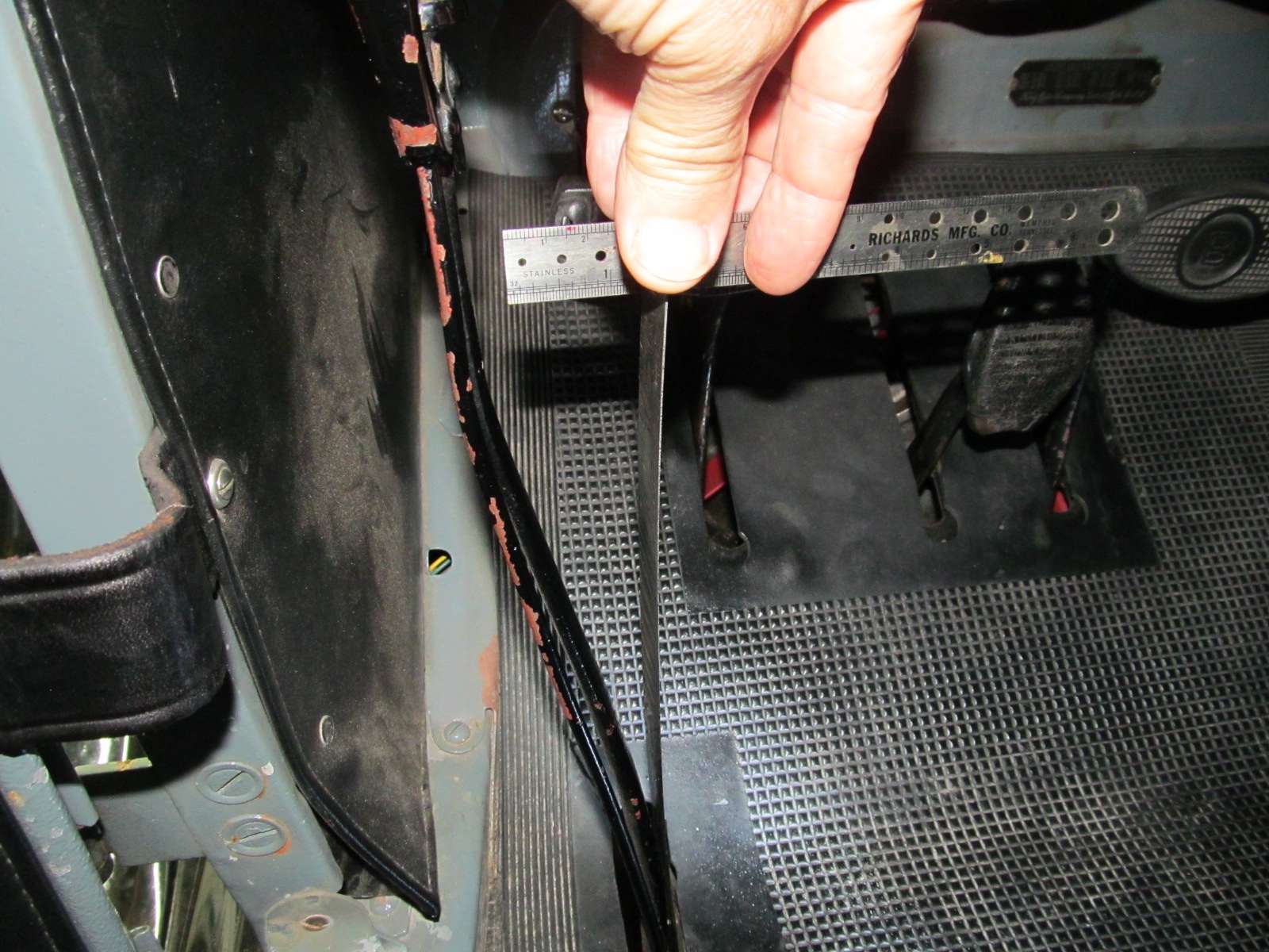

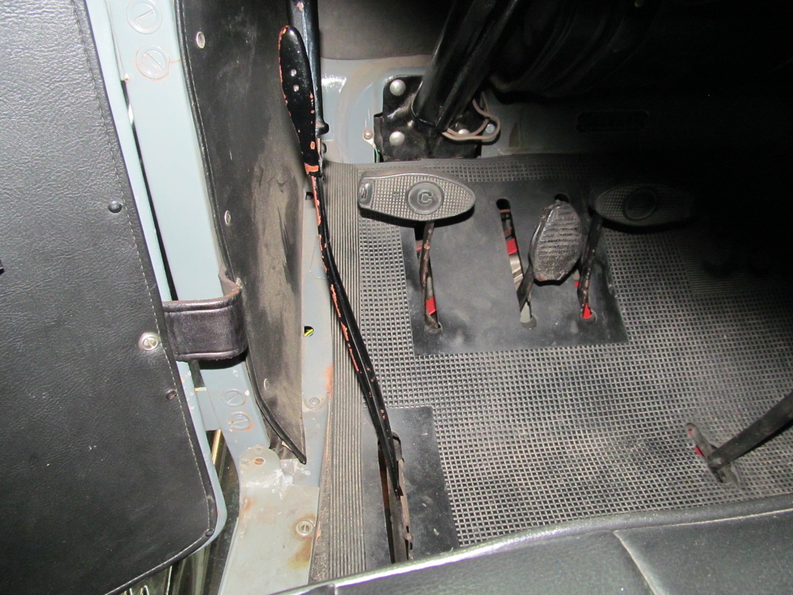

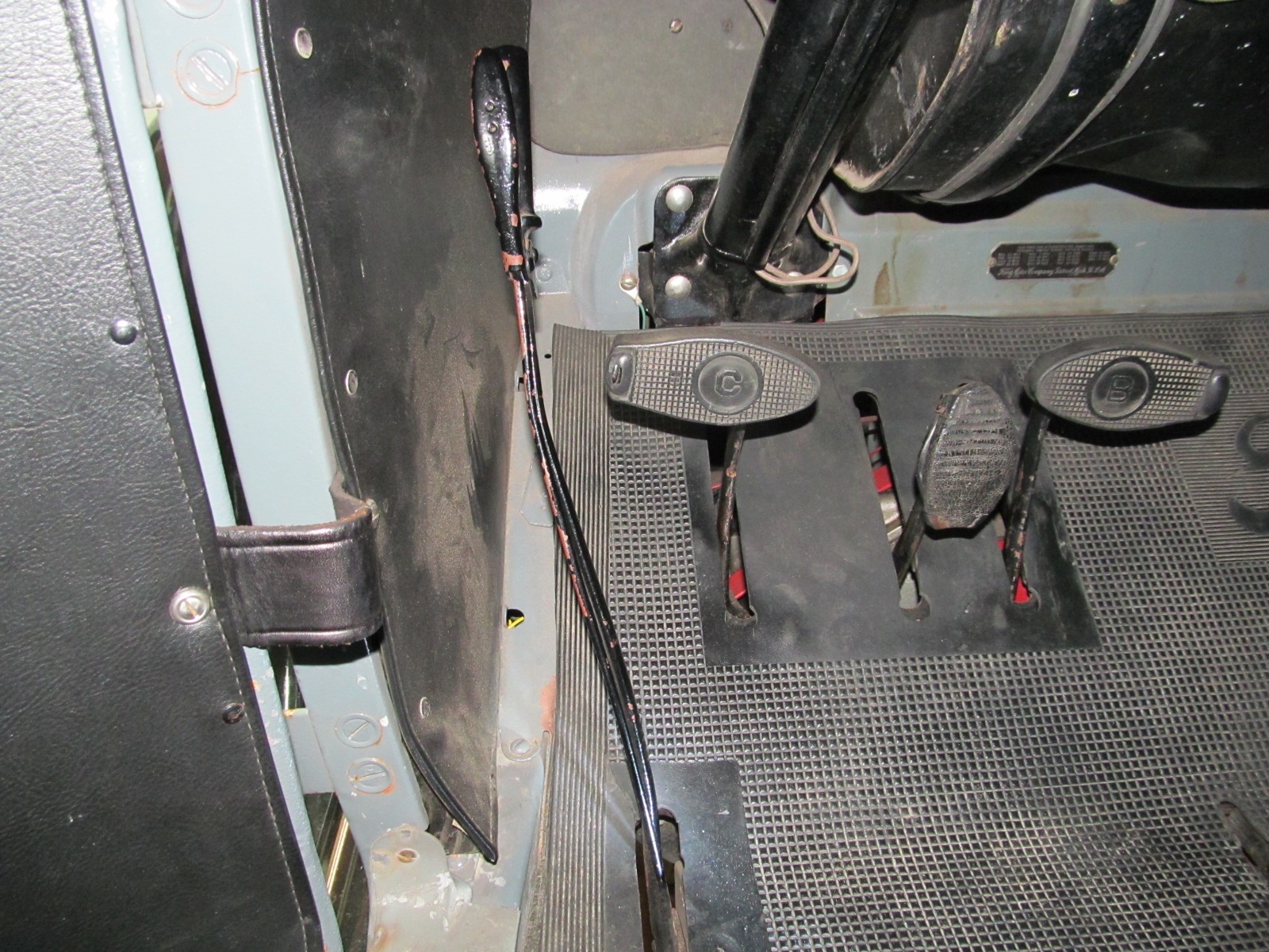

Thanks for the help. Here's the handbrake test installed with long pins thru thru the flipper to hold it in place. The spacing/fit is good but I need to set the pan in the car with the hogdhead and pedals to check for clearance. Sorry for the poor photos.
