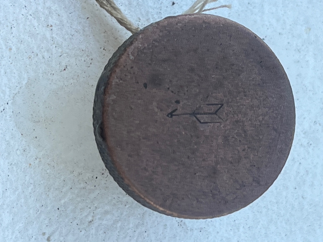

Post by RGould1910 » Sun Jun 23, 2024 9:17 pm
The cap on the carb mixture rod on my 1910 has me puzzled. It is unlike the repos in two respects. First it has a small arrow so the operator can determine the proper setting. Second, and most puzzling is the cap on the underside is recessed much like later later carb needle valve caps. Any information about this style would be appreciated.

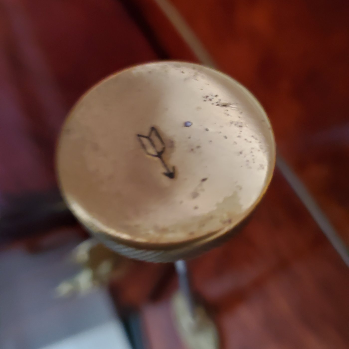

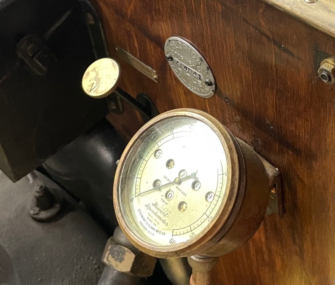

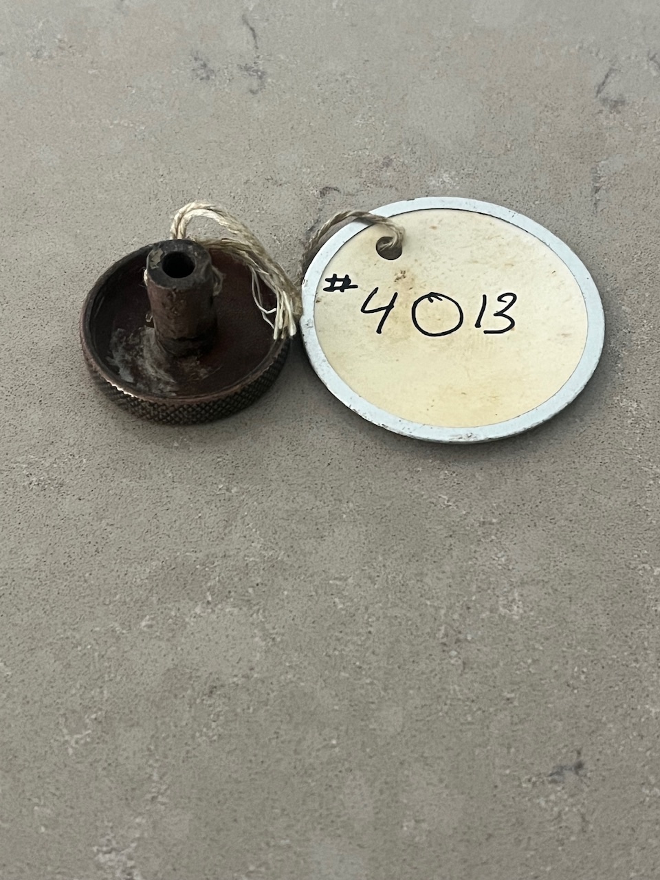

Post by KimDobbins » Mon Jun 24, 2024 11:09 am
This is off 1909 T #4013

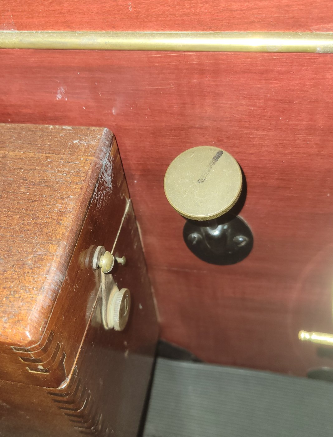

Post by DanTreace » Mon Jun 24, 2024 12:02 pm
Nice to see that early detail of the carb adj. knob. Figured the knob had some marking to note the position, really like that factory 'fletched arrow' :D
Thanks for posting the photos.
The best I could attempt to mimic on my faux '12 open express was to smack the face of the repro knob with the letter V from the stamp set. :?

Post by KWTownsend » Mon Jun 24, 2024 1:20 pm
My 1911 has a Sharpie line...

Post by RGould1910 » Mon Jun 24, 2024 1:58 pm
Thanks Kim, glad to see the recess was used on the early caps.
