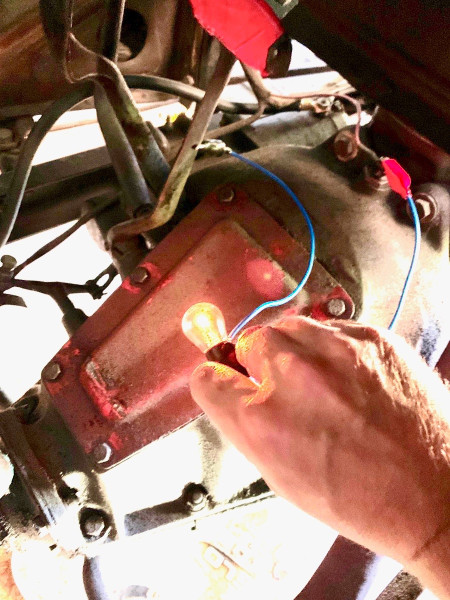

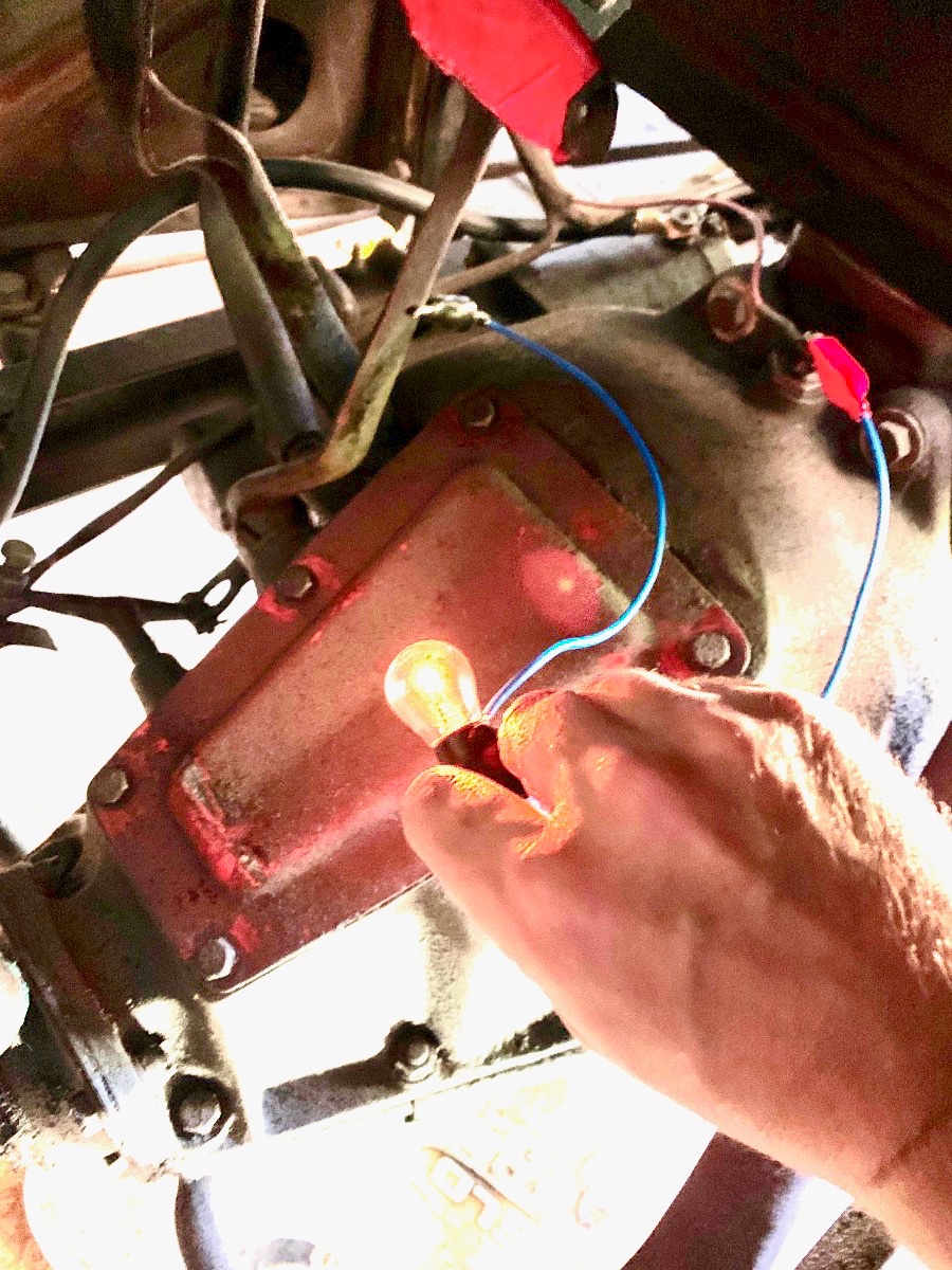

One easy way is to provide a load, 12v stop/tail bulb in a socket, and wire clips to the mag post and to ground. At idle, the lamp should shine, at higher rpms, bright.
If good output, then the wire to switch or the switch to MAG is the issue.

Post by Dan Hatch » Fri Jun 28, 2024 12:11 am
