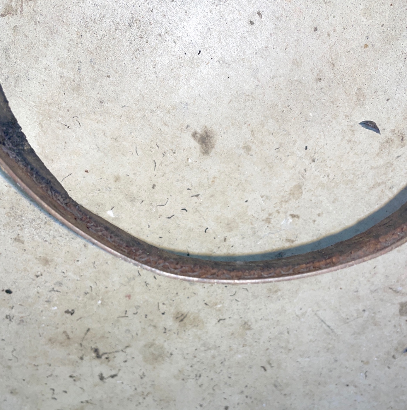

Have removed worn bands with linings that usually show lots of wear right at the bottom of the band, so one would think that a gap of lining there wouldn't be helpful
There were some period designs that used segmented linings, this wood version, but perhaps that is so pieces and not a full round wood lining had to be fabricated. And a soft lining in two sections for replacement ease, that has gaps too. Have seen hinged bands, with gap at bottom.
Might be ok to segment, but in seeing considerable wear at the bottom of full linings on bands, rather choice to me is stay with full circle lining on bands.

I have seen charred kevlar, so I do this now for the constant oil entering the bottom of the band. I do not cut a chunk off the kevlar band, I leave about a 1/4" gap @ the bottom & leave a bit more ear overhang.
"Fortunately" I have no feedback with either as the bands have lasted so much longer(?) I have not had to do replacements yet even for the inexperienced guys. That's all anecdotal, as I dont know how many miles are being driven. I have observed that if they dont break a drum from over adjusting Kevlar, the lining is good for decades.
I have not noticed significant band wear @ the bottom/center of unmodified bands. The worst wear has always been @ the ear ends to the point of needing relining, the middle is still serviceable.
