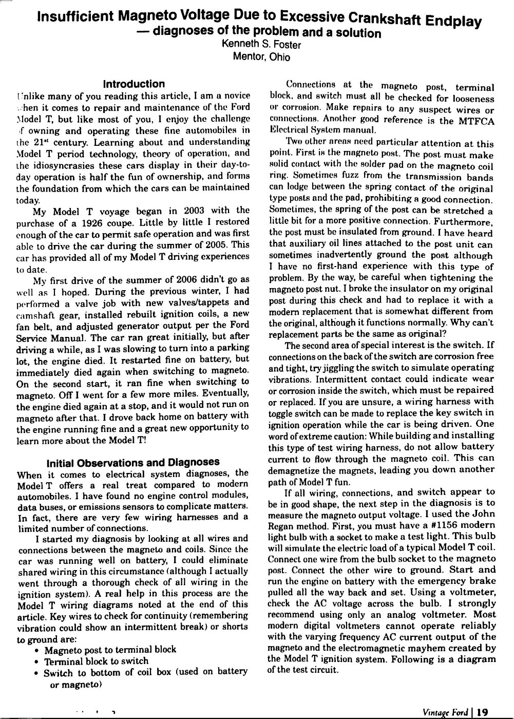

I cannot locate a copy of the article, but ;Check Vintage Ford Volume #42 Number 2 March/April 2007 for a comprehensive technical article on diagnosis of this problem and a detailed solution written by Ken Foster.
If anyone has a an electronic copy I would like a copy for may library.

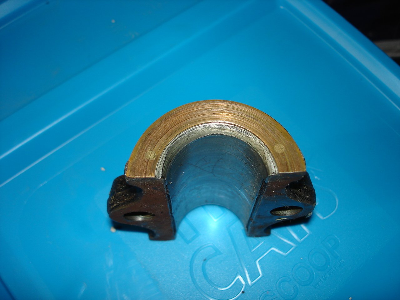

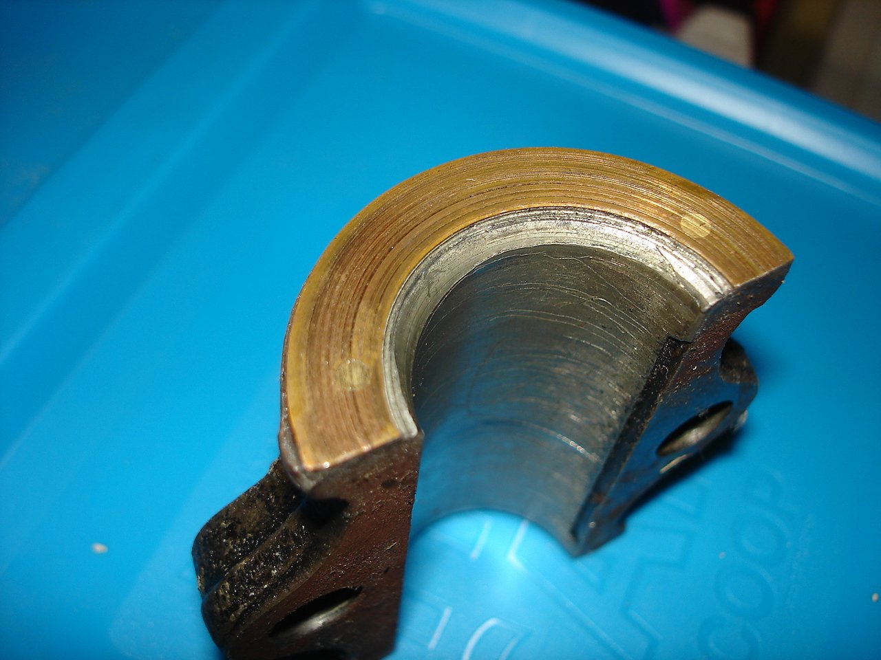

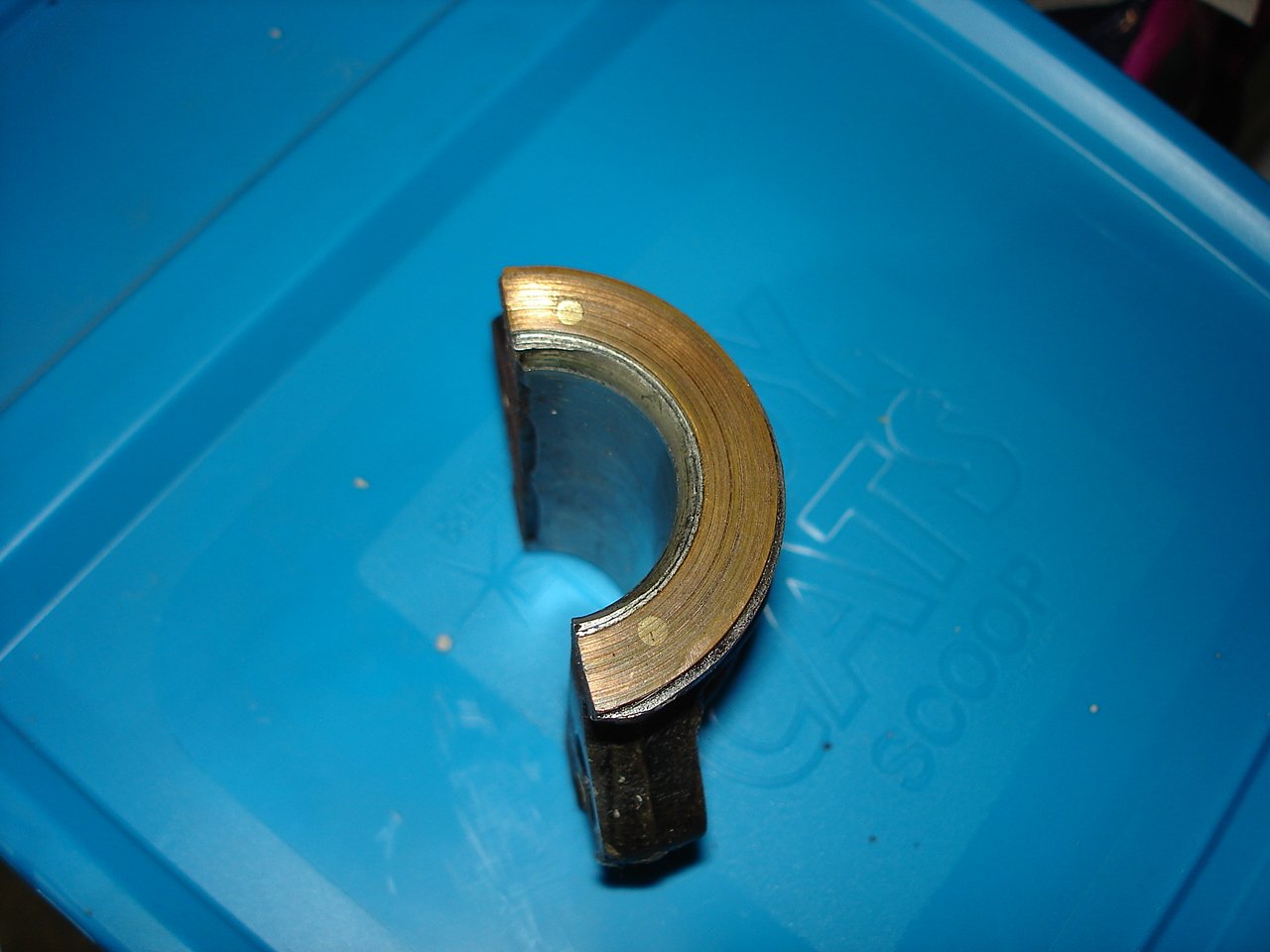

This was my father's approach. This ran for nearly 50 years and was not removed because it wore out.
A bronze wear surface, soldered to the existing babbitt, then screwed in place and everything machined to size.

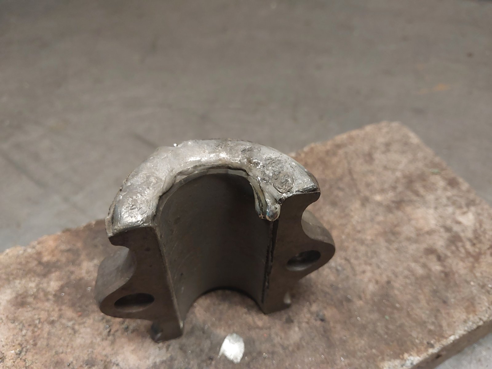

Thank you for all the answers
Today I soldered and processed my bearing shell. I used a small propane flame to do this.
It went pretty well, but I didn't make it pore-free.
What do you think, can I use it like that?
I also machined the pressure surface on the crankshaft to remove the wear.
greetings from Switzerland

- Posts: 4479
Re: Solder babbitt to the bearing shell
Looks fine to me!

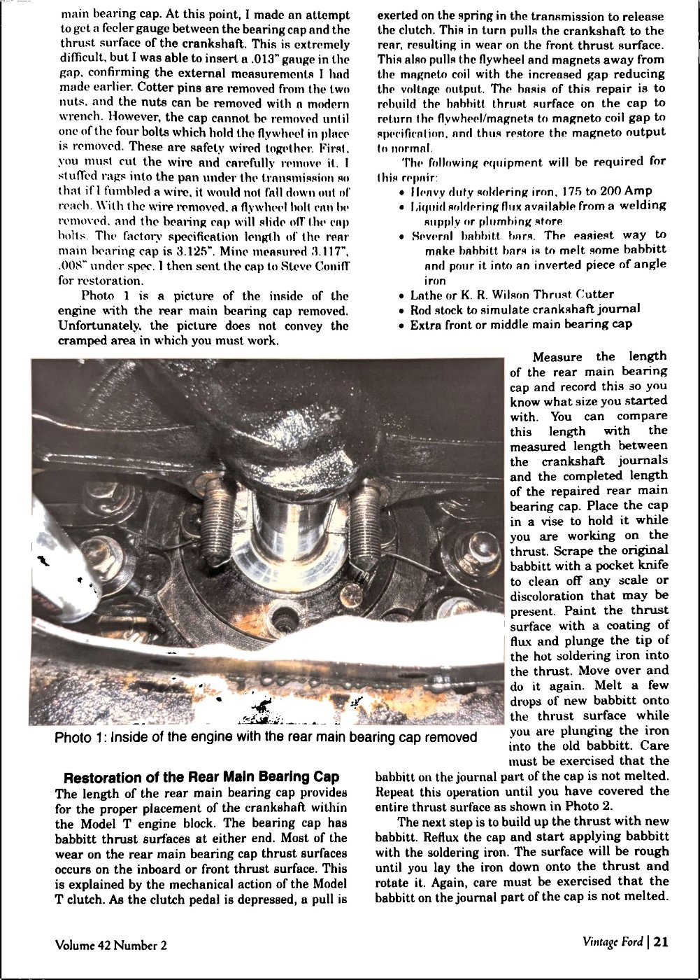

Came across Vol 42, Number 2 .... MARCH/APRIL 2007.
Jerry,Jerry VanOoteghem wrote: ↑Sat Jul 06, 2024 7:34 amThis was my father's approach. This ran for nearly 50 years and was not removed because it wore out.
That's a very neatly done improvement. That you've got evidence of it's longevity, presumably in reasonably regular use (?), adds to its attraction - in your experience had it had any adverse affect on the crank thrust face?
Beat,
Nice job on the crank surfacing. IMV minor pitting on the cap thrust face is not a bad thing and I'd be happy to use it IF I was certain the babbit was well adhered to the cap and the pitting/porosity wasn't the result of poor material or significant foreign material in the mix.
Robert,
Good on you for finding the article, hope you don't mind but I've taken your images and sorted them out a bit here...
Ron, I've got this in a PDF now if you'd like it? Will send you an email.Ron Patterson wrote: ↑Fri Jul 05, 2024 9:07 pm

- Posts: 4479
You can see some slight grooving in the face of the bronze. The crank has the same slight grooves to match but otherwise no deep wear groove. The car is used every year on various tours. (In fact, except for the WWII years when dad was "away", it has been driven every year of its existance.)Luke wrote: ↑Sat Jul 06, 2024 11:52 pmJerry,Jerry VanOoteghem wrote: ↑Sat Jul 06, 2024 7:34 amThis was my father's approach. This ran for nearly 50 years and was not removed because it wore out.

Luke... Thanks very much. It was late at night when I posted
This is a pdf version of the Ken Foster article.
