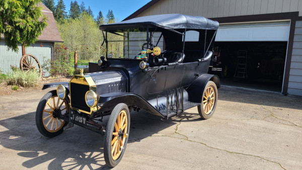

I purchased a top from Classtique Upholstery, and I am now looking at getting it put on.
I am nervous about doing this myself.
Is there anyone in the Vancouver, Washington / Portland, Oregon area that I could take the kit to and have them install it?
If there aren't any recommendations for a shop to do it, is there anyone in my region that would like to lend a helping hand.
I am pretty handy. My wife and I did the upholstery on the seats a year ago, they turned out pretty good.
I know that this is a long shot, but I thought that I would ask.

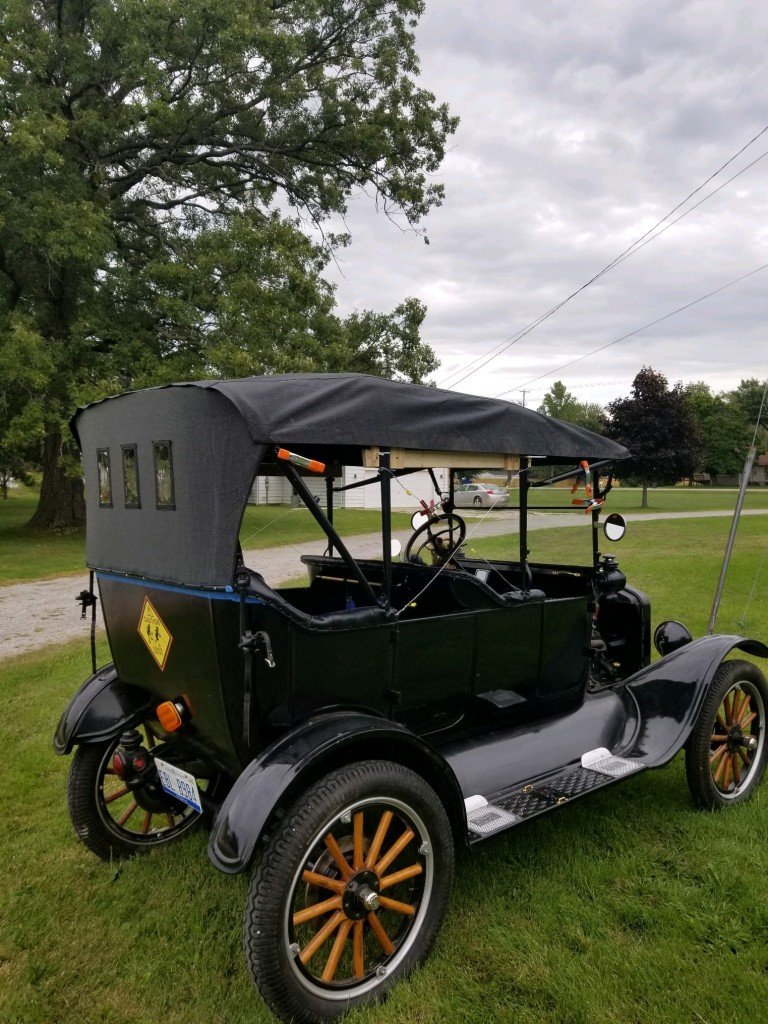

I had my 1917 top installed by a pro who had done it many times before. He showed me that the key is to set up the framework exactly where you want it, using wire, clamps and thin wood braces, etc. Once the frame is set you place the pads and then stretch the top over and commence to attaching it. If I remember correctly you leave the back until last. You want to stretch it when it's warm to soften the top. He prefers to do that part outside on a sunny day.
If your bows aren't wrapped you will have to do that first. My wife sewed a sleeve which i was able to pull over the bows and secure in place. She cut the fabric on the bias so it wouldn't wrinkle in the curves. I don't see any bows in your photo. I had sockets but no bows. I bought a beautiful set from Jonathon Anderson that were marked showing how far into the socket they had to be mounted. Speaking of sockets, I removed the old rotten wood from the bottom of each socket and filled the section below where the bows fit with epoxy resin. It protects from rust and adds a lot of strength - important if the sockets are old and thinned somewhat from rust,

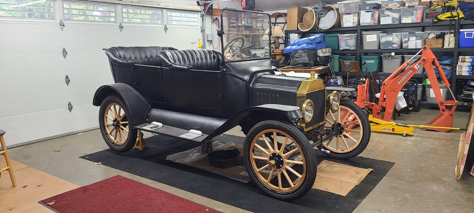

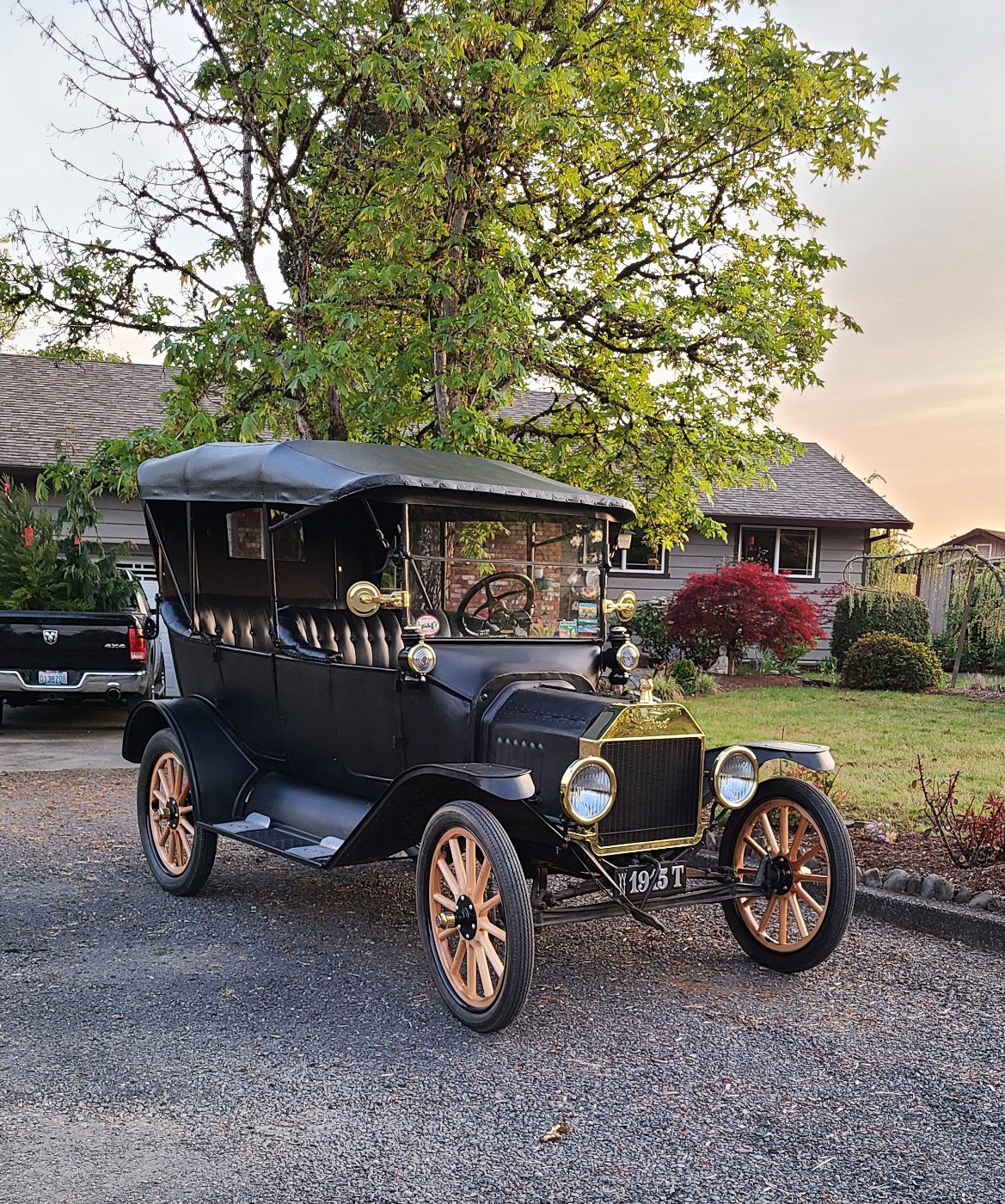

Well, I finally went for it. It has been done for a while now; I am just getting back to the forum to post about it.
Thank you everyone for your encouragement. You were right, it wasn't hard, just a new process to me so I went slow.
It came out pretty good. I see a few mistakes that I would do differently, but it looks pretty good.

That looks great, Michael! Great job!

Sure is a neat job. Much better than some I have seen. Well done.

Looks great.
