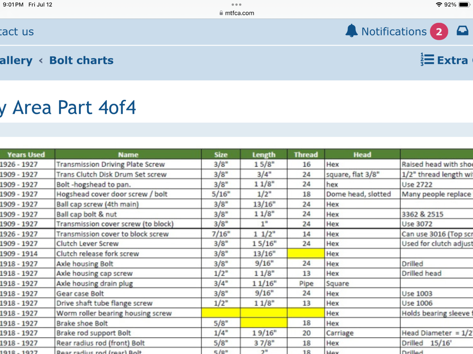

On right top corner of this Forum page is the camera icon for Gallery, open that and scroll to Bolt Charts. Lots of thread and length info and where used.
Sample part of Gallery pages showing ball cap screw 4th main.

I believe the 4 bolts at the fourth main are 3/8-24.

There are quite a few errors on this bolt chart.

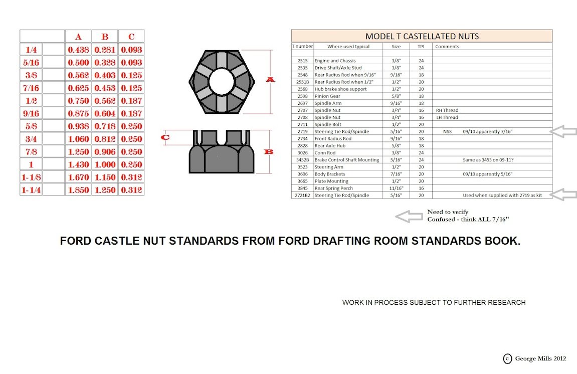

Back to your question: Remember, two of the bolts on the 4th main have drilled heads for safety wire - the other two are drilled for castle nuts and cotter pins.

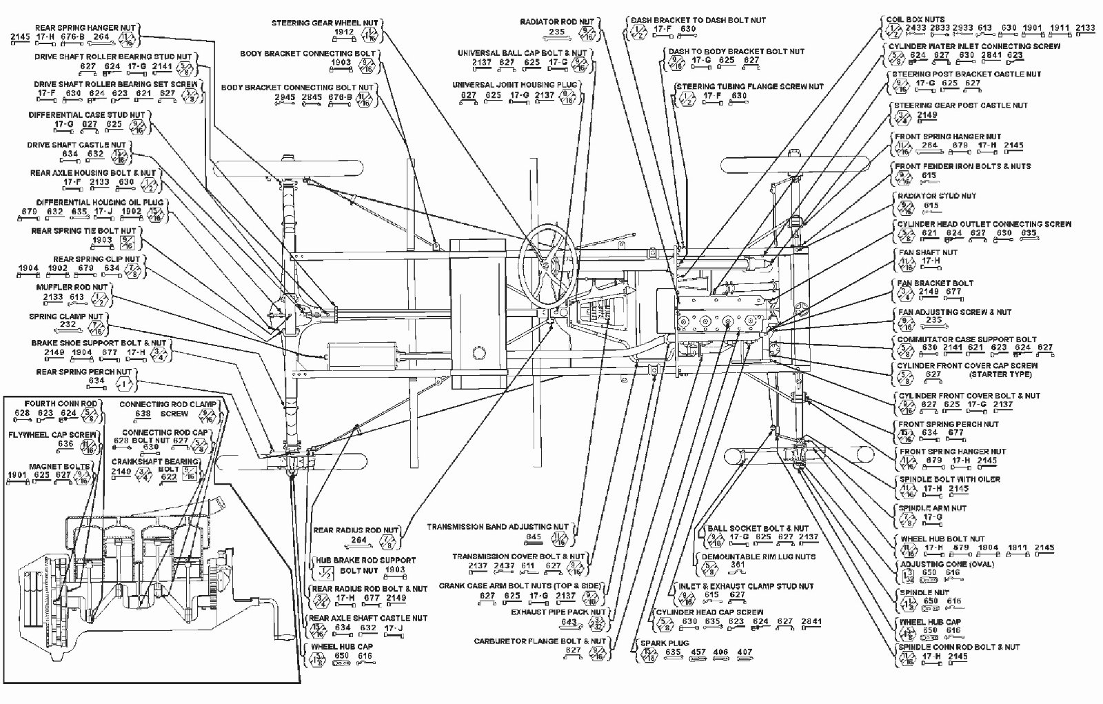

Shape helps ID too
This chart identifies tool part numbers and the size of the bolts' head/nut
