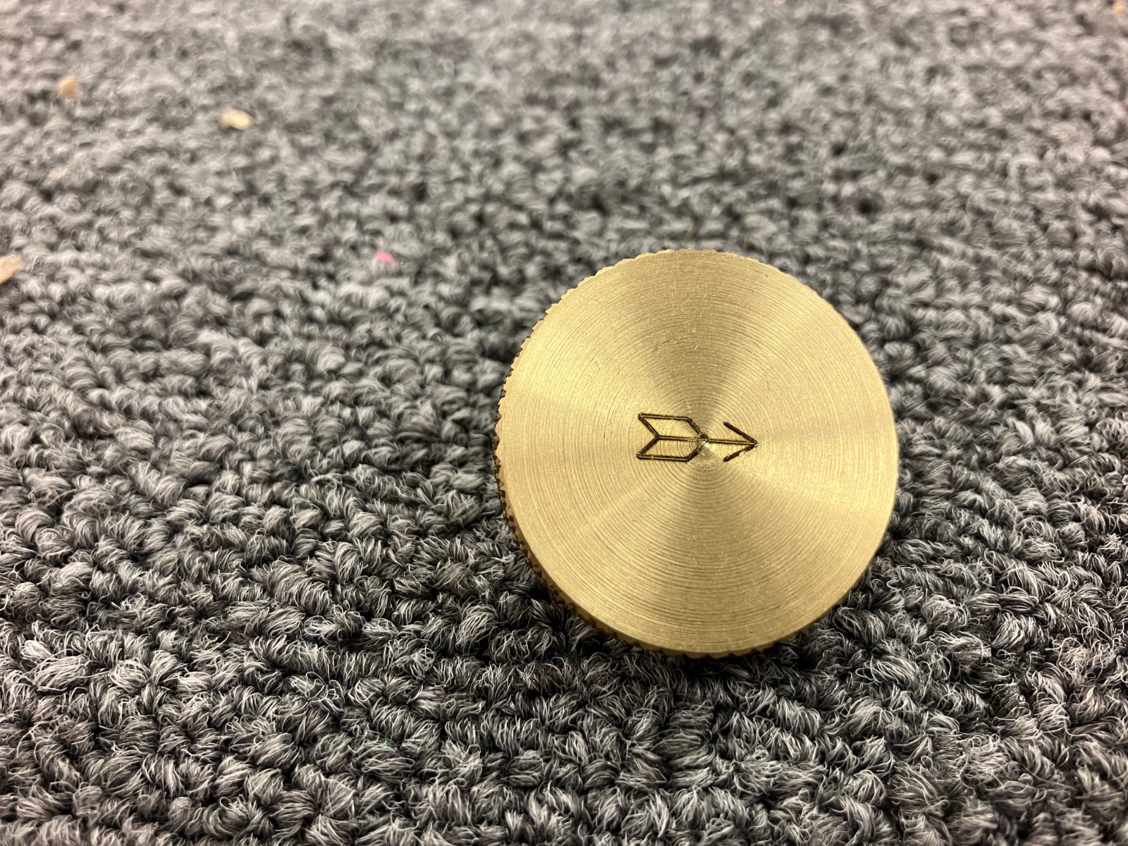

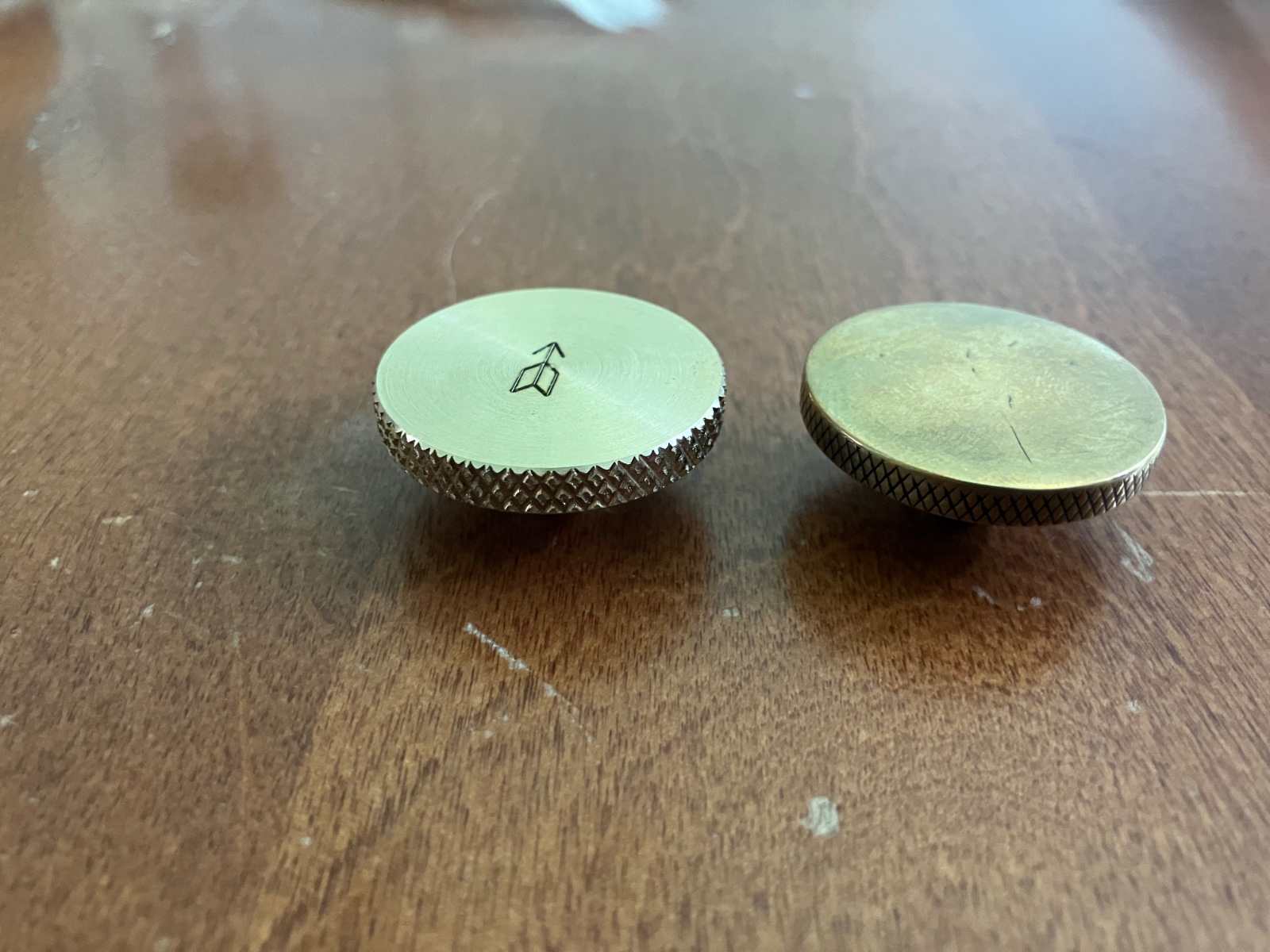

I’m making a run of some carb adjustment knobs with the arrow. I’m using an original knob for specifications.
I already made a small run of these to work out the details. I already need to correct the knurling as it’s a little bit too coarse. I wanted to see if any one else would like to have one… obviously the more people who want one the less the cost would be. I do not have a cost as of yet.

Its patterned after an original I have on my 1910. The difference between mine and Mikes is mine has a recessed area underneath. Im told the caps for 1911 forward did not have the recess.

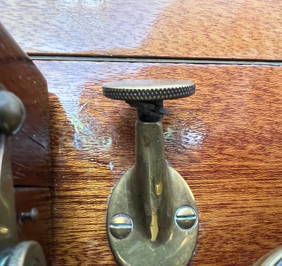

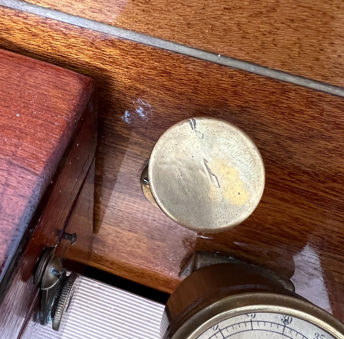

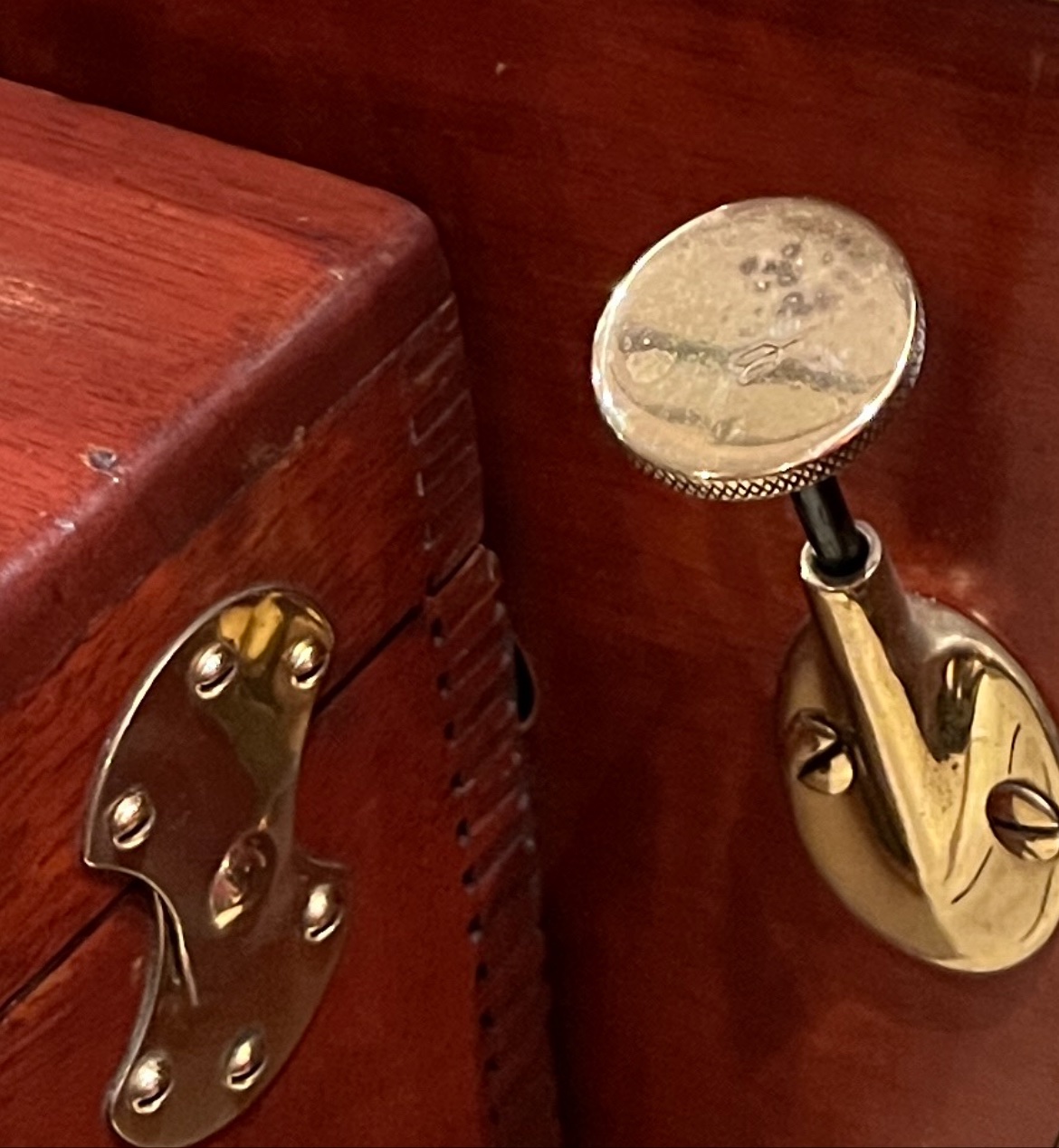

Here are pictures of the carb knobs on two original 1911 model year cars, a July and May car both with the two screw mount on the firewall.
I can't speak explicitly for 1910 cars but my understanding is that the earlier knobs may have an undercut in them.
The photos I am attaching are both flat on the bottom and both include the arrows. over the years polishing has slightly diminished them, but they are both clearly visible.
The arrows do not seem to have a great deal of consistency in their location, but they are stamped and can be used as an estimate for your mixture.
