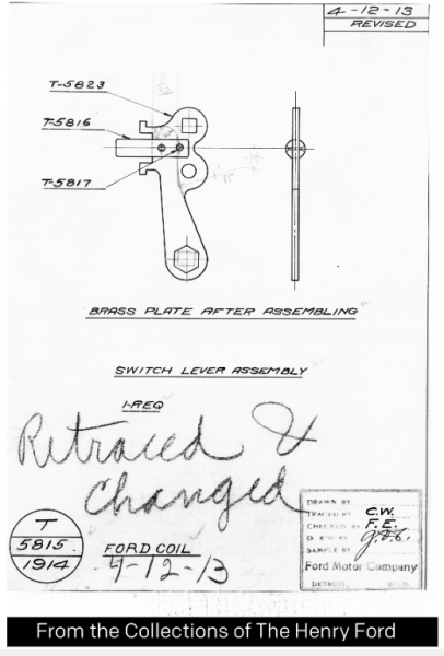

When did Ford switch the design of the 1914 key to the flat version?
- Posts: 4057
Re: Model T Key

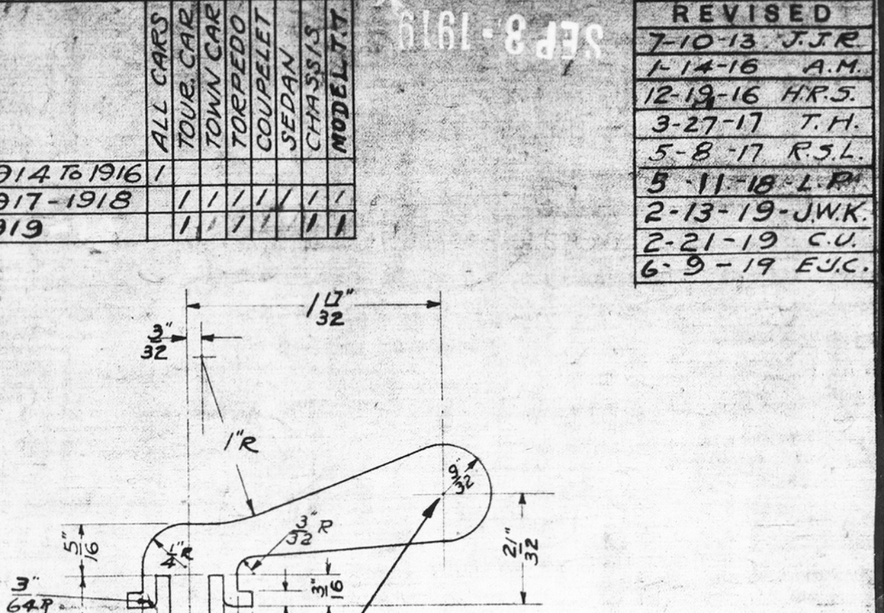

T-5815 drawing print for 2-piece coil box key was re-drawn on 4-12-1913, but noted for 1914.
Then the new T-5815-A, the one piece coil box flat key , shown on drawing print with first revision date 7-10-1913, notes for use 1914 and later.
That new one piece design was noted in Rev 5-8-1917, according to Trent Boggess, so the flat one piece was introduced mid 1917.
corrected post 7/23/24

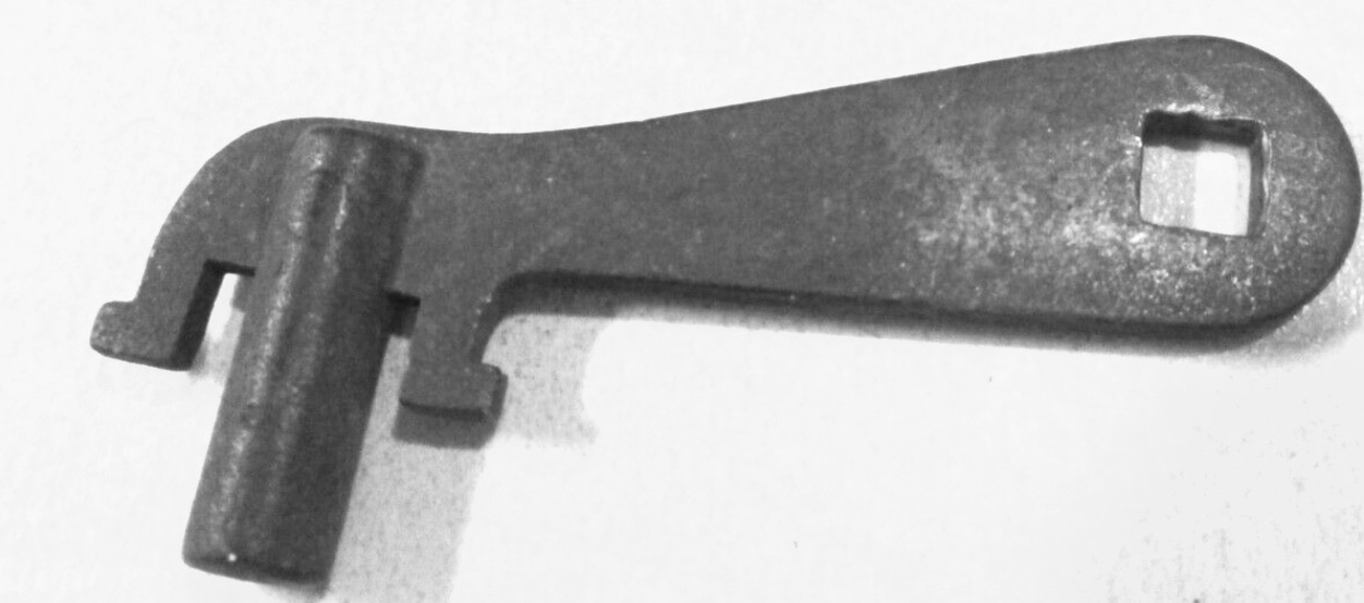

Re: Model T Key
Dont know if Ive ever seen a two piece key. Is it the style with the round center prong?

Re: Model T Key
Yep, has round center stud.RGould1910 wrote: ↑Mon Jul 22, 2024 5:04 pmDont know if Ive ever seen a two piece key. Is it the style with the round center prong?

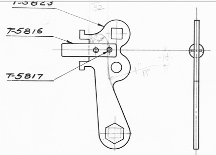

Interesting the print of the 2 piece shows ghost of pencil change that modified the handle of the 2 piece, to be more plain.
From the Collections of The Henry Ford.
The right box on the drawing print of the One-piece key is the Record of Change, which correctly I.d.s the changes to the print.
So Trent stated the flat one - piece style came out with that 1917 change note.
2-piece key

Then, why is Dan saying the flat key came out in late 13? I like what Trent is saying better!
- Posts: 4057
Re: Model T Key
LarryOriginal Smith wrote: ↑Tue Jul 23, 2024 12:03 amThen, why is Dan saying the flat key came out in late 13? I like what Trent is saying better!
See my comment in last post, Trent had access to the Records of Changes, my observation on date was the drawing first date, which is incorrect.
The Record of Changes have the design changes, and usage changes dates, Trent obviously reviewed those for his article. Didn’t think to look up his article in the encyl. , just replied with date of print copy in my photo files.

Re: Model T Key
It appears to me the first 1914 style keys are really 3 piece if you count the pin.

The 4-12-13 drawing revision.
- Attachments
- key print.png (159.06 KiB) Viewed 2290 times
