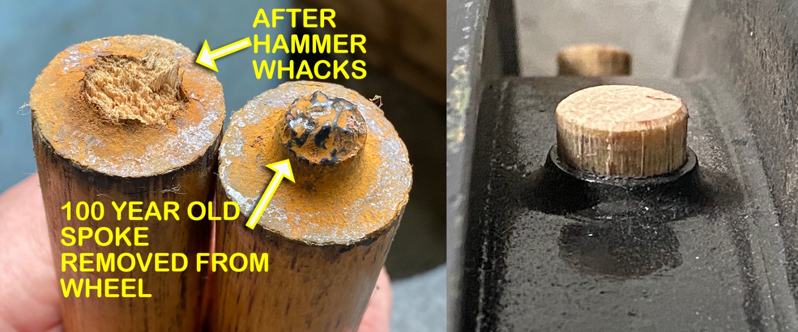

Norm paints a picture that should scare any of us who have problematic wheels. My experience with loose spokes was an eye-opener. The ends of the tenons looked like warts where they had slowly rotted away over a century. A couple of sharp raps with a rubber mallet and I was able to shear one of them right off. I've attached a photo showing the aforementioned tenons and what they look like when they come back from Stutzman. Varnishing or painting the tenons will help slow moisture from damaging the new ones. [see photo]
I've had three wheels rebuilt by Noah Stutzman and am very satisfied - you might call and see what kind of turn-around he can offer. Being Amish, you leave a message and he'll call you back (330) 897-1391. Of course there are other wheel rebuilders who do a great job. I just haven't had any experience with them. I've been to Noah's shop and seen him at work.... a true craftsman - well-equipped to build almost any wheel.
