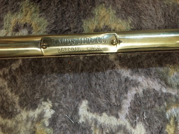

Post by Jones in Aiken SC » Mon Aug 05, 2024 6:19 pm
On a 1912 Rands windshield frame, where is the Rands tag located? I always assumed it was on the top inside but then saw this picture of a nicely restored 1912 where the tag is on the bottom on the outside. What is correct?

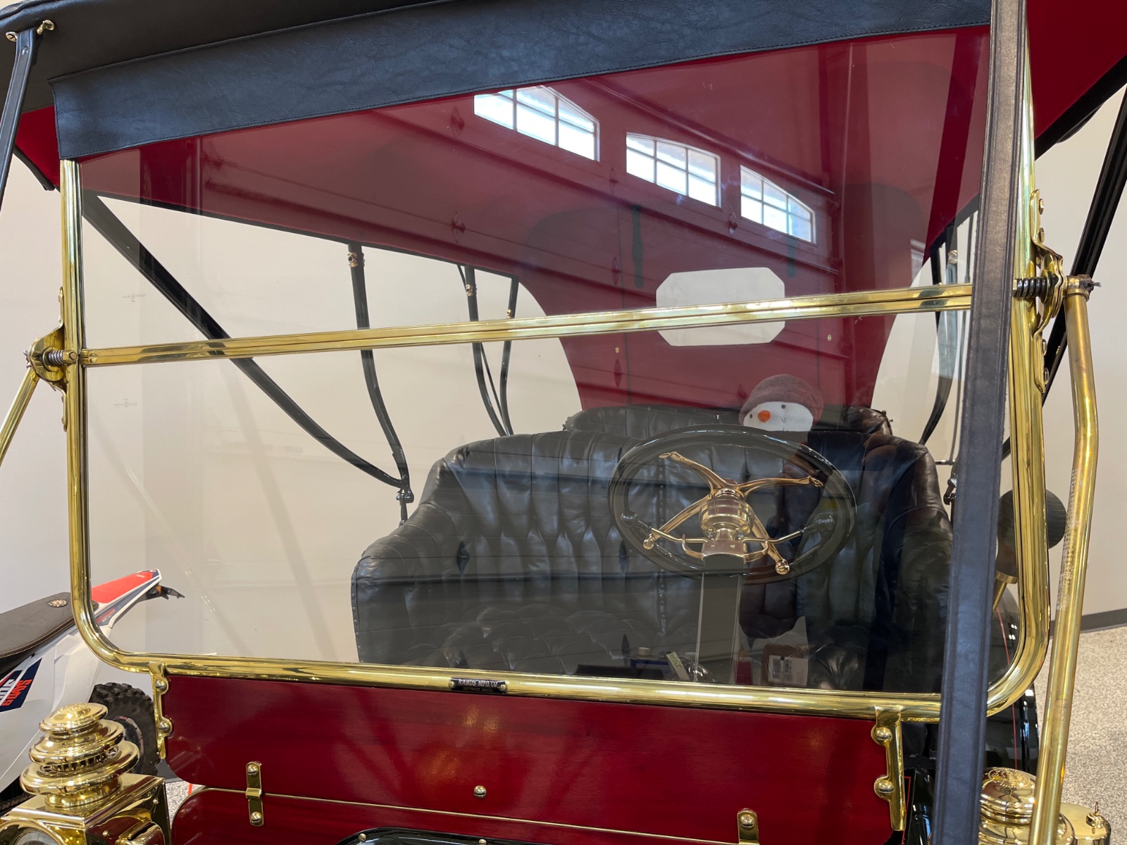

Post by pete eastwood » Wed Aug 07, 2024 1:15 am

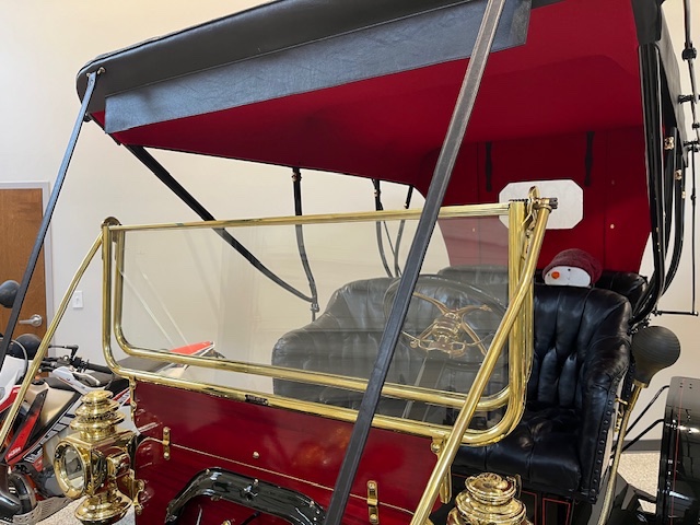

Rod, this windshield is on backwards.
The hinges should be oriented so the windshield fold to the rear.

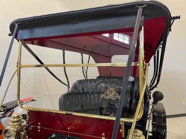

Post by Rod » Wed Aug 07, 2024 1:47 pm
Is this better?

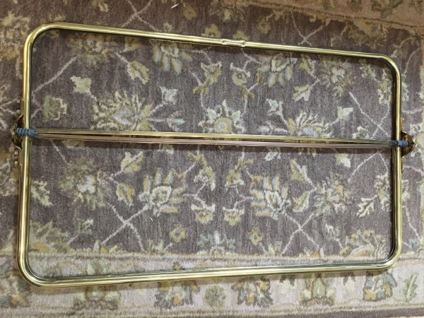

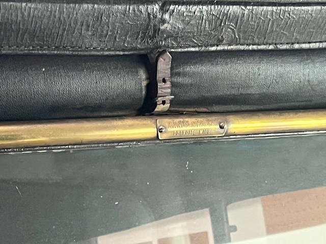

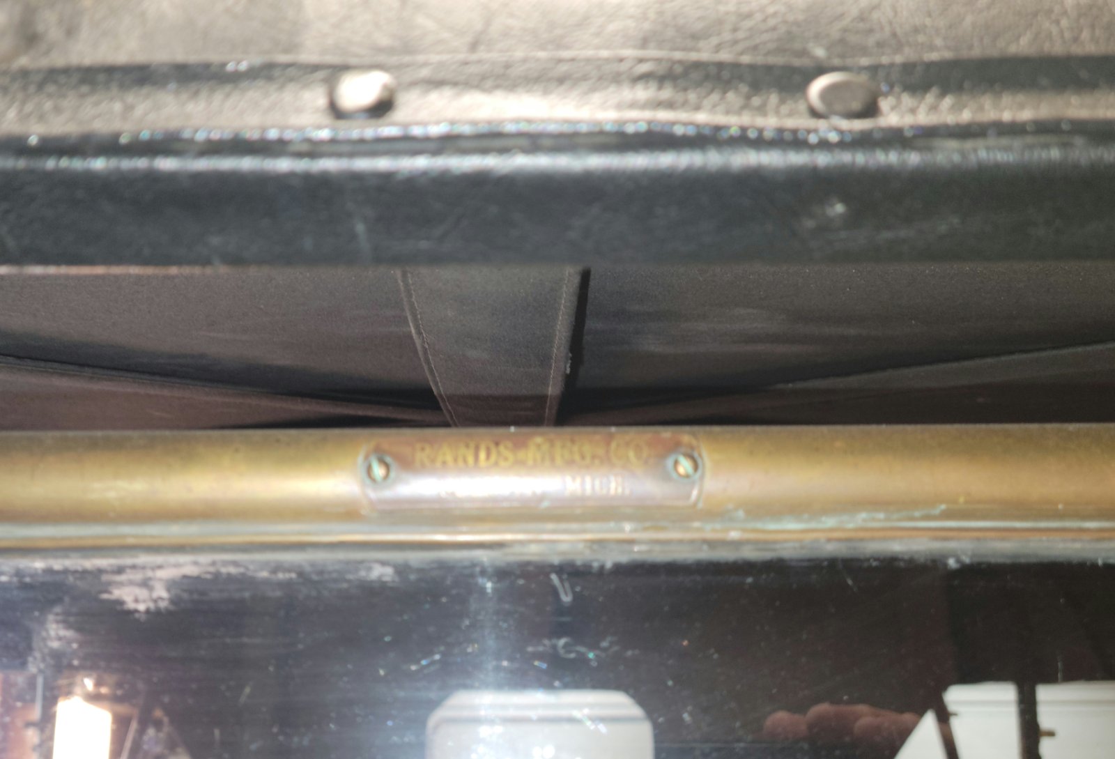

I have an original complete Rands windshield frame that does not appear to ever have been taken apart. The Rands tag is on the top, on the inside. I also have other parts of frames, some with the tag, that would read upside down if on the bottom. So I know what I am going to do for my car. But I also understand those early frames could have a lot of variability so I am not picking on anyone for "being incorrect."
To some this might seem like an anal detail, but hey, when you are restoring an early brass car you think about these things.

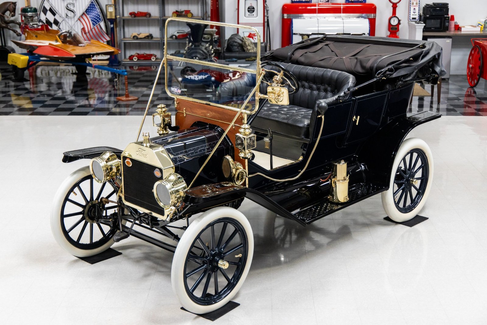

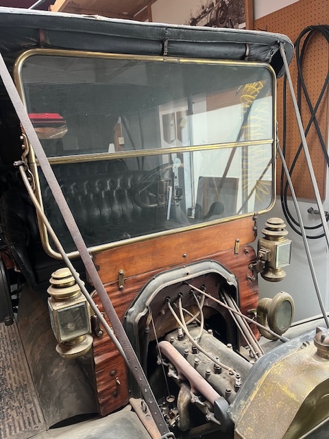

This is one that I had a few years ago, that I sold on the forum. It was an original with the lower pane being larger than the top half. It had an original Rands tag on it located on the top on in the inside...
I don't know who the caretaker is of Phil Mino's unrestored 11 but that would be a great source to check.
There use to be a website of his car, but no longer.

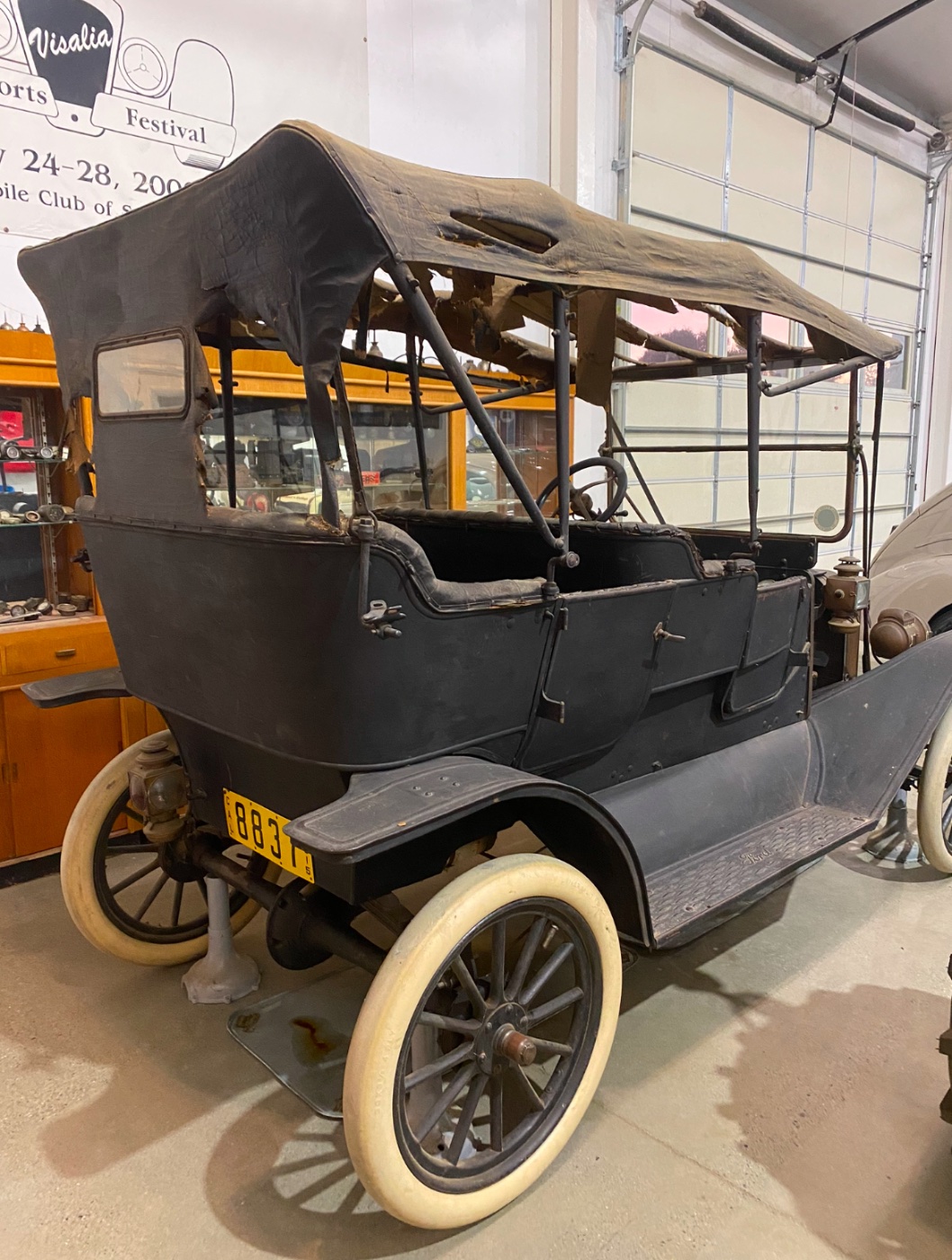

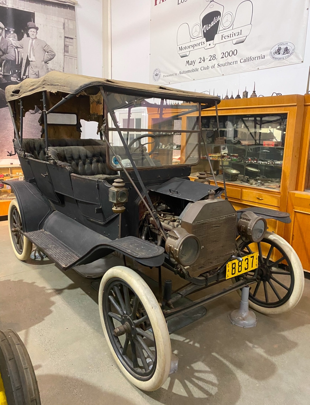

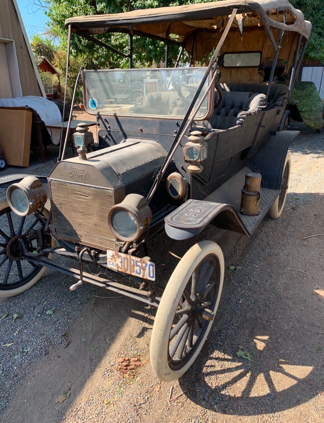

Im the caretaker of Phil Mino's 1911. I could check if you still need this information.
Jones in Aiken SC
Posts: 246
First Name: Gregory
Last Name: Jones
Location: Aiken
Re: 1912 Rands Windshield Frame Tag
Post by Jones in Aiken SC » Sat Jan 25, 2025 11:36 am
I''d sure be interested in where that tag appears on that lovely original car!

just looking through the old photos of the car here are two. I'll have to go look in person as well. I don't see it.

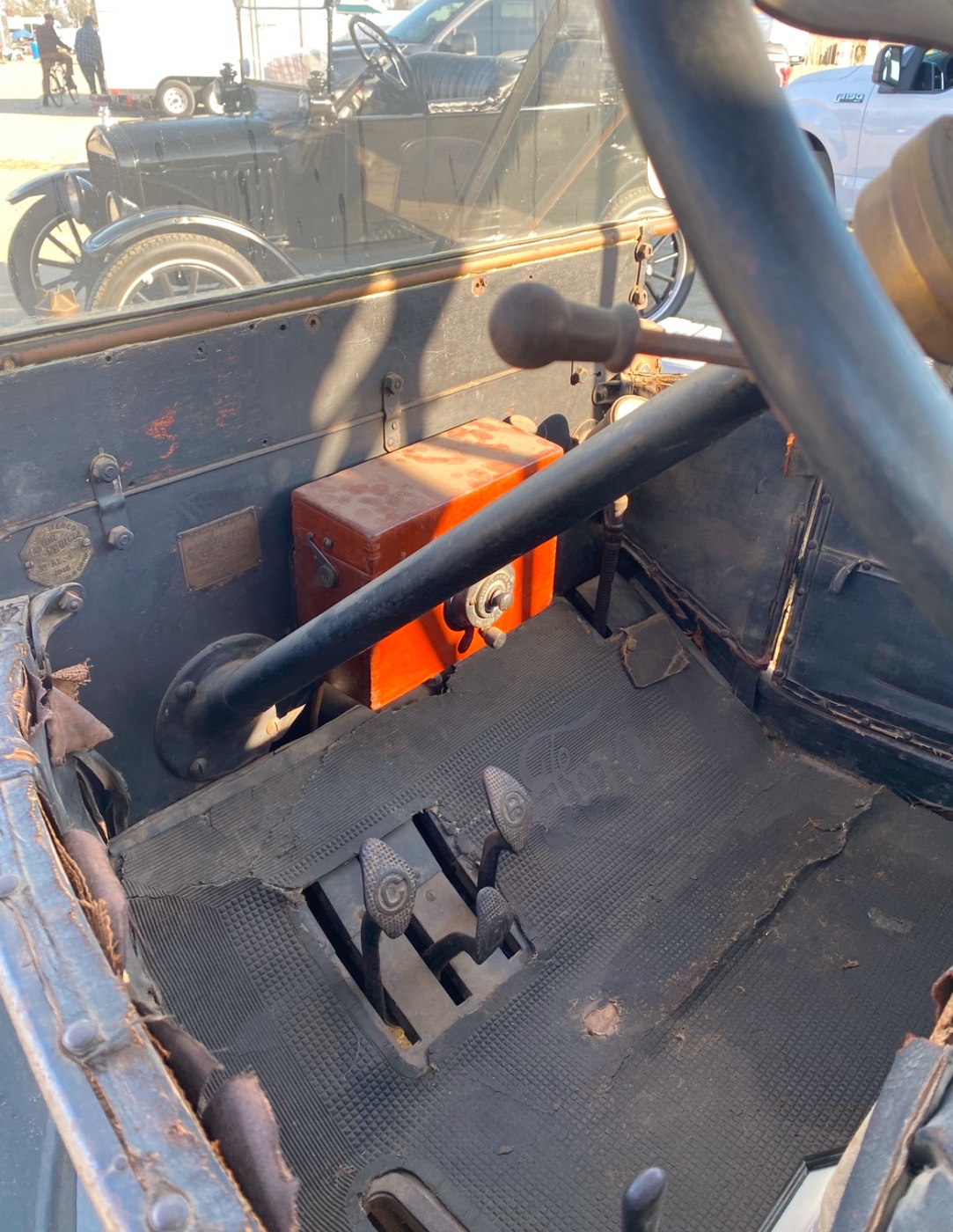

sidenote: YES....... I have the original coil box. Phil changed that to get it to run in 1992. I need to change it back. The probability of it being ran much is now minimal since its become fragile. Specifically the top... the engine is tired but has never had any major work done to it and is for the most part as it came from the factory.

I have a skillions detail pictures of Phil's car. The tag is not on either the front or back of the bottom half. It may be on the top half.
