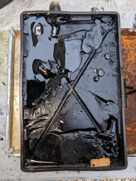

Has anyone here ever attempted to rebuild one of the newer reproduction plastic type coils? I have accumulated a few and wondering about the internal construction. After taking the back off one it is fully loaded with black pitch and I am unsure as to where to start digging and what to expect is different to the standard wooden coil layout? The capacitor reading is showing all are poor so they require new capacitors. Any comment ,advice or pictures appreciated.

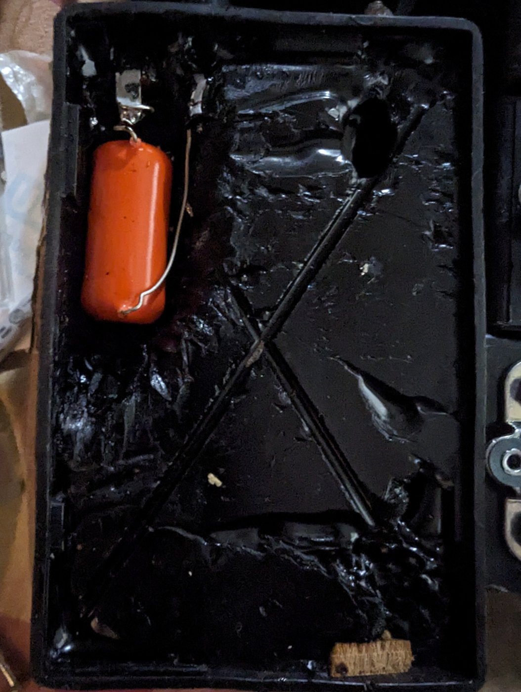

Those plastic encased coils were built with short cylindrical capacitors that were mounted very close to the internal terminals compared to the Ford standard capacitor. The potting tar compared to Ford usage I could compare to being very dense and rubbery and does not chip out as easy. Care has to be taken to concentrate in that upper left quadrant to remove the faulty capacitor, to fit the new capacitor and just properly solder in place. I do have pictures , but having problems to post here at this time.

New capacitor, note tar hard rubber consistency

After repotting
