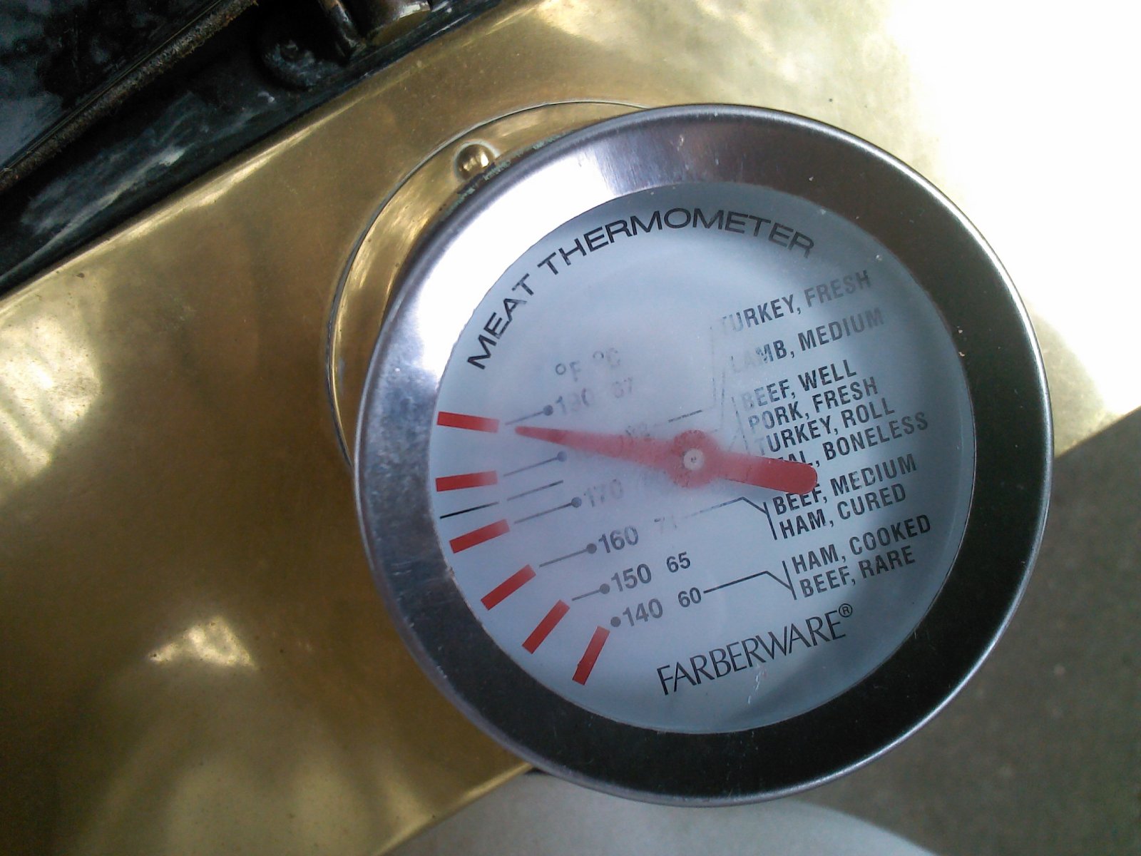

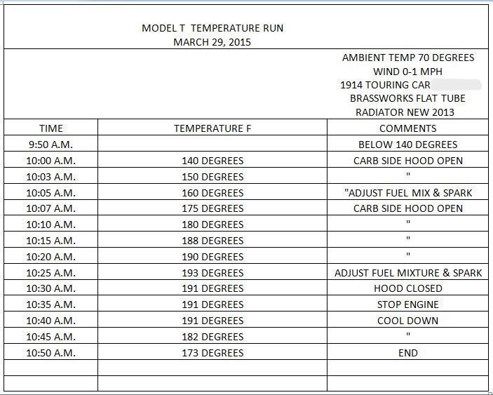

Easy check on your radiator, timing and fuel settings......
See what the temperature of your coolant really is. You can do that running at idle in your driveway.
Never had a Motormeter but you're probably fine. The car is designed to run near 200 degrees.
I run 50/50 antifreeze in my July 1913 engine and used a kitchen thermometer that I have checked on the
stove. A "boiling water" on the stove point showed well beyond my "in radiator" temps.
Ran it, starting from cool, sitting in my driveway for an hour. Just don't set it up with a "tailwind" because
the radiator/engine needs the fan at "idle" and very slow speed. As others have said, fan not needed at speed.
Ran a little cooler with the hood closed.
This was done years ago at 70 degrees ambient but the car just doesn't boil, even today at 90+ in Houston.
It will "glurk" once or twice when I come back from a drive but that's it. No loss of coolant.

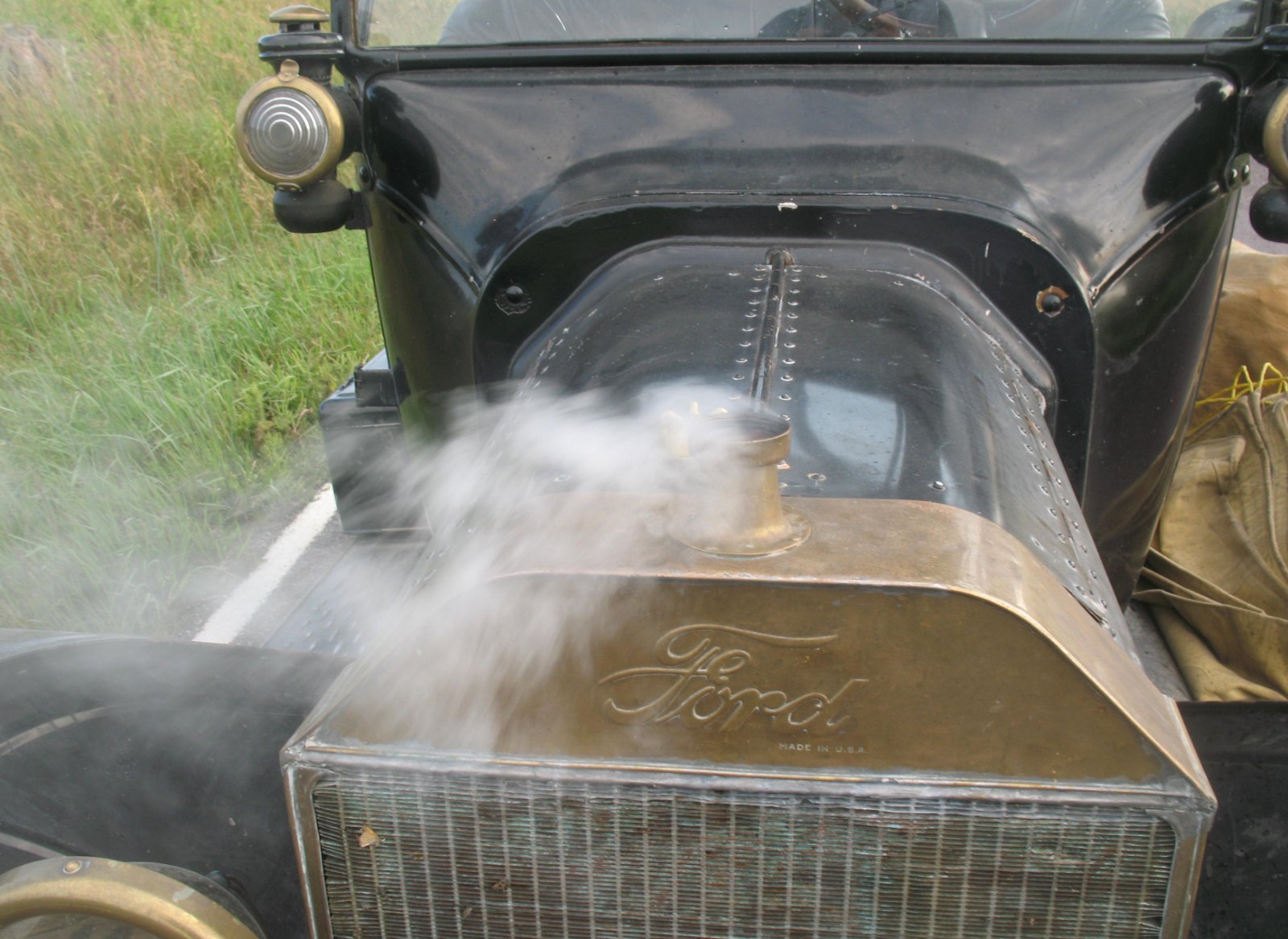

There are many approaches to an overheating Model T. Some of them will help for awhile, but are ultimately futile due to the passage of time. Over the course of a century the fins of a radiator can work loose from the tubes, so they no longer radiate as they should. The only true cure is replacement, which can be done three ways. You can gamble on a used radiator, but that brings up an important question: Why isn't it still on a car? The second choice is to buy a new radiator. A third choice is to have an original radiator recored. If you can find a qualified radiator shop, this will do the job and save you several hundred dollars. Looking at brass era Fords at the Old Car Fesitval, you will see that buying new is the most popular choice. At one recent OCF I found that my 1915 and one other brass era Ford had obvious recores. All the other brass era radiators were new. If I had the choice again I would go with the recore. The only problem I ever had with mine was a leak at the overflow tube. An old radiator guy knew what to do, and I was back to driving the same day.
https://dauntlessgeezer.com/DG96.html
Leak at the overflow tube.
He had me back on the road PDQ.
