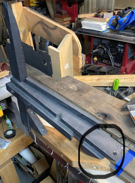

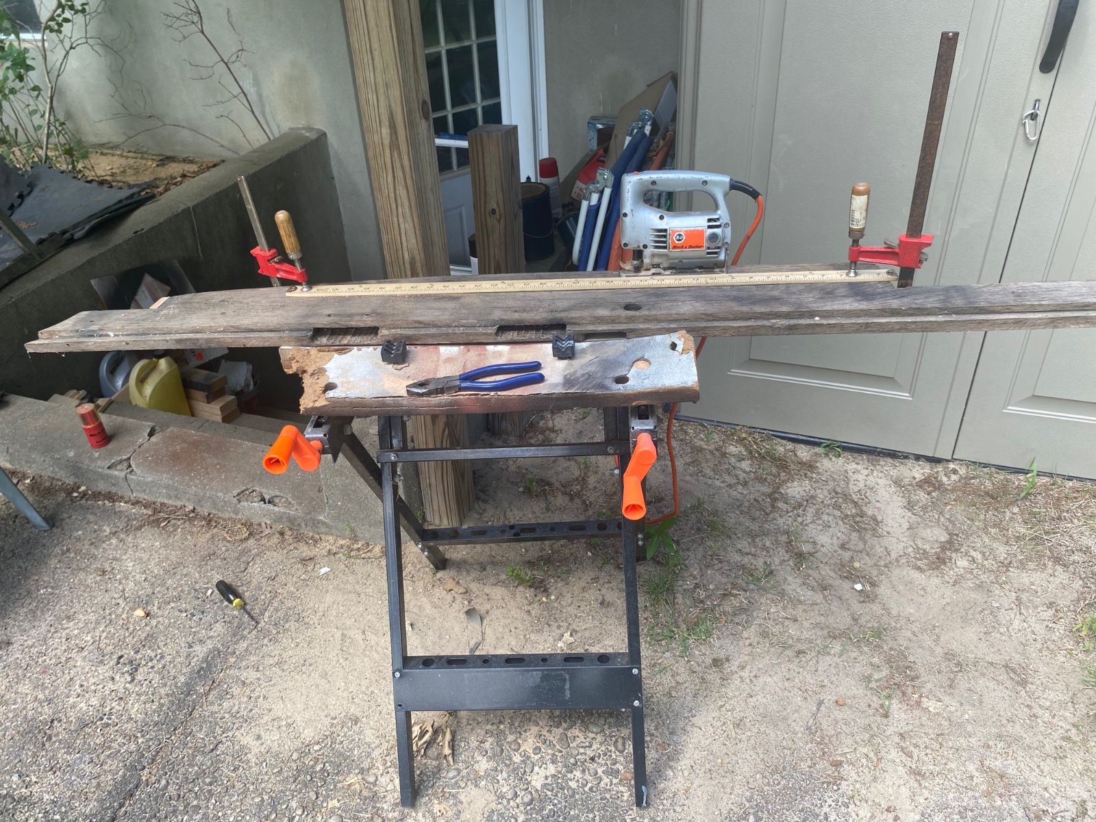

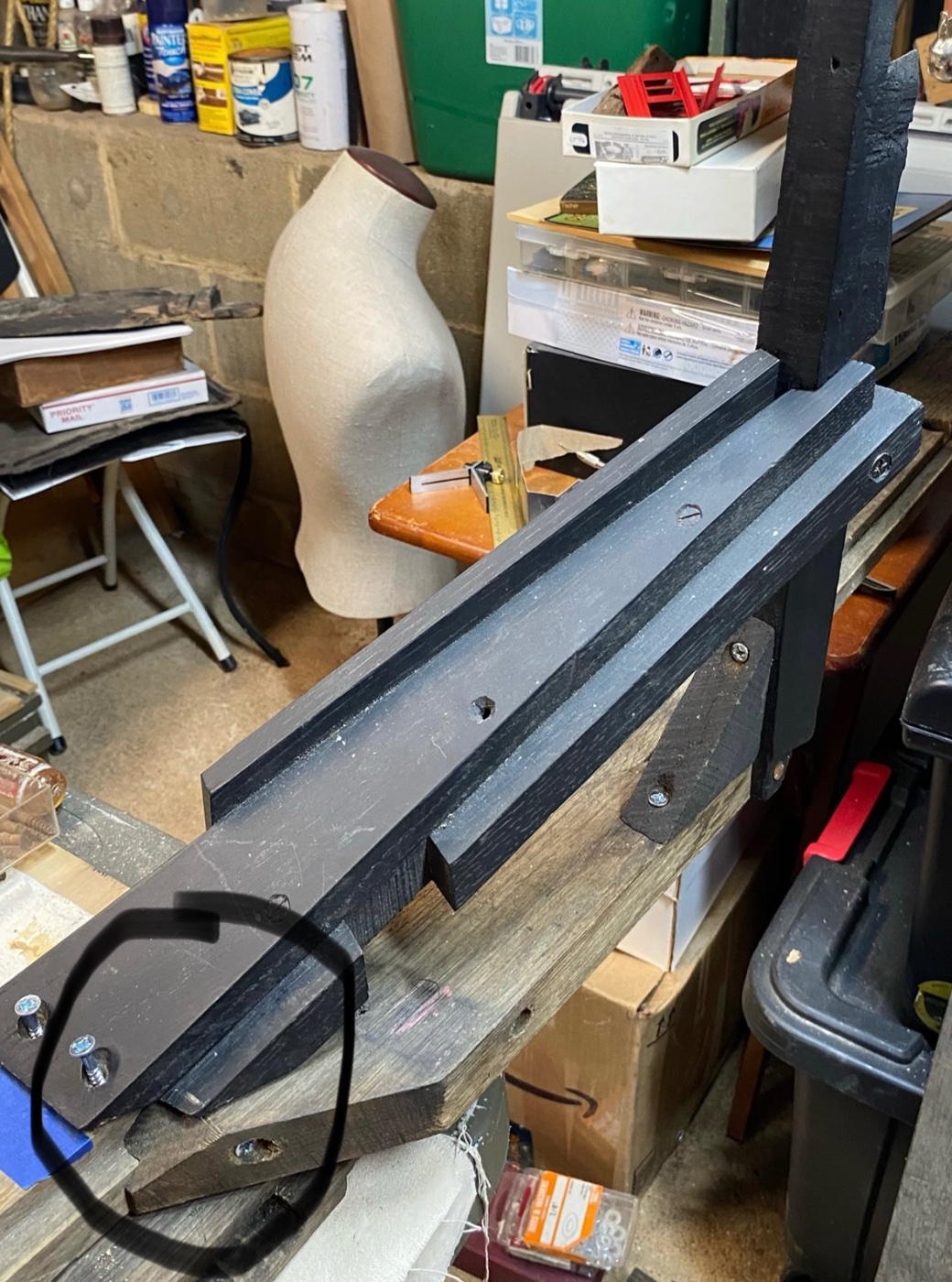

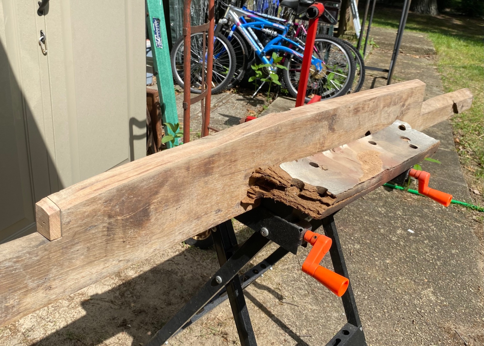

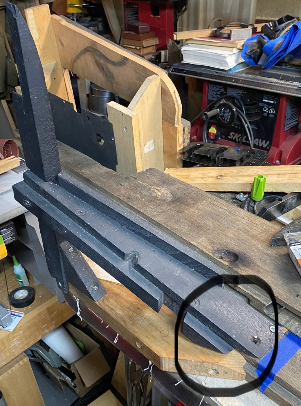

Gents and ladies, it has been a while. Progress has slowed down. But not stopped.

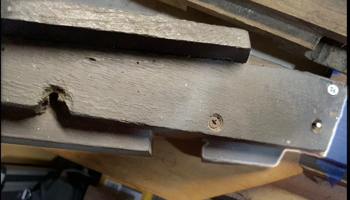

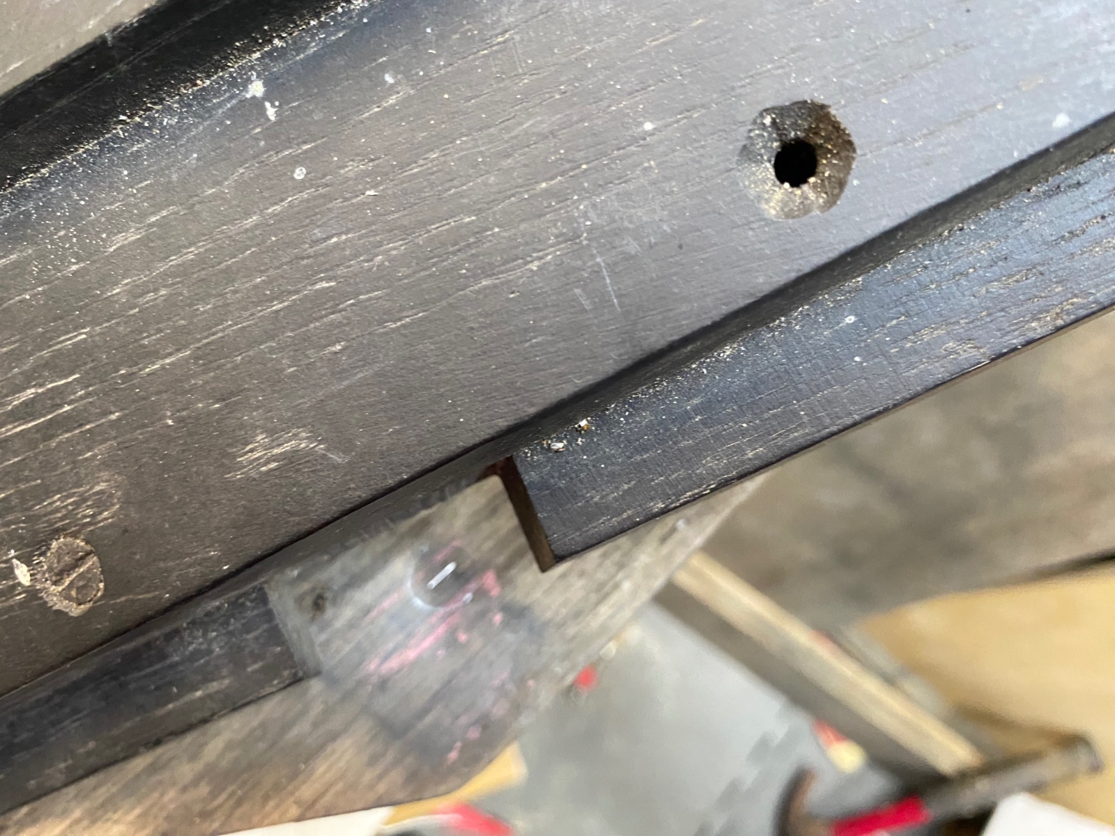

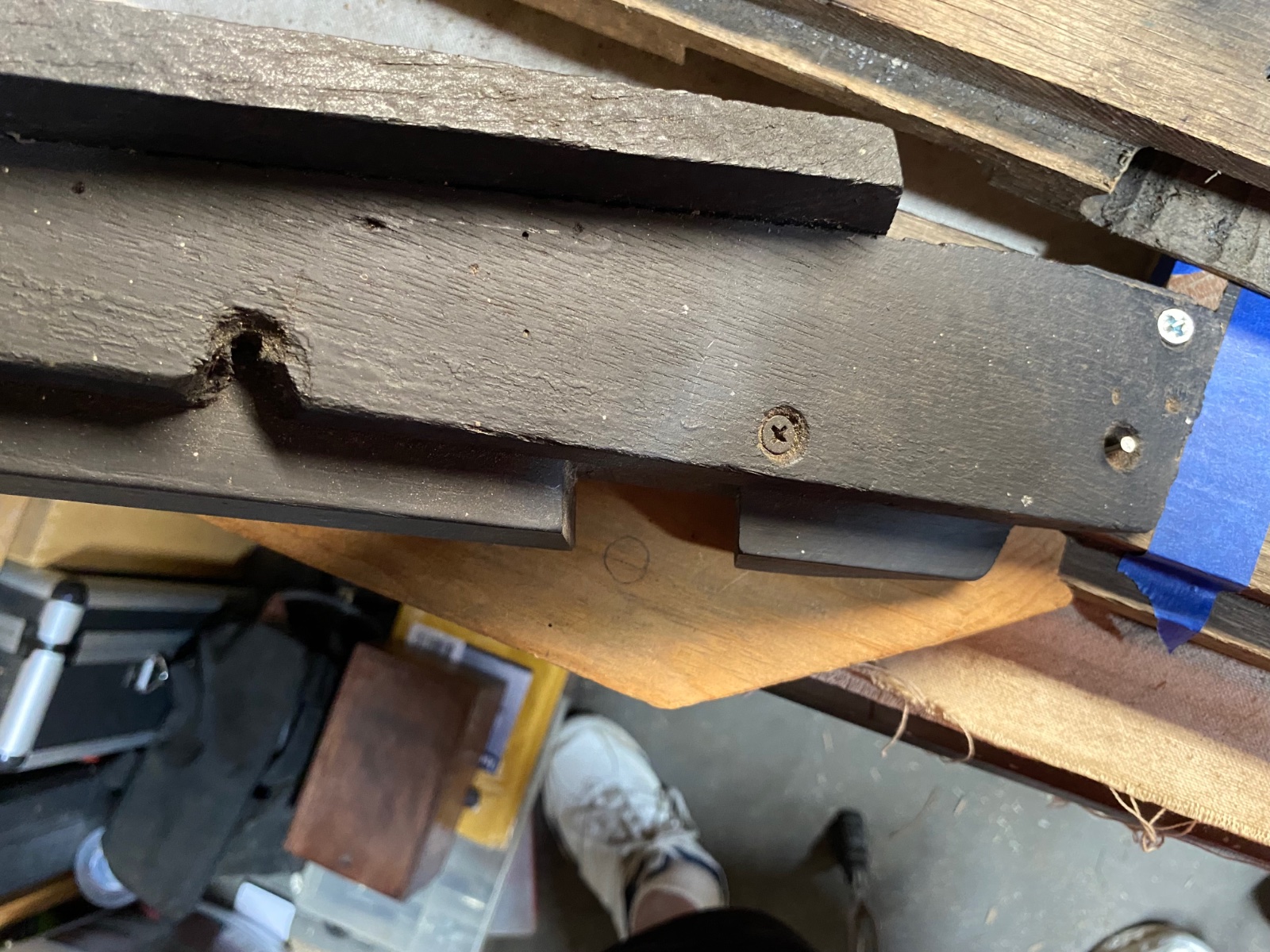

My biggest issue right now is the body sills. I’m attempting to reuse the ones a previous owner made. I do have wood to make new ones but that new wood is 1 and 3/8ths inches thick, which leaves me only 1/16th of an inch of playing room on either face. (1 and 1/4th inches final dimensions).
I’ve drawn a set of plans for new ones based on the original remaining pieces I have of the original sills. Discovered the re-made mounting holes are in the wrong places.
Presently trial fitting the cowl uprights for eventual final placement.
Here are some pics

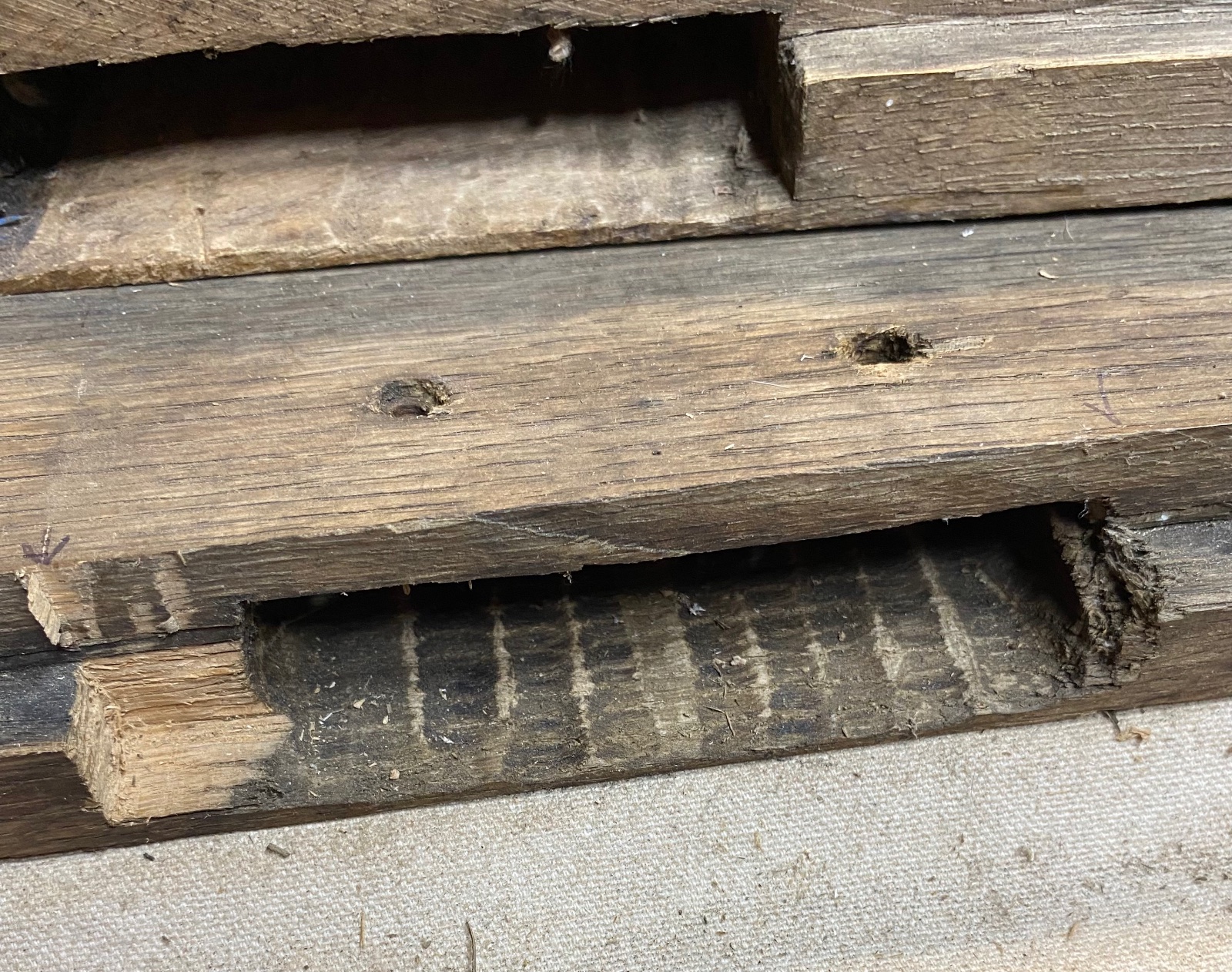

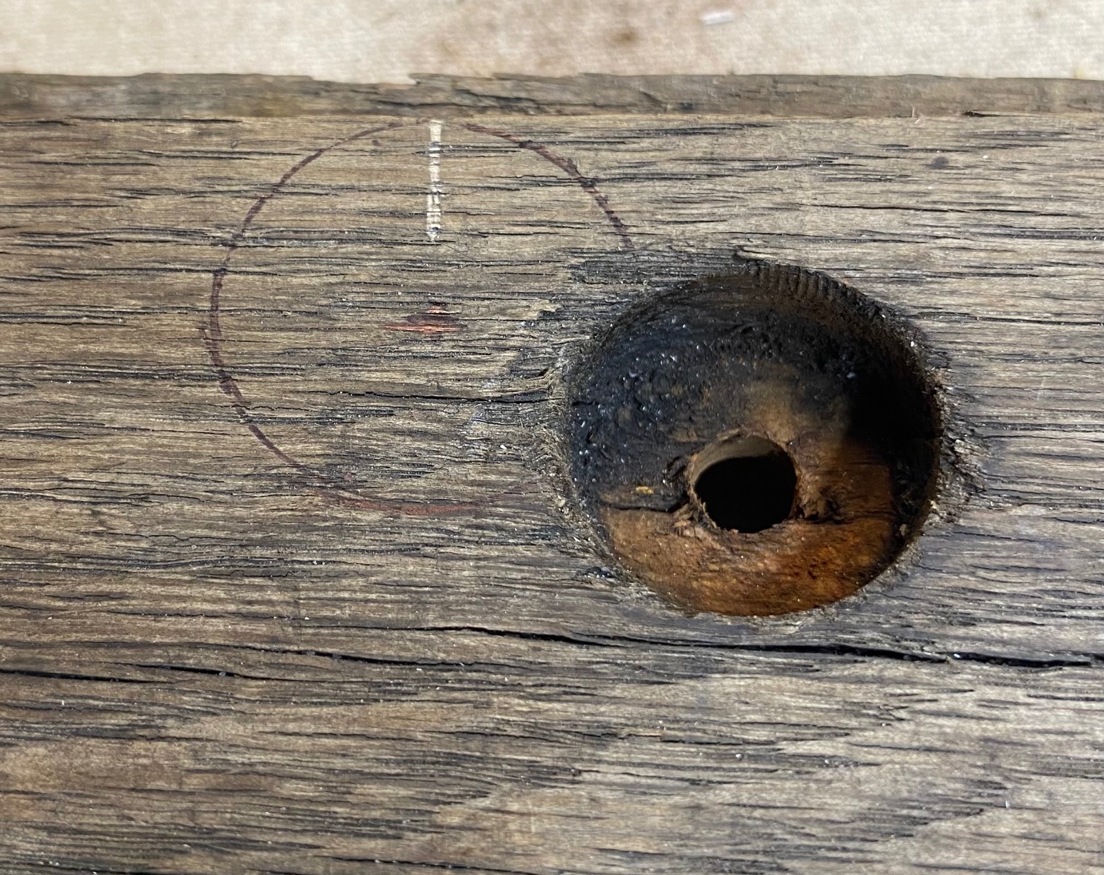

Some more pictures
More information can be found on my blog:
army30th.wixsite.com/centerdoor-ii

Yes, I reviewed the Fellin series. I only use it to see what he did. There’s a few things in it that I do not agree with. I’m attempting to do my wood as close to exact as the body builder did, since a majority of the wood still exists.
I’ve been in contact with several owners and have gotten measurements from their cars and have noticed the discrepancies you mentioned. One of my friends has one and I make regular trips to his place and measure/photo several alignment points since my body maker is the same as his.
The remade body sills, for example, have the front pillar notch 1 inch too long and I’ve had to correct that.
My touring was completely rewooded from a kit by me, assembling each side of the car as a subassembly and then attaching it to the frame.

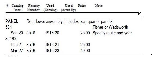

I looked at your blog, but I didn't see or I may have missed it, which of the two Center Door makers (Fisher or Wadsworth) produced your body? That is a question I've wondered about for years -- how do you tell which body maker produced the body? In Bruce's CD version under the Center Door body parts it has several parts listed as "specify make and year" as well some that said "Fisher or Wadsworth specify make and year" as shown for the 1916-1923 rear lower body panel:
Heading and Factory number etc Rear panel CD.JPG (25.25 KiB) Viewed 1446 times
Again you are doing great work!
