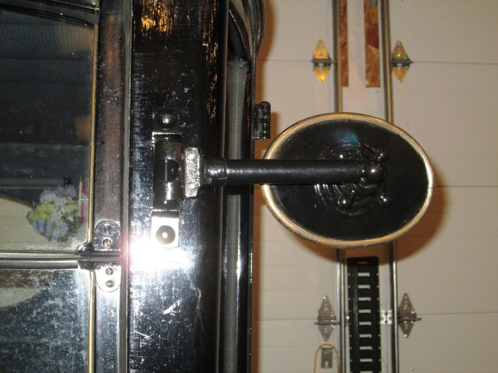

I have been studying on how best to mount a side mirror on my 22 Centerdoor. I have found a few pictures of mirrors screwed into the front pillar but I wonder if there are any other options.
Posts: 5433
Re: How best to mount a side mirror on a Center Door
Post by RajoRacer » Sat Aug 31, 2024 11:03 am
Most mirror mounts for closed cars of the "era" used what looks like a toilet paper roll holder & utilizing the common open car mirror - I fabricated this mount.
