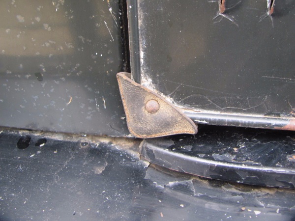

The late Improved Car used these pads, factory. You can tell if your late T was installed at the factory as you will find tiny hole at the edge of the hood.
Here is original remains of a factory pad. Think these were late 1926 addition, when the Improved Car got the change to Vaproizer carb, and later with the nickel head bolts....all this 'fancy' stuff that Edsel saw done, as he was practicing for the designs of the NEW Ford to come. ;)
Hood Pad.jpg (120.78 KiB) Viewed 7085 times

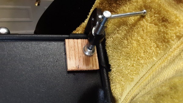

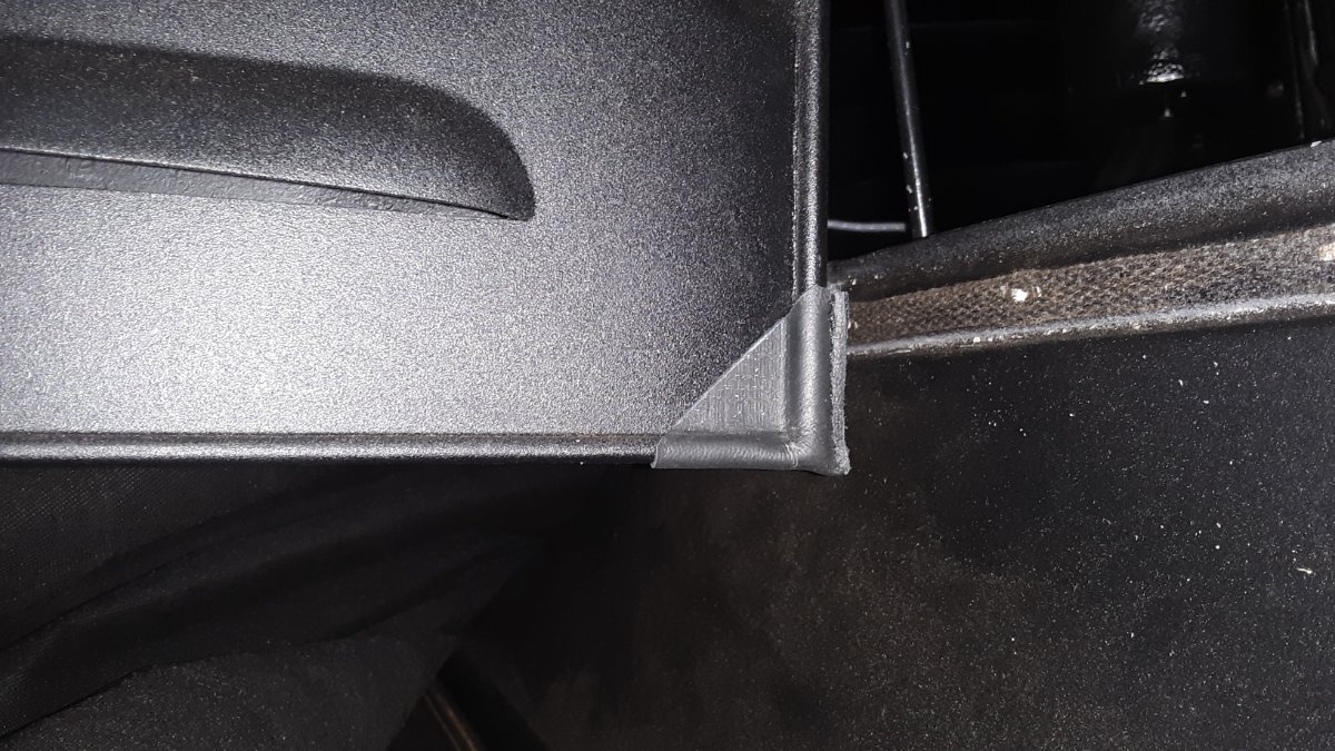

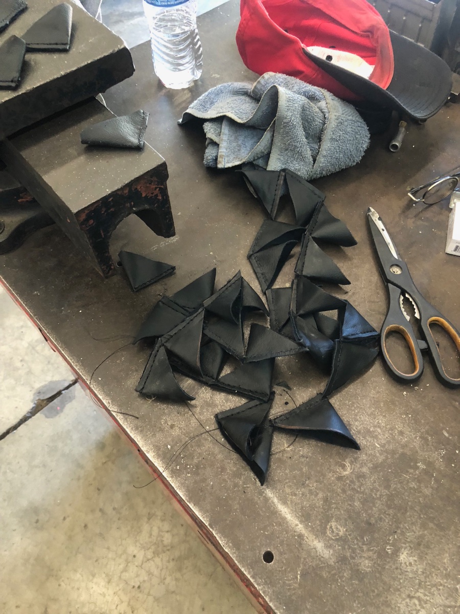

Sometimes making your own from scraps of black leather with a simple single stitch is a better alternative. Soak in water for a couple of hours, using a c-clamp with small pieces of wood and wax paper, clamp in place and let sit for a day. Remove and let dry, then reinstall with a little black weatherstripping adhesive. Looks Good!

Very nice!

Hank, How did you get that corner pad to mold to the hood?

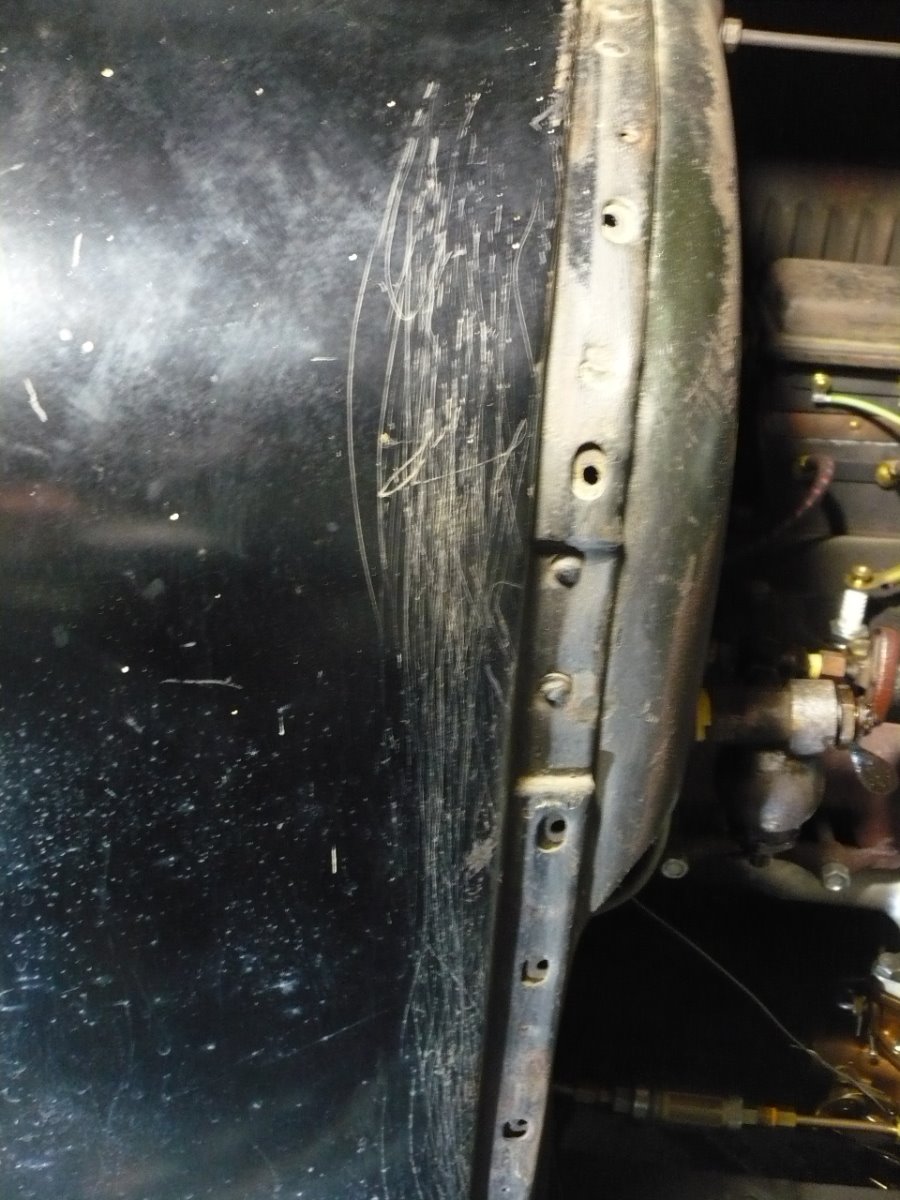

They would come in handy to prevent this.

Richard, read what he wrote it explains how he had them formed to the hood

Doug. The directions make no sense to me either. Soak in water with c clamp, bits of wood, and wax paper. Apply with a little bit of adhesive. I dont see how that would make them look as good as they do. Hank did a great job.

Soak in water for about 4 hours clamp them while they're still wet, let them dry in clamped position, remove and use weathestrip adhesive to apply them to the hood
