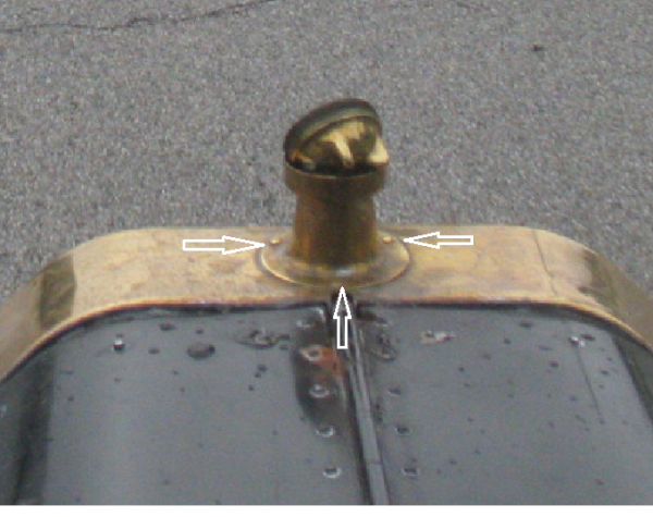

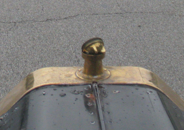

- Posts: 6451
Re: Brassworks "Low" radiator
Did you notice the rivets on the base of the water neck. That should keep a soldered one from working loose
- Posts: 1909
- Last Name: Tannehill
- Location: Hot Coffee, MS
Tim you have a black T correct? This would mean you have a shroud covering your radiator so the combination of silver solder & rivets most likely will not be seen because of the shroud.
Sounds like that would be the solution if the radiator neck that is pictured is the style you have. Use a quality flux on a clean surface, rivet in place and solder, the flux will pull the silver solder in. You’ll only be heating the flange so wrapping the a wet cloth around the neck will help as a heat sink & prevent you changing the polished finish.
