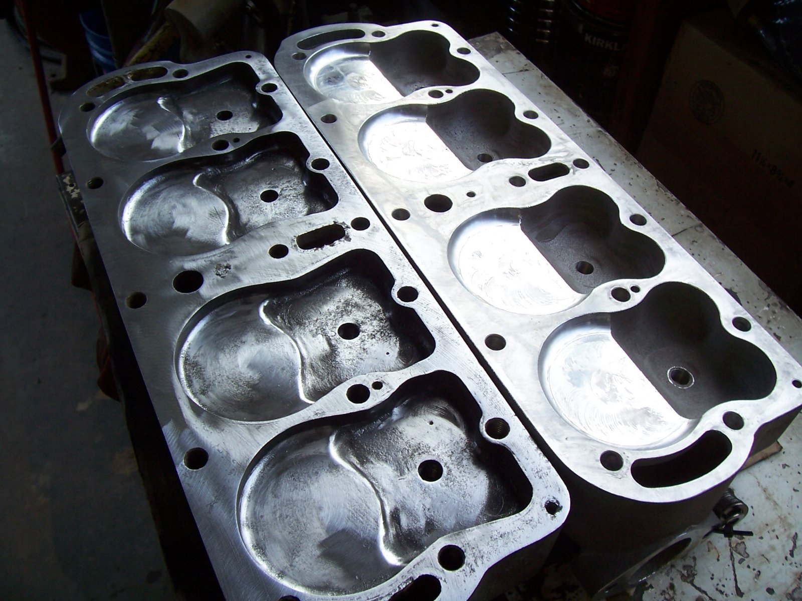

I'm running two Prus heads and the quality is top notch. I average 80 psi on both. These cars pull hills very well which is why I put them on. Here is a comparison of a Prus and a Sherman Spit Fire head. Prus is the new looking one.

The Prus head looks like the pockets over the valves are deeper than the Sherman, which might give better breathing at higher RPM. The Sherman might make better torque at lower RPM. The head, carb, intake manifold, cam profile, and exhaust will all affect performance.
I believe that a Ricardo-type head like the Pruss or Sherman or the Z on an otherwise stock T engine will give the best bang for the buck.
