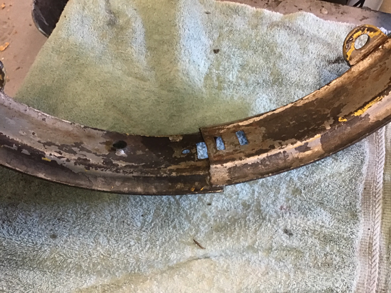

A local resident inherited a model t truck that had a flat. Tire. The local tire shop would,t touch it and was referred to me. I had experience with split rims on a roadster that I had and unowned that their is a way to lock the rim after putting tire on. This rim had no way to lock it and I am asking if anyone has a photo of what locking mechanism looks like.

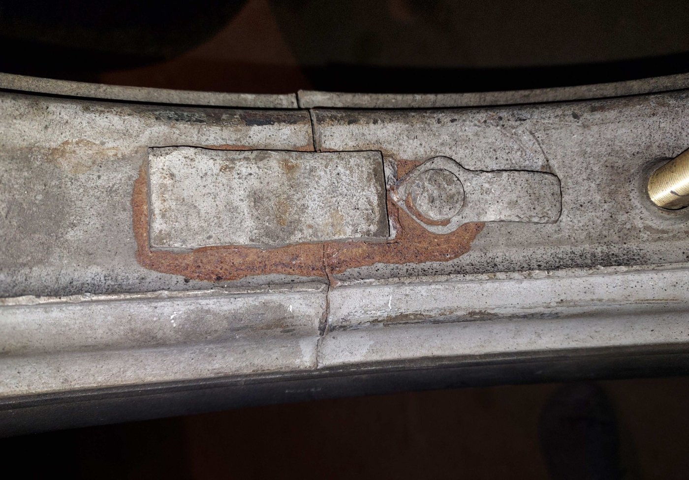

There is a tab that is welded into one of those slots it has a step in it that fits into the slot near that small hole, in that small hole is a rivet that holds a funny looking moveable tab that swings over to keep the strap, rectangular, piece in place. Thus, locking the rim. Hope this helps, I haven't any pics just now. Wingnut
- Posts: 6581
Re: Truck tire rim locking mechanism
Is this what your are describing. Also George better read ALL of this because of inherent danger https://www.mtfca.com/discus/messages/5 ... 1475385715Wingnut wrote: ↑Sun Oct 06, 2024 12:39 pmThere is a tab that is welded into one of those slots it has a step in it that fits into the slot near that small hole, in that small hole is a rivet that holds a funny looking moveable tab that swings over to keep the strap, rectangular, piece in place. Thus, locking the rim. Hope this helps, I haven't any pics just now. Wingnut

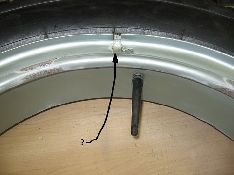

Justin H. - Western PA on Monday, September 26, 2016 - 03:39 pm:
That notch is each end of a ring that fits into a groove on the outer edge of the rim. The ring must be removed with tire irons which will allow the tire to be removed. I highly recommend that you take it to a tire shop that specializes in heavy truck tires to have the work done. An improperly mounted ring can fly off during inflation and mame or kill any living thing in its path.

Its not a rear "truck" rim. Its a 21" split rim, missing all the latch mechanism as wingnut described.

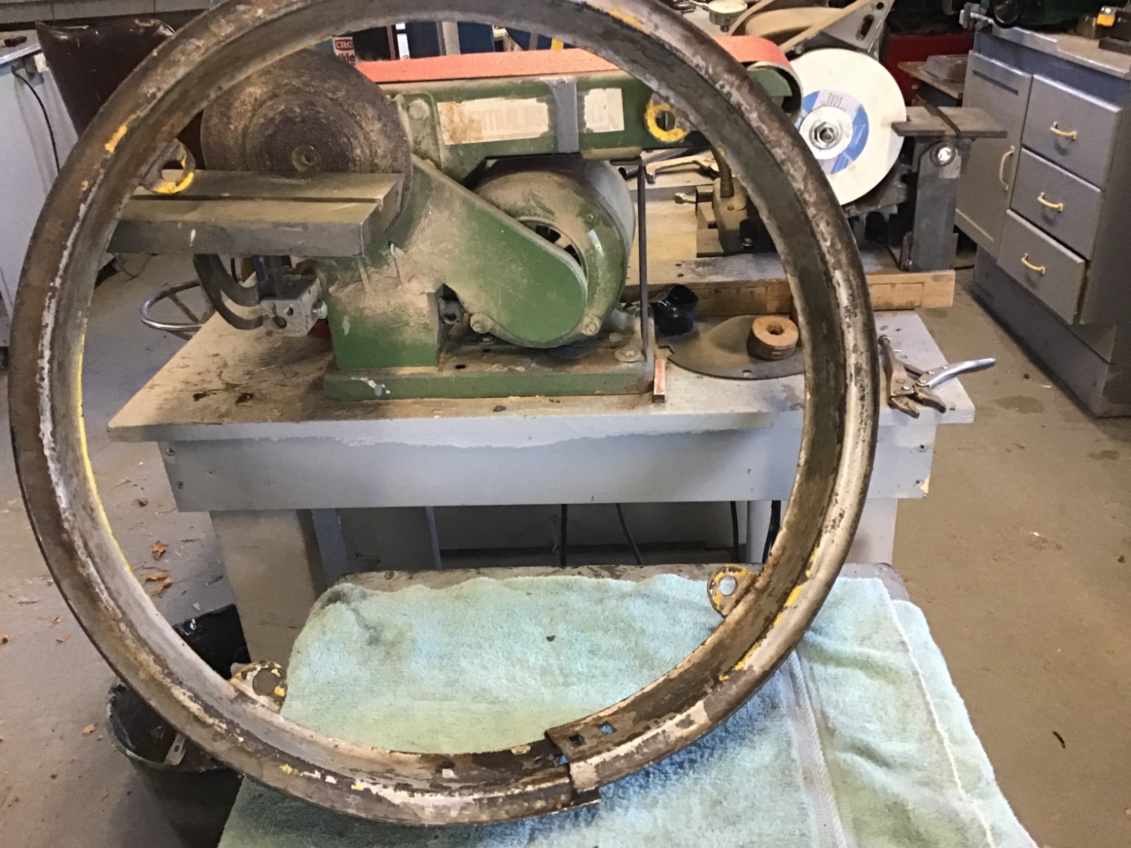

John is right. Here is what it should look like.
