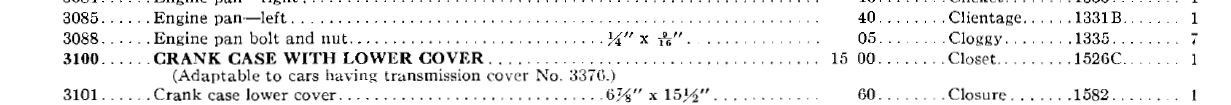

From the 1912 catalog:
1/4" x 9/16" quantity: 7

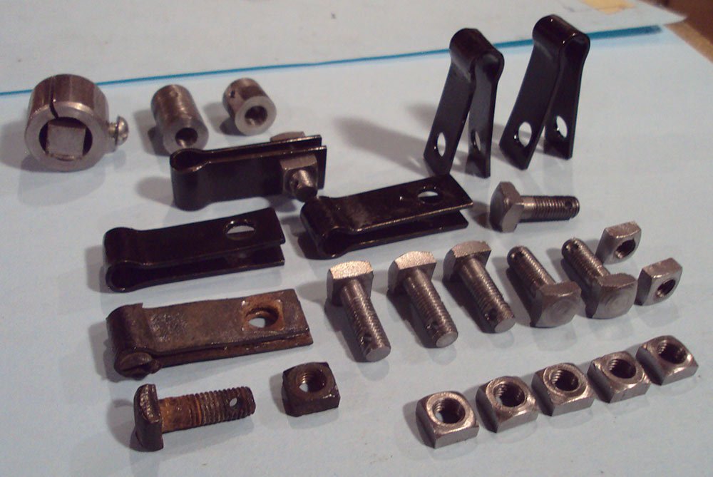

Here are some that I believe Richard Eagle made:

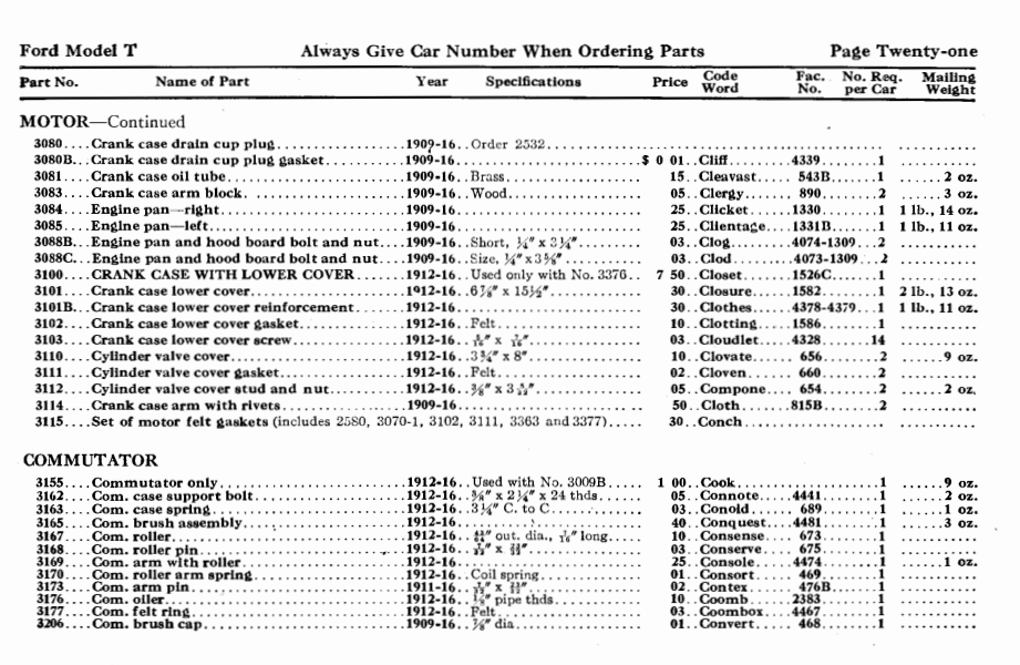

Here is from the 1916 catalog:
3088B 1/4" x 3-1/4" quantity: 2
3088C 1/4" x 3-5/8" quantity: 2
