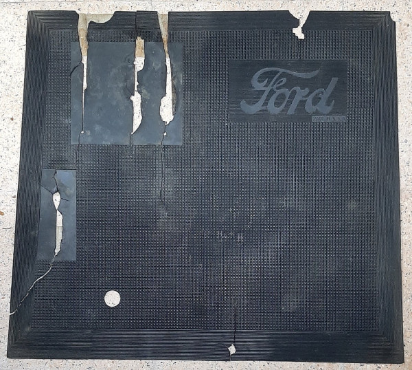

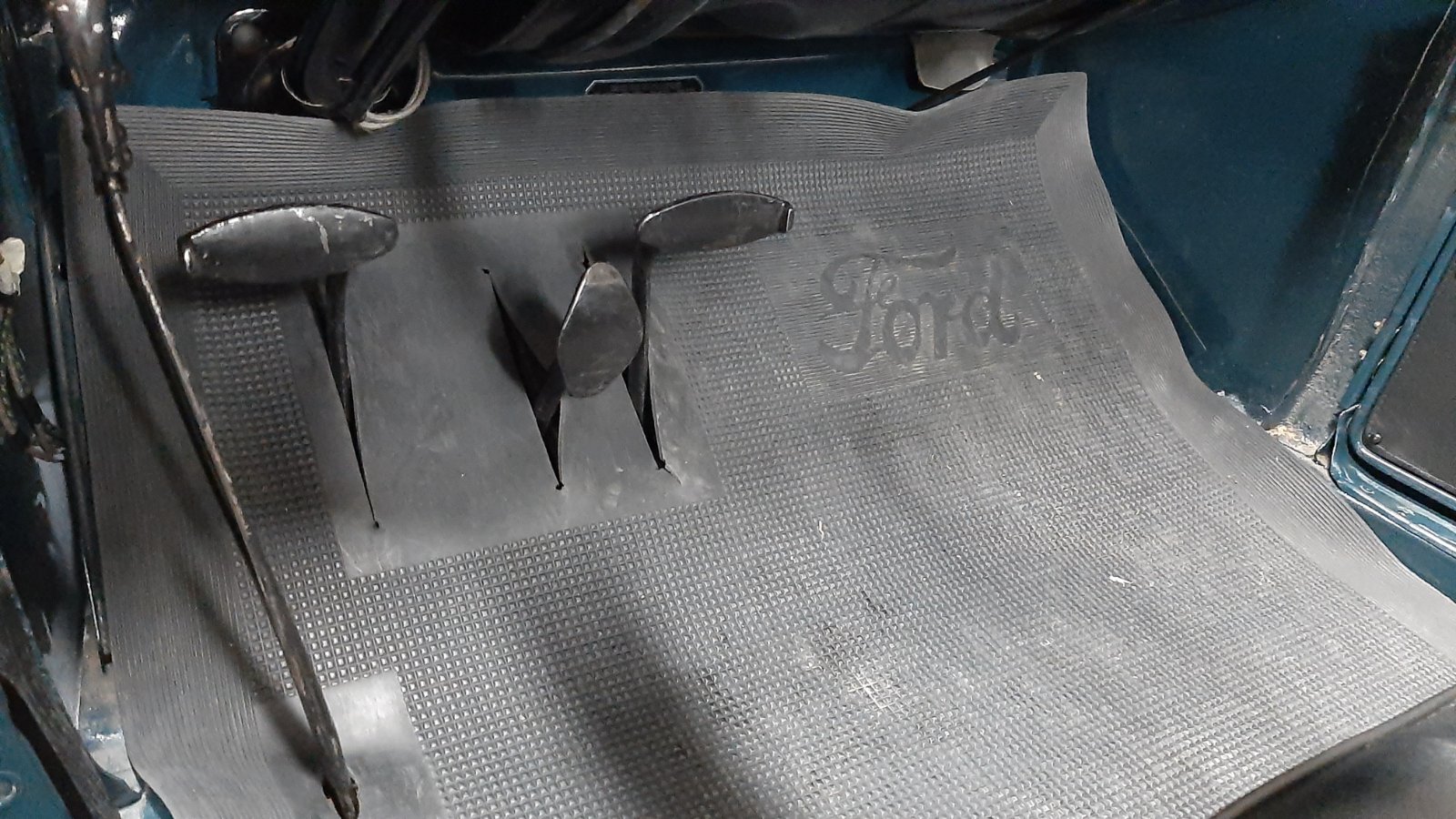

I bought a new floor mat 8 years ago and with great difficulty installed it last week, tearing the brake pedal slot in the process.
The old mat was already quite torn, making it easy to install and remove.
The new mat is covered in a black sort of dust or mold release agent which stains anything touching it. I want to remove the mat to clean it but am afraid of ruining it while pulling it around the pedals. Any tips or tricks for installing/removing the reproduction floor mats over the improved car clutch and brake extensions?Thanks

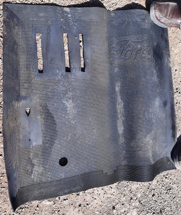

I have some self-designed items on my car but I enjoy having it as close to factory equipped as possible.
I saw this mat on the Forum and it has cut-outs for the pedals, so I was thinking about doing the same if it helps to fit it over the pedals. Not sure if it would really help or not.

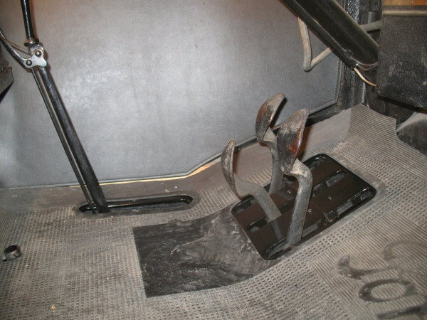

Don't you have the metal trim for the lever and the pedals?
My mat is in a 1923, but I'd be surprised if the same thing isn't available for 25-27.
https://dauntlessgeezer.com/DG114.html

Another thing to keep in mind is that the pedals move sideways when you push them. The clutch moves to the right and the brake and low move to the left. So while the mat is still on, you should trim out enough from the slot where the pedal moves so that the pedal does not stick when you push it in which will keep it from coming back when you take off your foot. Once you get this trimmed right the slots will be a bit wider and it will be easier to remove the mat.

Steve, I've never seen a trim plate like yours. That would probably solve my installation problems.

Steve - the metal trim for the pedals and lever is supposed to go under the rubber mat and attached directly to the wood floorboards.

Yes, that's why most mats have a square cutout to go around the pedals.

Steve, your metal plate around the pedals is so nice and shiny I mistook it for an accessory plate fitting over the mat. After closer inspection I see that the older mats are cut out around the pedals. Looks like Ford wanted to make the interior more weather proof and made the pedals fit through slits to keep some of the air from coming in.
