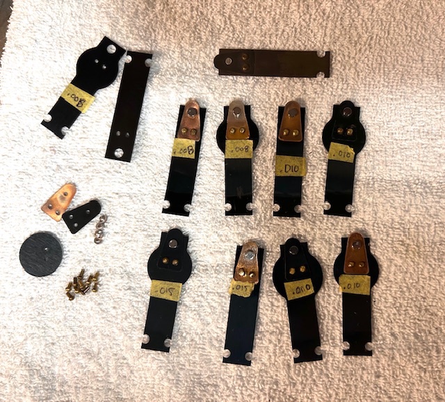

So thought about it, and made several different points of different thickness and shapes. Ended up making up about 10 different prototypes until I found the winning combination.

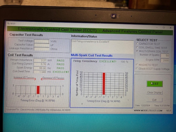

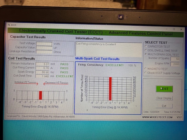

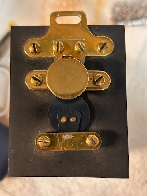

The newly designed points are rock solid, and the best part they have double the output on running the same coil with the current point offering and set at the same amp draw on the HCCT.
I found the current point set around .8-1 A on the HCCT had an output of only 20-22mJ, very short dwell time and timing was drifting quite a bit. Set them for a higher output around where KW’s are 45-60mJ and they would not fire on the HCCT and would not idle.
My new points are the best of both worlds. They run around 1A on the HCCT and fire super consistent on the ECCT with an output of 55-60mJ. They actually rival KW’s.

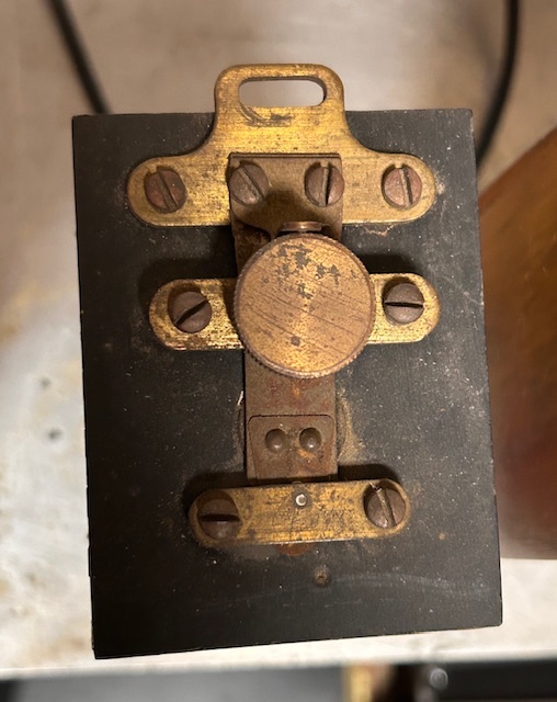

I attached a few photos of some of the prototypes and new design as well as the original.
