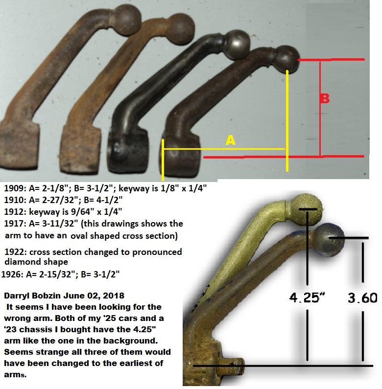

I am wondering if Ford made different length pitman arms. I am working on a speedster, and have run into a problem with the length of the pitman arm that is on car now.
Fitz

Re: Pitman arm
Post by ModelTWoods » Wed Jan 08, 2025 9:33 am
Yes they did,and they may have made some with other differences other than length or part number. For instance because of a 26-27 chassis having a lower stance than previous models, the pitman arm was slightly different.

Re: Pitman arm
Post by John kuehn » Wed Jan 08, 2025 10:20 am
Check out this earlier post for the differences. https://www.mtfca.com/discus/messages/4 ... 1402824133

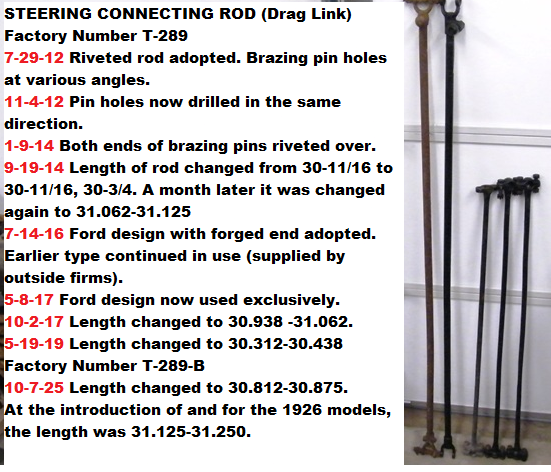

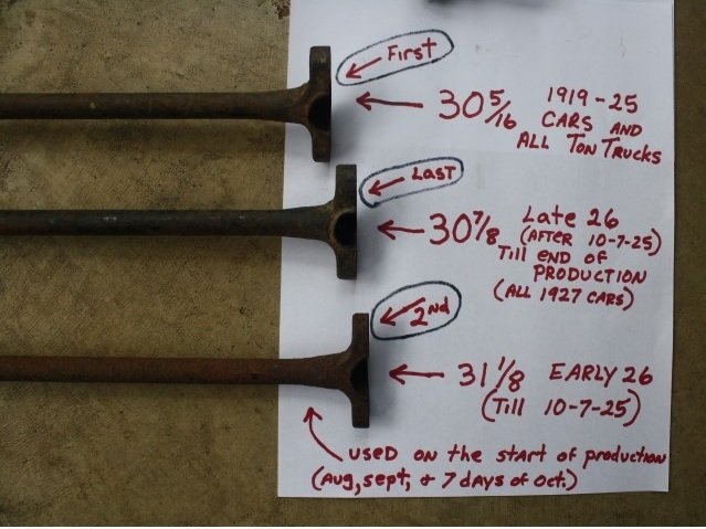

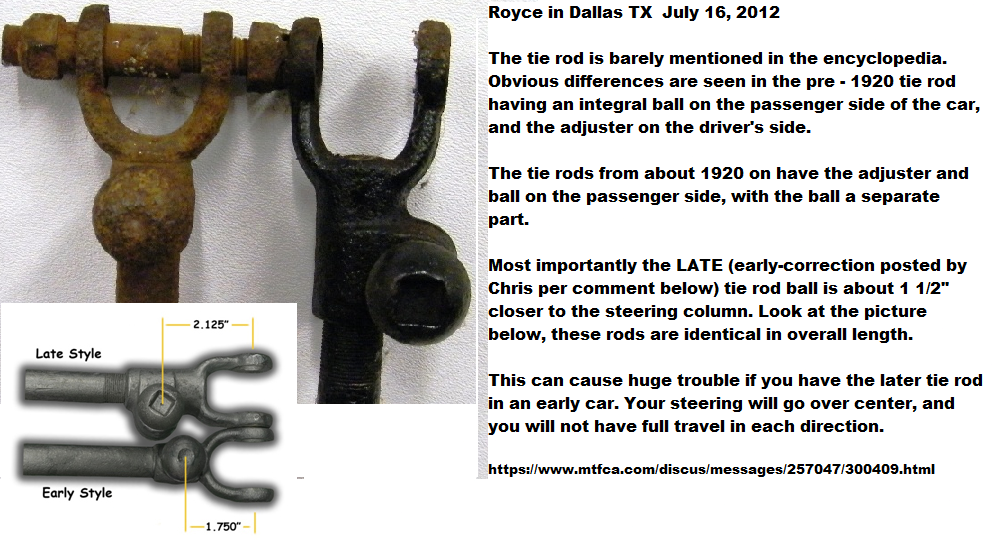

Post by TRDxB2 » Wed Jan 08, 2025 10:24 am
Different front end pieces
Steering Change Details.jpg (108.25 KiB) Viewed 4188 times
Drag link.png (162.93 KiB) Viewed 4188 times

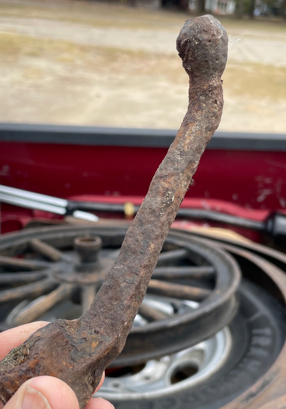

Post by Original Smith » Wed Jan 08, 2025 11:13 am
I always mike the ball. Some of them are quite worn.
Posts: 4081
Re: Pitman arm
Post by DanTreace » Wed Jan 08, 2025 5:47 pm
No need to mike this T-3547 Steering Gear Ball Arm :?
