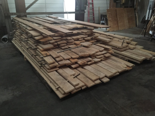

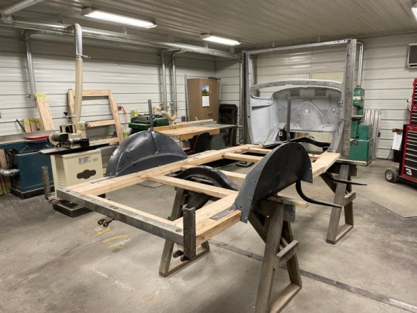

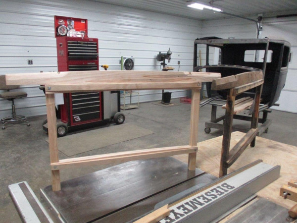

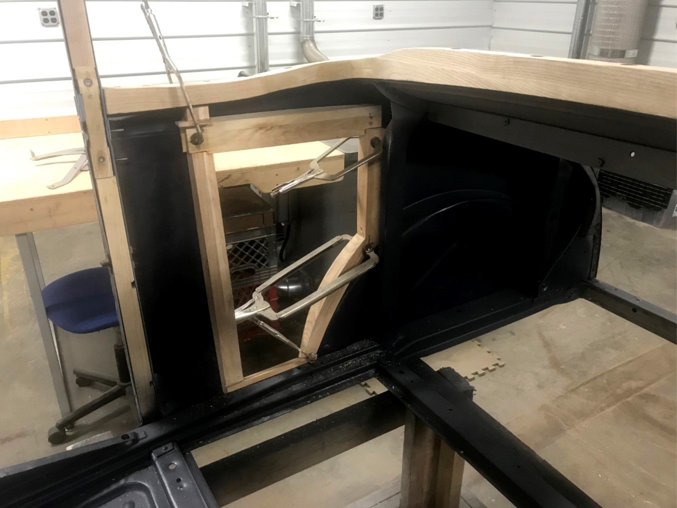

Mike, I own a restoration shop that also includes a wood shop (pix below) where we cut & fabricate wood infrastructure for bodies. On vehicles we do not have patterns for, sometimes we use original wood as our sample. Sometimes we use body filler to make our sample. I can expound on that if that is an option for you that you are unfamiliar with. In your case without much original wood to sample from, have you considered purchasing a complete body wood kit to use as your sample, -and then once you have patterned or replicated all of the wood pieces you need, then sell your kit used for patterning to offset the initial costs of the kit?

Thanks Mike. Most of my research at Benson has been for Model-A pieces. I probably now have over 1,000 prints of wood for different bodystyles from them, however the difficulty in researching those items is you must find the Assembly drawing first to find the individual component part numbers that makes up the piece.
As far as the body filler (Bondo) trick is using an open-car door for example, we use the door as the mould and spray Silicone on the inside of the door. We use Play Dough to build a dam to form the edges. Then apply the filler into the inside of the door around the flanged edges to define the curvature and dimensions. Sometimes we make our patterns in two or three separate pieces and we just assemble them after they have been removed. This gives us something to trace directly onto the wood, -or onto MDF to make a blank with. We also use body filler to add to sections of deteriorated wood. We first add TotalBoat's penetrating sealer to harden the existing wood and then apply filler to the exterior to add onto the length or into voids.

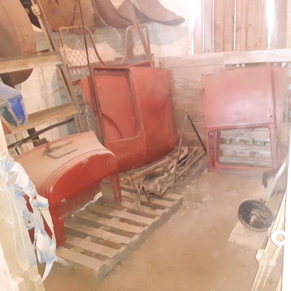

Yes, I have had this project for 5 or 6 years now and have searched for how it was done on several occasions over the years. There is a lot of great documentation with dimensions on the 26-27 coupe along with pictures on various forum posts. There are a lot of pictures of the Tudor roof but dimensions are not there. The Tudor roof is just a stretched version of the Coupe roof. All this can be used to make a reasonable copy of a Tudor roof with some thought. I like to make things as accurate as possible plus it would make things easier and faster. There are several 26-27 Tudors not real far away but they are all assembled and complete so I can not take them apart.
Health issues changed my finances and made it very difficult to tolerate getting cold or wet so I need to get one of my closed cars going to continue to enjoy the cars in less than perfect weather.
Maybe this is just an exercise with no results but I am going to try.
Enclosed is a picture of what I am starting with, a pile of parts in the corner of the barn.
