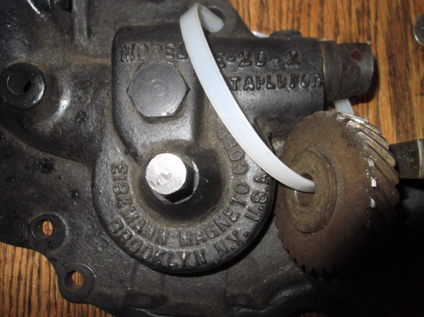

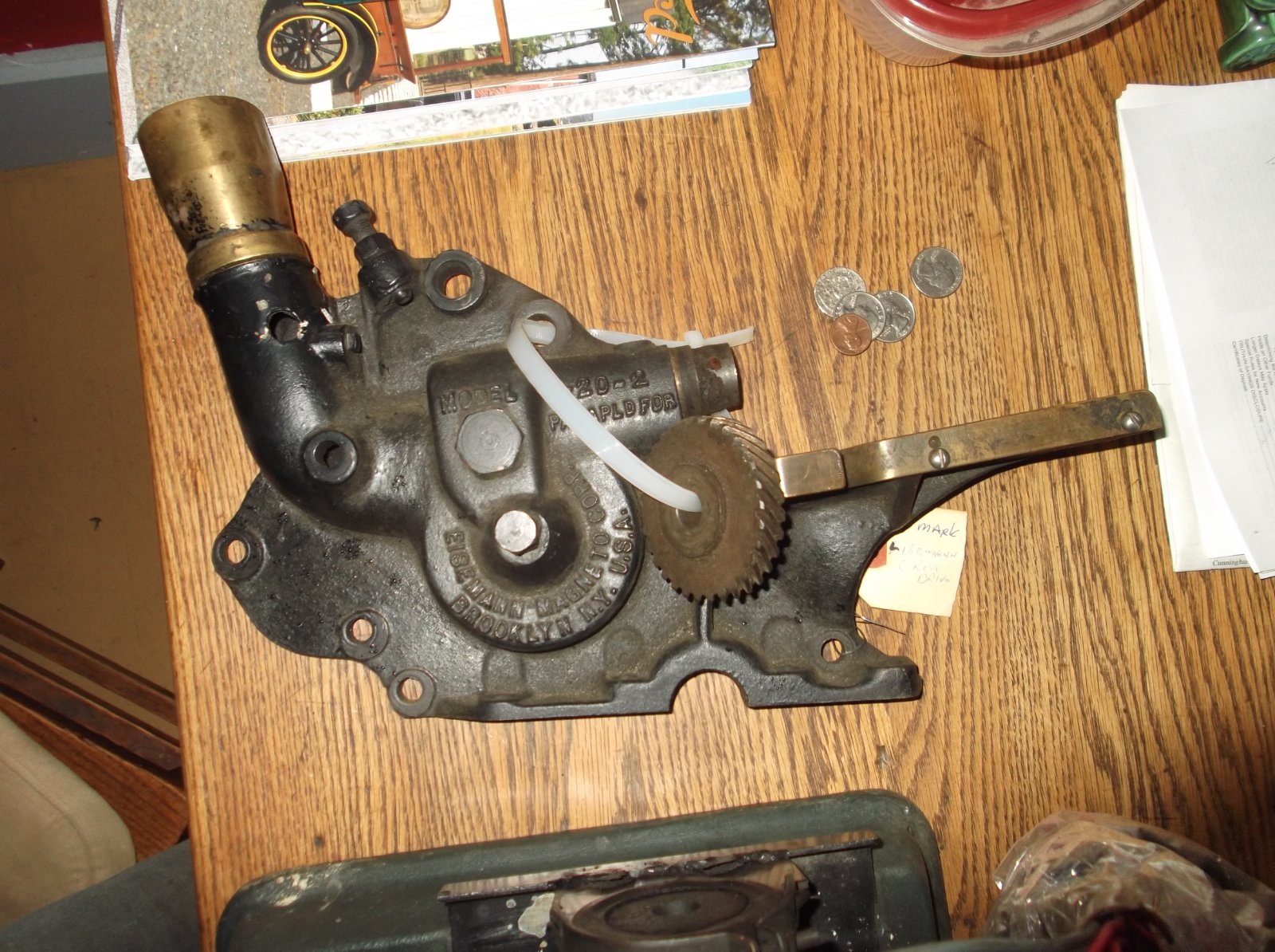

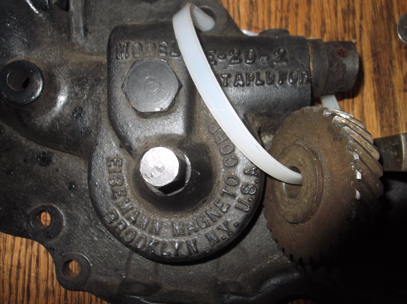

I will be reinstalling my Chevrolet overhead conversion which because of small water passages between the block and head need a water pump to help move the water but will not be able to use the bock mounted pump if I use the cross-drive magneto setup I just got.
Does anyone make a 6-volt pusher pump that would mount it the lower water hose? I have seen 12-volt ones. I would consider using a side drive but there is no room on the other side to mount an alternator.

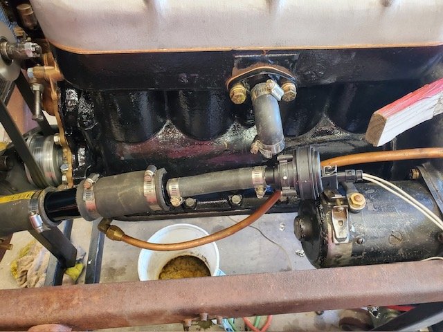

Craig, thanks. That is helpful. The water inlet is in the same location as stock. When I was running before, I did use a pump and also added a 1/2 pipe off the water pump to the back of the head to help push water through the head. Never did any extensive testing but seem to run/cool fine.
