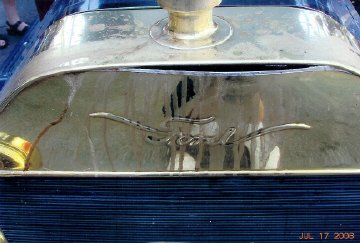

“About the level of the Ford name on the radiator”.
Always been confused by this statement. Bottom, middle or top of the Ford script?

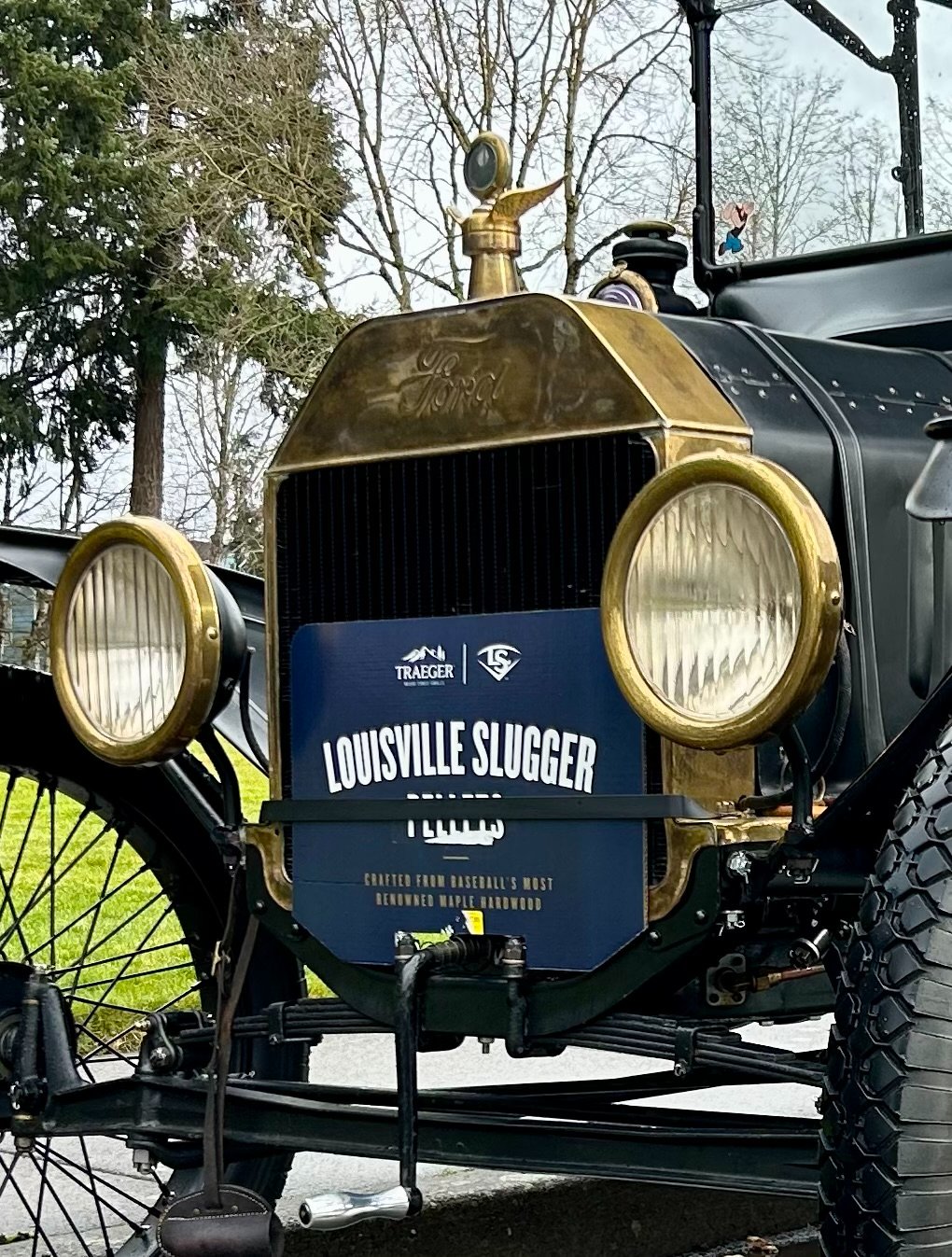

I want anyone trying to drive in the cold to know that the vintage style cardboard "winter front" cover made a remarkable difference in bringing the engine up to temp. Without it the fan was blowing harsh, wintery cold air into the engine and it ran terrible. I didn't have a vintage one, but I thought the "Louisville Slugger" slogan was pretty cool.
Chris.

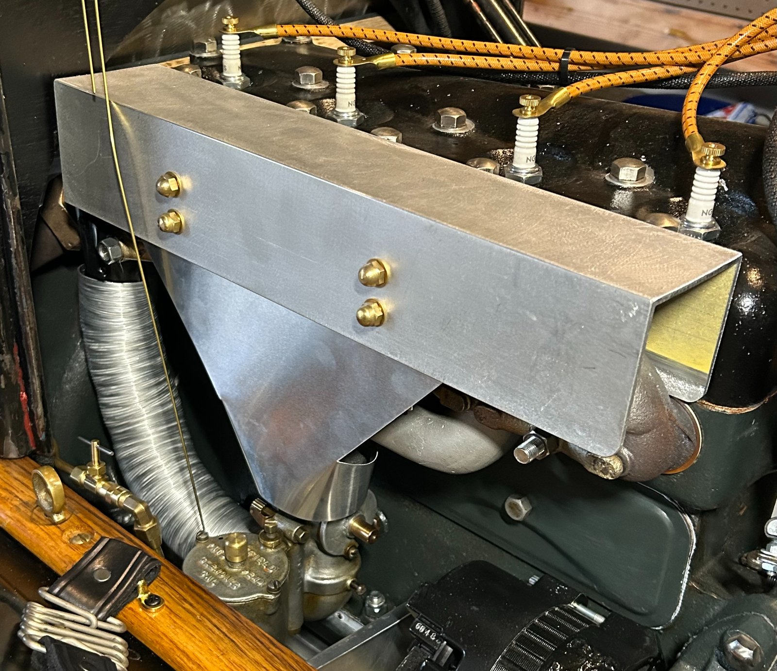

Steve, thanks for mentioning that. Yes, I started with a heat pipe. Then I fabricated what I call a "heat collector" to help and to protect the intake manifold from the icy air that was being blown through the engine compartment. I was getting condensation just above the carb.
I have an intermediately built engine and run a Winfield V4 carb, with water pump and now a 180 deg thermostat. I know all the "stock" guys will shudder, but I've already had and experienced a stock car (1921 touring - very fun and nice). But I have worked very hard on this little roadster and have made suspension improvements, upgraded to wire wheels, and added other things like the '14 rear fenders to make it look and be what I wanted.

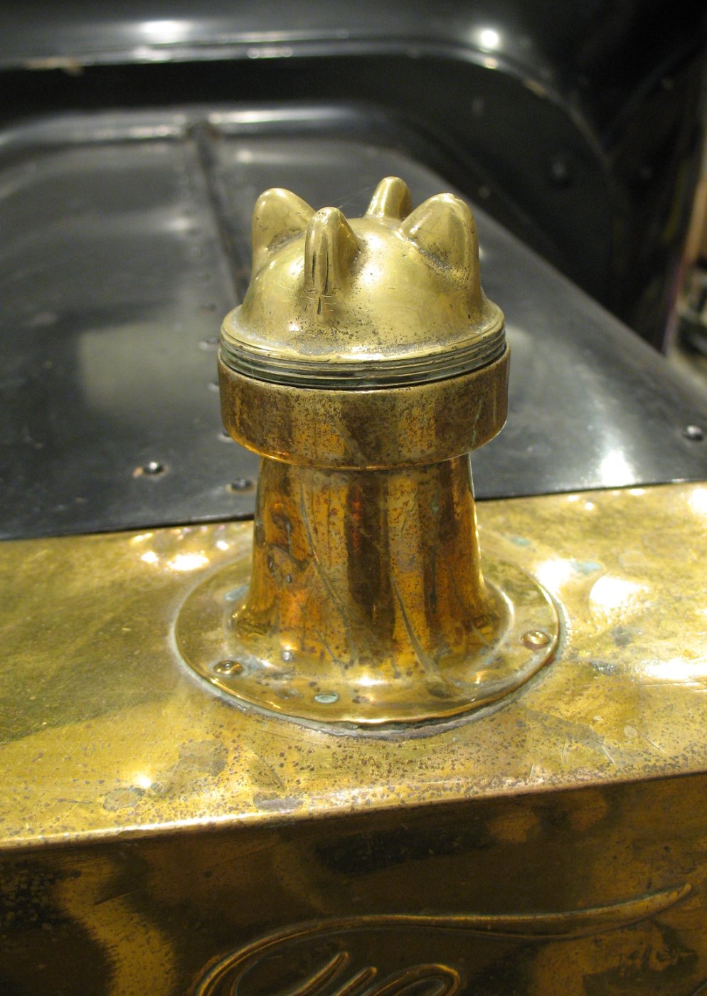

I drive on country roads a lot. They are not always smooth. Not wanting extra weight bouncing on top of my radiator neck, I use this. It works for me.

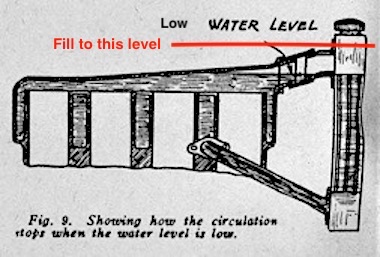

A Moto-Meter reads the temperature of the water VAPOR in the radiator. The end of temperature probe is in the upper potion of the filler neck. You need to consider the affect of the wings in cooling the area being read and if you are using antifreeze.
The most efficient engine operating temperature has been noted as 180-190 degrees Fahrenheit

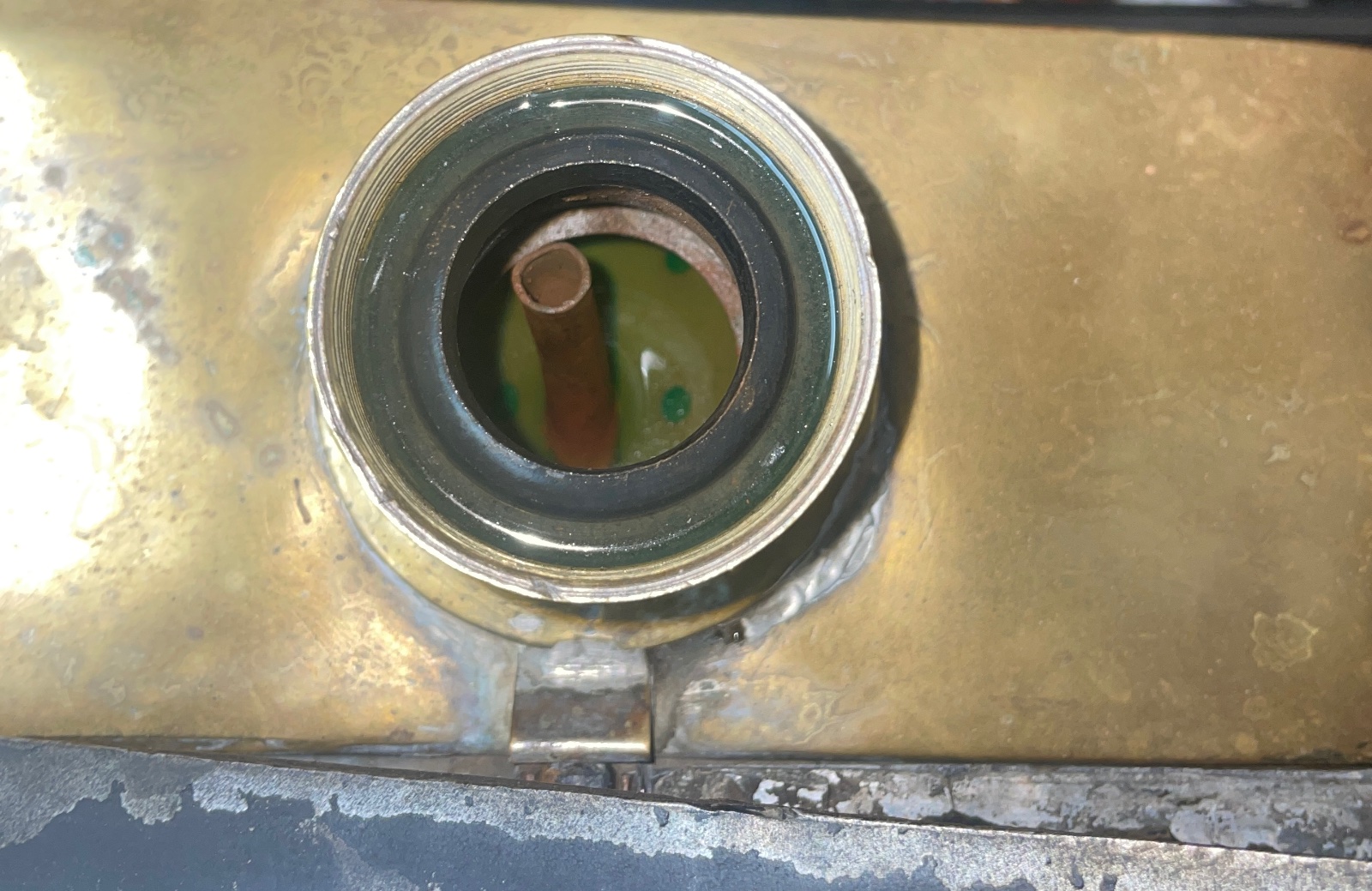

If you fill the radiator full for a hot day tour, and the overflow is even a little bit plugged.
The radiator will look like this of the air temperature is 98 degrees.

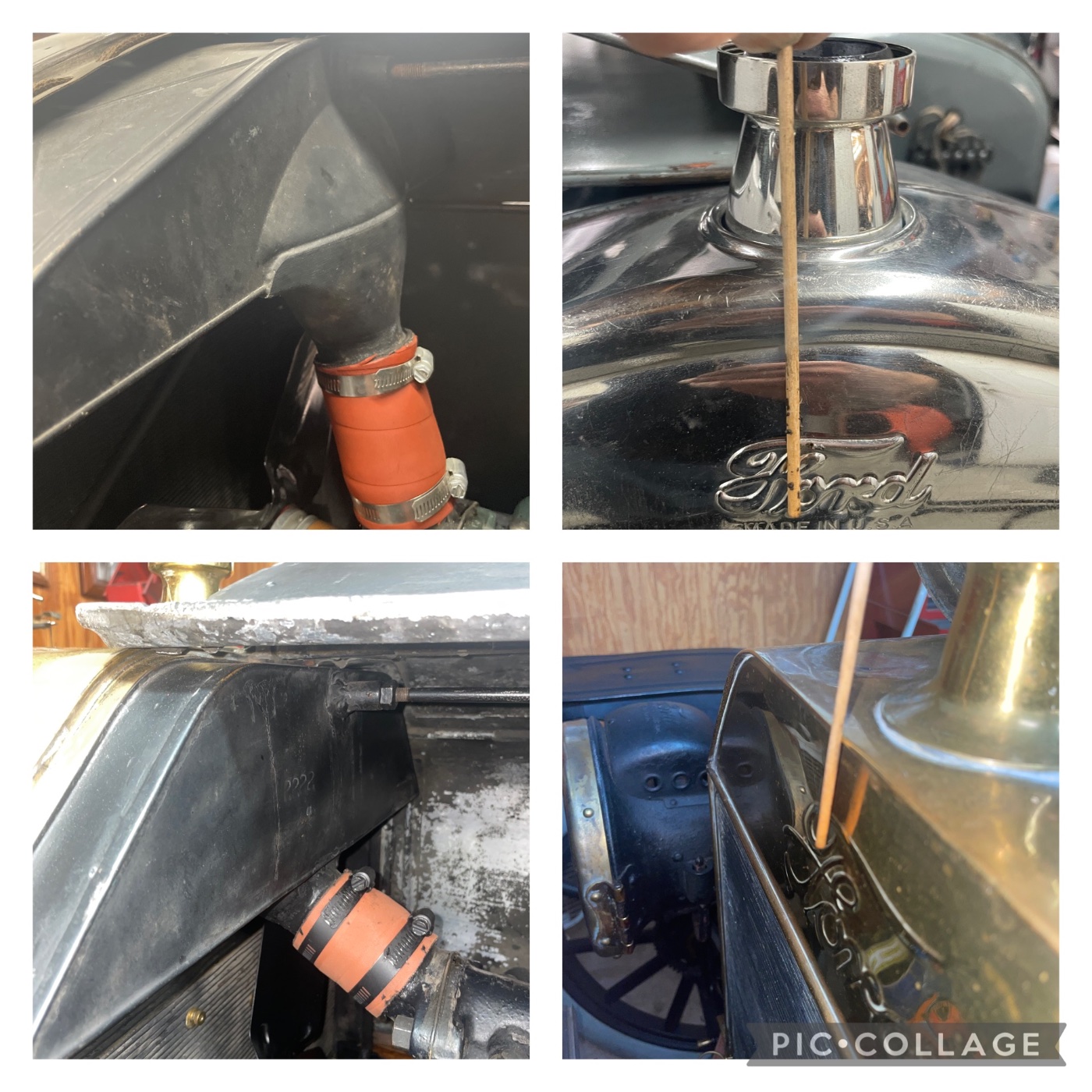

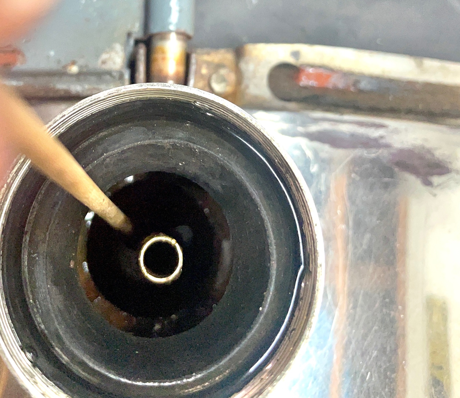

To again answer the question “About the level of the Ford name on the radiator” did a measure in the garage just now on two Ts, high radiator and brass radiator.
For FL, the coolant level best is above the core, and above the splash plate a bit.
So used a stick placed in the radiator, down to the top surface of the coolant, and used the very TOP RIM of the radiator neck as the measuring point.
High radiator Brass radiator
Removed the measure stick from each, and then laid the stick over the face of the radiator, again the end of the stick at the top rim of the neck. Both laid right across the Ford Script, so that is the answer to the question. If you do fill a little more above the splash plate, the excess will be barfed out.
